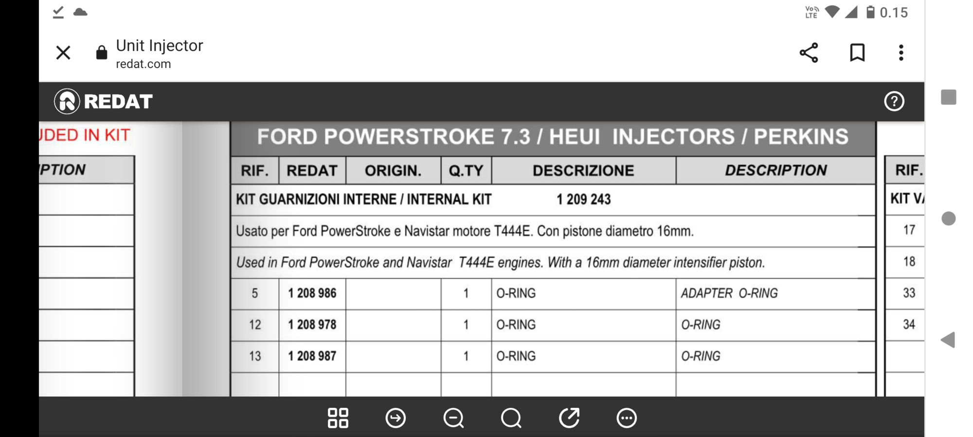

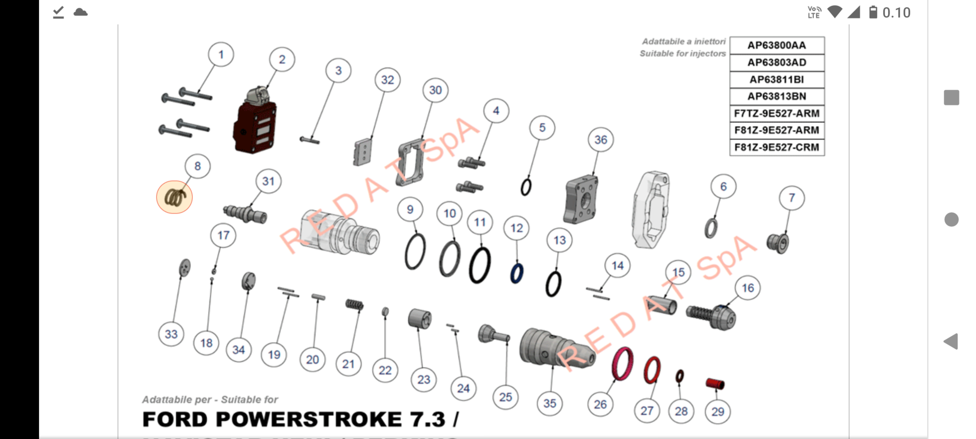

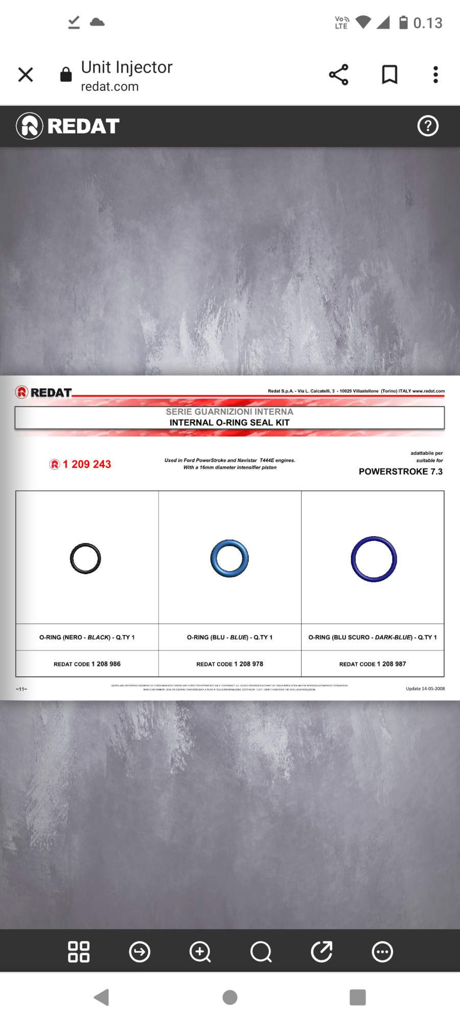

I'm surprised to learn that they actually have internal o-rings.

I found this helpful video showing the tear down of a 7.3L injector. There is a part 2 showing the reassembly and a rebuild kit that's available. I think this may be the best route given there are 3 internal o-rings.
