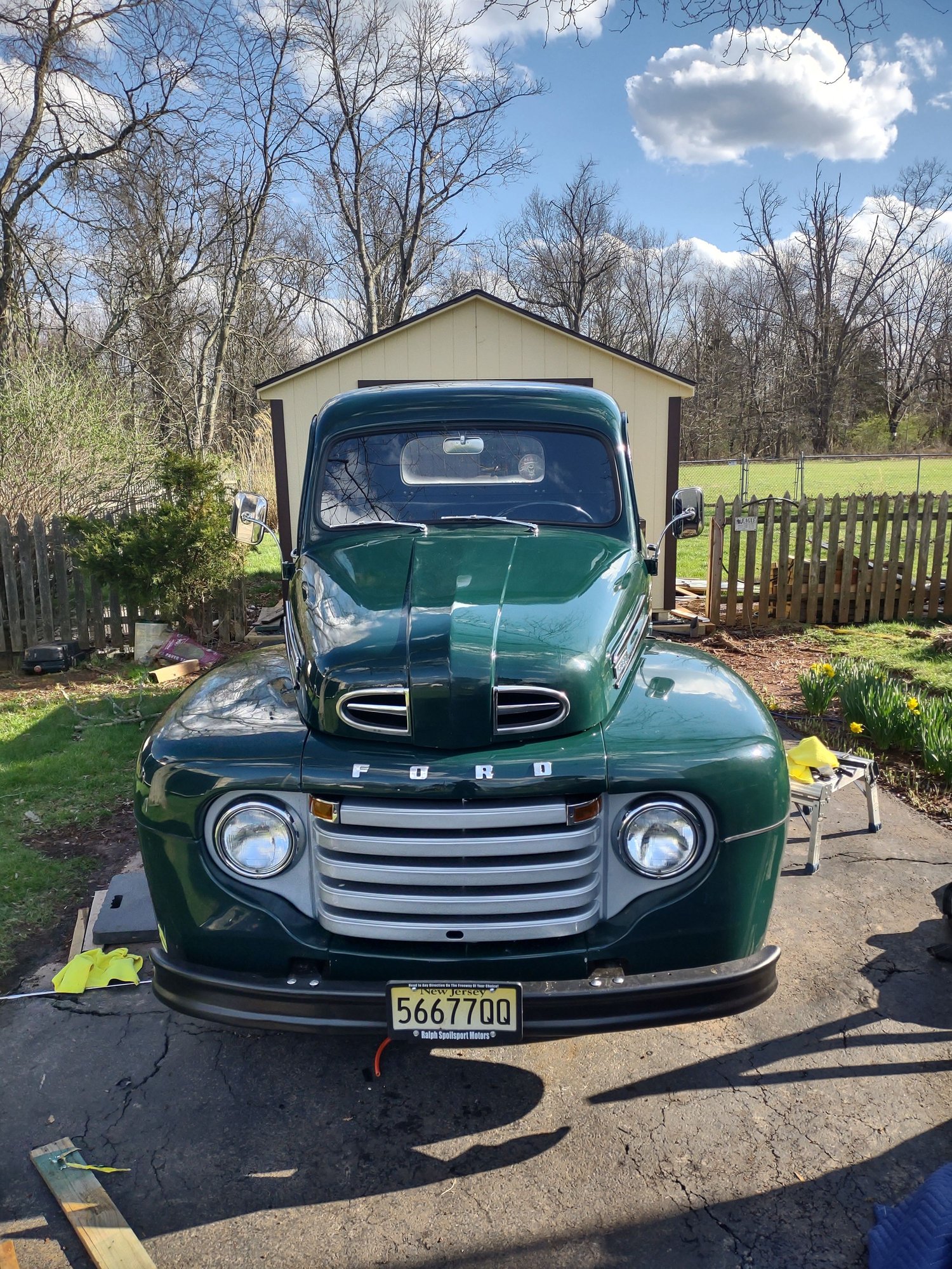

I can’t say I’m a transmission expert but my owner’s manual agrees with Wayne…
I do like the color though…

Your truck is really looking good Bob! You've worked hard and it shows.
Jim
