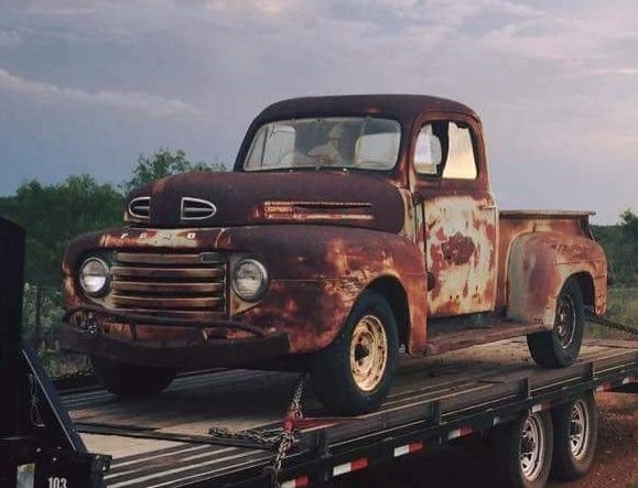

Looking to try and identify the Year Model of this truck.
Year Model? Would like to know.
Thanks in advance!

1950 F-1. The only year with the monkey face and the flat side bed.
1948 and 1949 look identical to the un-initiated.

Welcome to FTE. Nice job posting a picture on your first post.
Your truck could either have a 226 cubic in flathead inline six cylinder engine or a 239 cubic inch flathead V8 engine. Likewise for a transmission it could have a column shift light duty three speed, a floor shift light duty three speed, a floor shift heavy duty three speed, or a floor shift four speed "crash box" (called so since it has no synchronizers). Post pictures of the engine and transmission shifter and we can narrow down what you have.

Its a late 1950 the early 1950 had the same bed and the 48 and 49

A lot of guesswork going on here. There is no way to determine the actual year from a picture. Post the serial number and then we can discuss what year it is.

Technically this is true. The serial number can be found stamped into the top of the driver's side frame rail between the cab and the radiator. Typically it is found near the steering box.
The 1950 identification is accurate assuming all the sheet metal is original to the truck.

Fred, After '47 the serial number was stamped on the passenger side top, close to where the motor mount stands rivet to the top frame rail.
