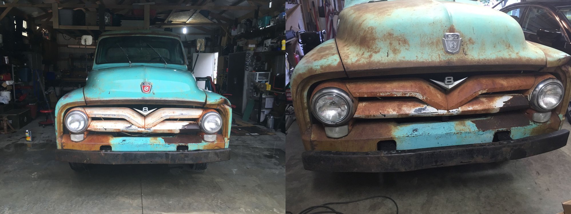

Yep, that was me. Here is my thread. https://www.ford-trucks.com/forums/1...g-results.html
And some pictures if you don't want to click on that thread. I was shocked at how quickly it worked. CLR in water and a green scotchbrite pad.
