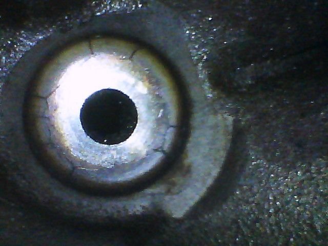

Started removing the injectors today and while at it starting removing the cups as well since they will be replaced anyways. For various reasons I only got the passenger side removed today but while removing the cups I started to clean the injector bores and noticed some what appear to be small cracks at the base where the cup seats. This is on Cylinder 1. Is this something I should be concerned about? Prior to removal I never noticed any issues with coolant in the fuel or any other fluids where they shouldn't be. Just with 360K miles figured they were cheap insurance to replace. Just hope I didn't open a can of worms doing so...

Looks like the old loctite.
Yeah that's what it was. Had to get a longer pick to scrape that stuff away and finally got it to flake off.
