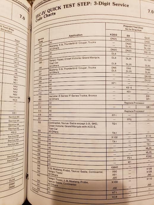

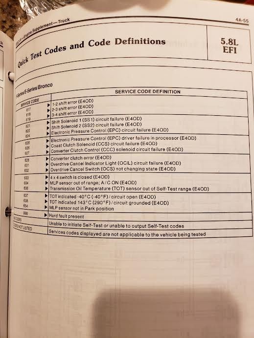

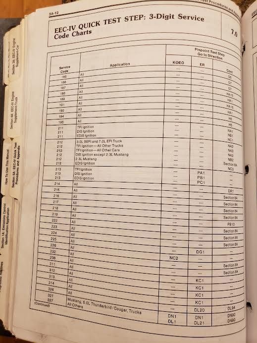

You need to do the pinpoint tests for each code
118 might need a thermostat or it was not warmed up completely before test
Grab a H manual or PCED for your year and see which pinpoint tests associate with which codes
I have a 1992 book that might be the same enough to work

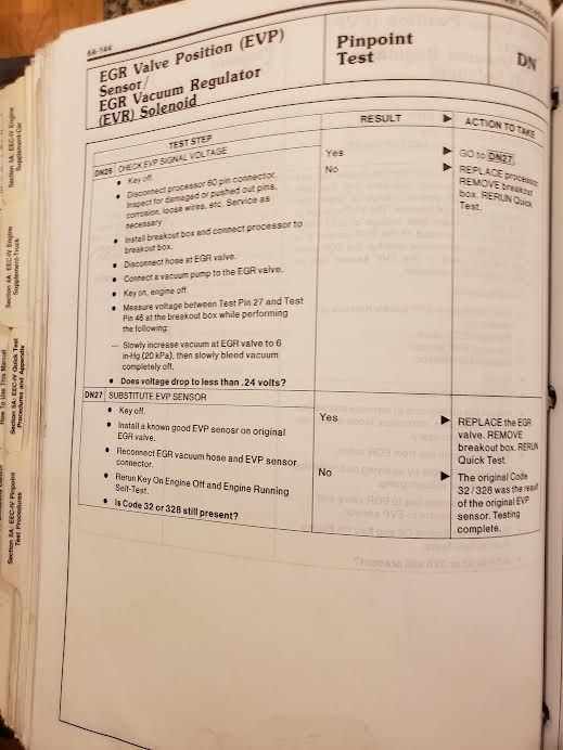

Not the valve maybe the EVP replace
The position sensor on top of the valve ( get a Ford one ) and do the pinpoint test steps first if you can
here is some info
if under warranty back in the day.. I wouldn't even look at it. I would just order a MLP sensor (transmission range switch or neutral safety switch) and an EVP sensor
Let them call it what they will and get a Ford one on thee MLP

Note DN 27 where substitute known good EVP
After diagnosing about 40 cars or trucks and replacing the EVP sensor and fixing them
We used to just start there at DN27 with a new EVP
Same with that MLP any code ever means replace the sensor and call me in the morning
Good luck You can do this
