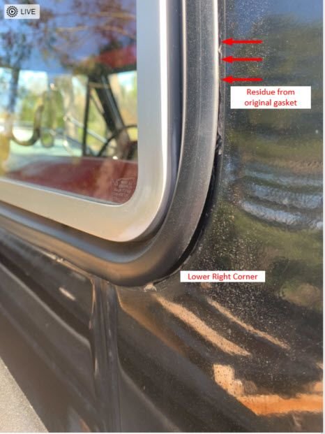

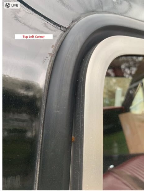

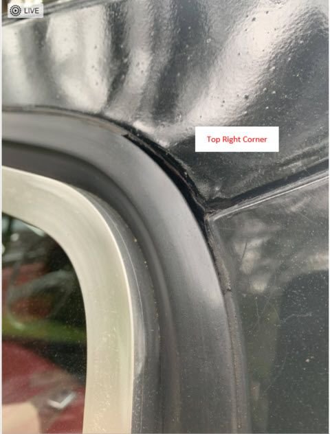

Fuzzy got in touch with me on PM to ask what Rear Window Seal I used for the Passport (aftermarket) Rear Slider Window that I had installed.
My truck was in the shop (a high quality restoration shop) for repairs from an accident. I had them install the Rear Slider and I provided a Back Window Rubber Seal from DC part number D3TZ-104284-A. Here's the result in pictures. Not Good. Poor fit at the corners. I didn't complain much to the shop because I supplied the gasket and they were doing an excellent job on the accident repair - which was running up the cost way over the insurance estimate...that will be another post.

Looks as though the slider may be slightly smaller than the original glass. Worked in automotive aftermarket shop for 15+ years and installed a lot of sliders and sometimes the fit looked like yours even with original gasket. If you believe the problem is with the gasket just pop out the slider and install new gasket on original glass and install in truck and see how it looks. It's not hard, 2 people doing it 15 minutes easy, soap and a rope couple of vinyl sticks. Lot's of videos.
