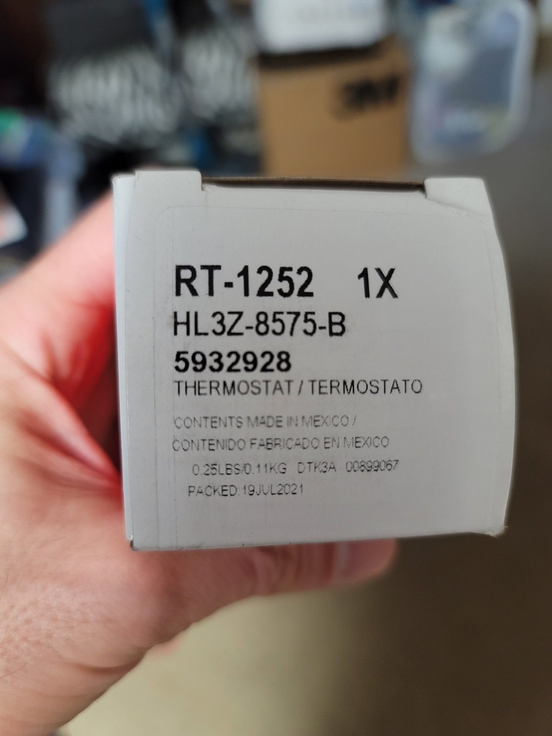

Originally Posted by Overheatissue
There are some F150 owners here who might have experienced some overheat or surge temperature issues. These issues have now been completely solved by Ford with a change in thermostat. BTW, this issue also applies to the Ford Expedition/Lincoln Navigator which have similar 3.5 liter Ecoboost engines. There are some tricks that F150 owners used in the past to resolve the issue such as switching to a 170 degree thermostat or disconnecting the active grille shutters. You will not need to do that anymore with this fix. Reconnect the shutters and dont bother with aftermarket thermostats. This is a complete fix.
The name of the new Ford thermostat is the RT-1252. It has a black end and no gasket on the back as you can see in the photos attached. I put the stock thermostat on the left side and the new RT-1252 on the right side. The main problem causing the overheating issue was the the thermostat was sticking closed but the newly redesigned thermostat no longer sticks closed.
So if you have a 2017-2020 Ford F150/Raptor, 2018-2021 Ford Expedition or 2018-2021 Lincoln Navigator and are finding your truck running too hot then this will be the fix. My truck ran at around 210-220 degrees with the stock thermostat and would surge way past 220 degrees during high demand times. After my truck runs from 200-210 degrees and I cant get it above 212 degrees no matter how hard I tried.
I just joined this site by the way to share this information. I dont participate in websites. This issue has been ******* me since 2018 and I wanted to spread the word on the exact fix for those that need it. Also other things which help keep temperature in line are using the Motorcraft air filter( forget about aftermarket), changing the spark plugs before 50000 miles with the stock Motorcraft plugs...check for most current plug suggested by Ford, and removing the engine cover...serves no other purpose but to dress up engine. However, the main issue is the thermostat.
After the thermostat is changed you can go back to the stock cooling setup to include connected grille shutters. You wont need to do any more cooling tricks after this fix.
