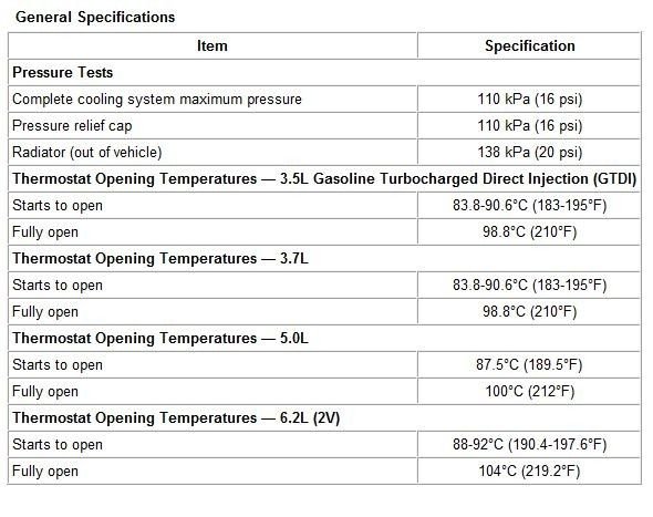

What is the temperature specs for this vehicles thermostat?

Any idea on what the bone stock thermostat is rated for temperature wise? Like is it 180, 190, 200, or higher?
And thank you gDMJoe for the picture that helps a lot.

Bamaseabee - Any idea on what the bone stock thermostat is rated for temperature wise? Like is it 180, 190, 200, or higher?
A thermostat's temperature rating is the temperature (+-3°) at which it will start to open.
So, based upon the provided spec's, the 5.0L's would be a 190° thermostat (or possibly 195°).
