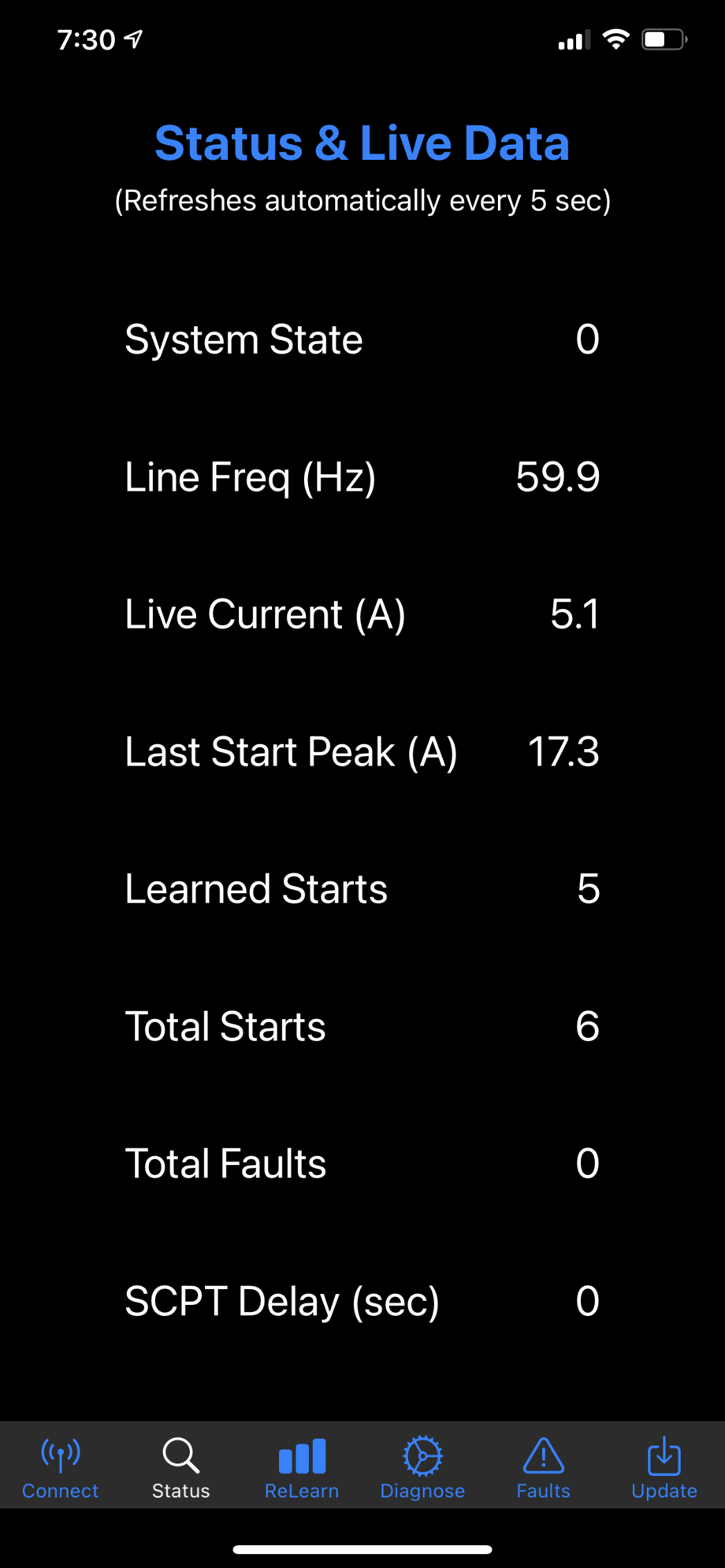

The data:
The difference is that this data is captured at very high speed and displays the real peak's. You also get some data like number of starts, state of the soft starter, faults, lockout delay etc. To me this option was so cheap to add on it was a no brainer to get visibility into the box instead of relying on status lights that require the cover to be removed from the AC and to be on the roof watching it. Setup was dirt simple since you don't have to see the unit at all.
The BT only works when the compressor is on since it gets its power from the compressor power lead.

Nothing wrong with having the ability to see info at your finger tips while sitting in the lazyboy recliner, what you showed can be seen through my inverter.

Thanks! The line frequency is an interesting data point. I've never tested mine. Heck, I've never tested that data point on anything! But having it easily reported like that could be a handy way to tell if you have a crappy inverter or generator.

Jim I'm sure somewhere in your menu for the victron you can see it.
Here is a quick look from the inverter moments ago.
When the gen is hooked up or power pole and passing power through it will show incoming Vac/ Hz .

I'm sure there is a frequency readout in the Victron Connect app. Somewhere. But having an independent report of it wouldn't hurt. I don't know the AC side of things very well, so I don't know how you could screw up frequency. Voltage I understand how to screw that up.
