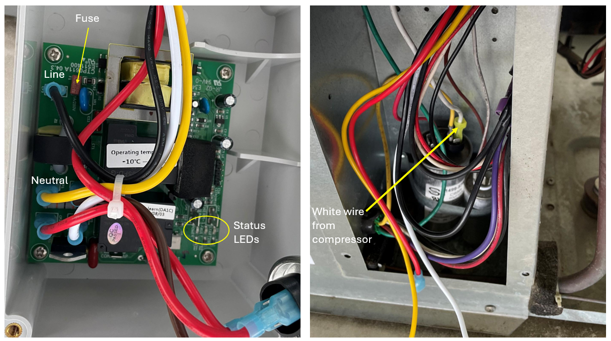

I just had a Coleman soft start module fail, after just a handful of uses on my living room Coleman Mach15. Installed it in April 2024, and it would not allow the compressor to start the 2nd day of our camping trip last week.
After several checks of what else it could be (control board, run capacitor, thermal switch, compressor itself, loose connection, bad wire), I removed the soft start and returned the wires to stock -she fired up.
Further diagnosis showed the soft start had power between the line and neutral connectors from the control board, but the power LED remained off. Discovered the fuse was blown - not a typical customer-replaceable part. I soldered a temporary fuse in, but it still did not work. I inspected the board for cold solder joints, burnt components or traces, but did not find these issues. It would be great to know what part is the weak link on this board, and just fix it, like we do other boards on our trucks.
I think I'll make it so it's easy to wire back to stock on the road, incase this happens again. The white wire to the compressor just needs to stay a female spade terminal. I can put a male spade on the replacement soft start white wire, and make this connection removable. The yellow and red soft start wires simply disconnect from the run capacitor. The black soft start wire can be removed, and the wirenut reused with some new tape to tie the remaining black and purple wires together.

That would suck to have to be on the roof to revert a softstart device when you need A/C.
I think I'll take a "before" picture of mine when I go to install the Micro-Air. You know, just in case.

Agreed. I was holding off buying a second Coleman soft start for the bedroom AC pending the performance of this one. I don't think I can recommend the Coleman unit with these and other's failures. Might be worth the money after all to get the MicroAir unit. I think I'm going to do that for the bedroom AC, and see if I can get this current Coleman soft start exchanged.
I've been using a MicroAir soft start on my home heat pump, and it's been solid for several years of regular/daily use.
