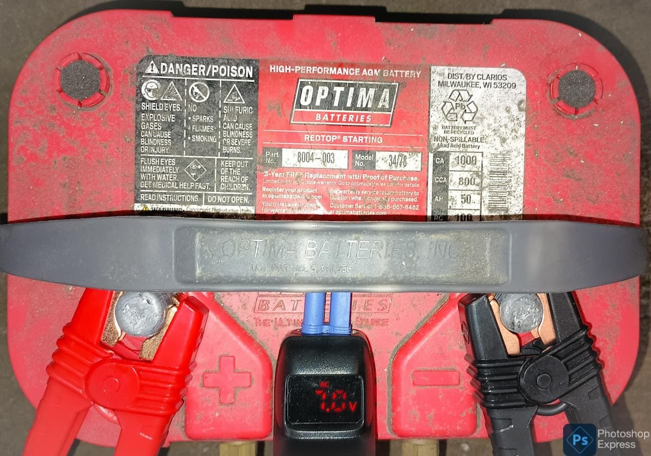

It's not a good battery. 12.1 volts immediately off the charger. The next morning, 7 volts. Just like jump starting, driving, and jump starting again.

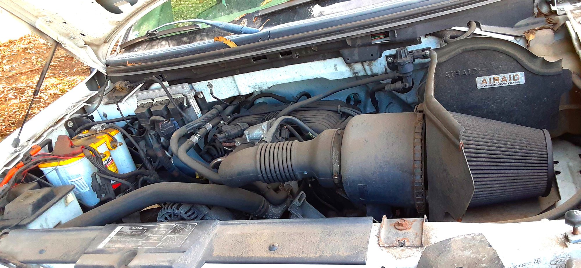

What I am used to seeing in my truck cab, is for the voltmeter to show over 12 volts. Both the van and the pickup now have new batteries. I can relax for awhile.

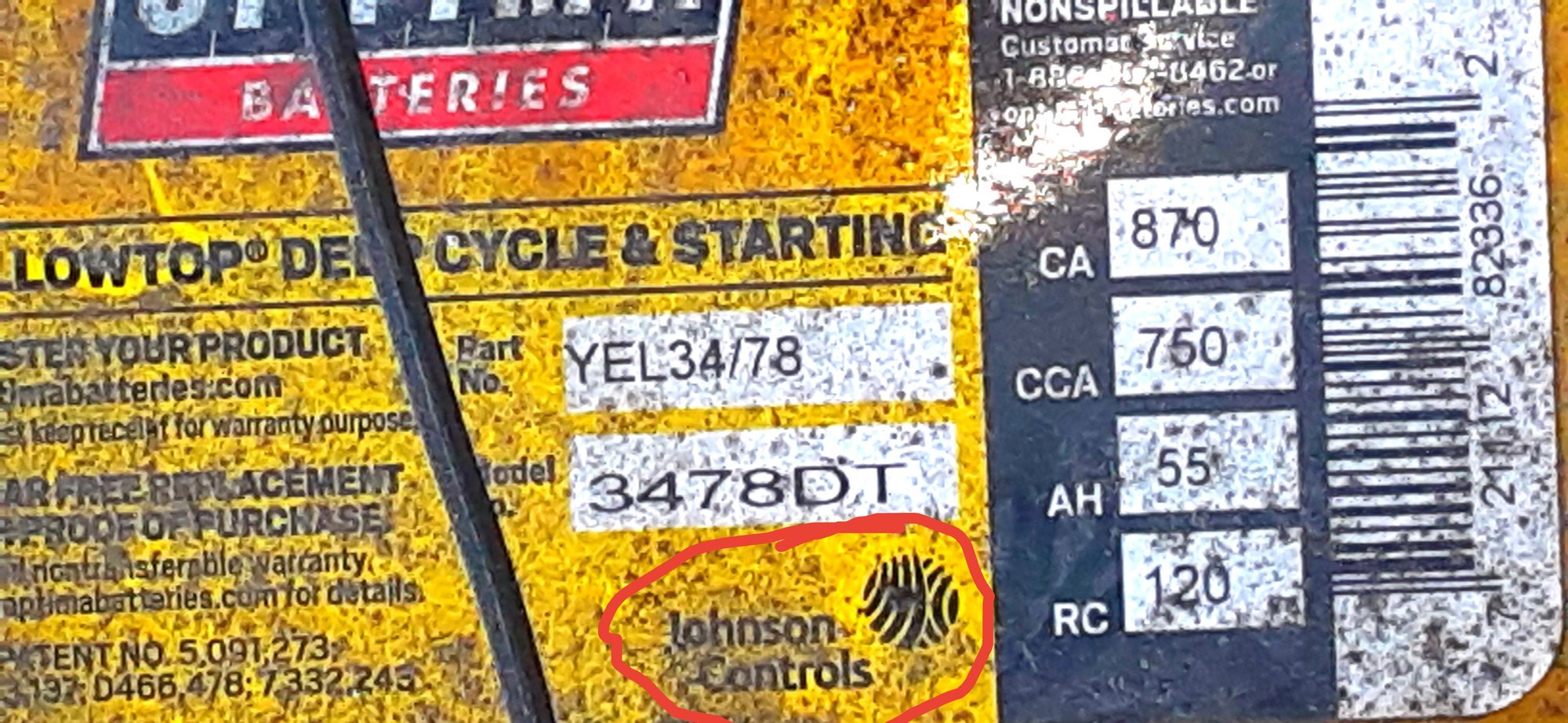

Maybe it makes a difference. Maybe it doesn't. The Yellow Top which lasted 6 years was made by Johnson Controls. The Red Top which only lasted 20 months was made by Clarios. Now I'm running a GM battery in a Ford.
