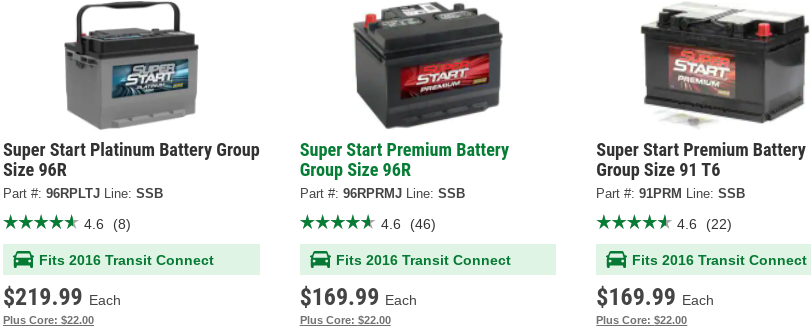

My Transit Connect is still using the OEM Motorcraft. Since I was shopping for a battery for the F-150, I also looked at a battery for the van. I considered a few factors. Power. Will I get better power or performance than the factory Motorcraft. Warranty. Will I get a better warranty than what Ford offers. Price. Will I spend more, or less, than a battery from The Dealership? The final consideration was over the counter sale or internet. I am not paying out of my own pocket, to ship a 50 lb battery back to Summit Racing for the core deposit charge. After looking around, I am pretty sure that I will replace it with a Costco Interstate.

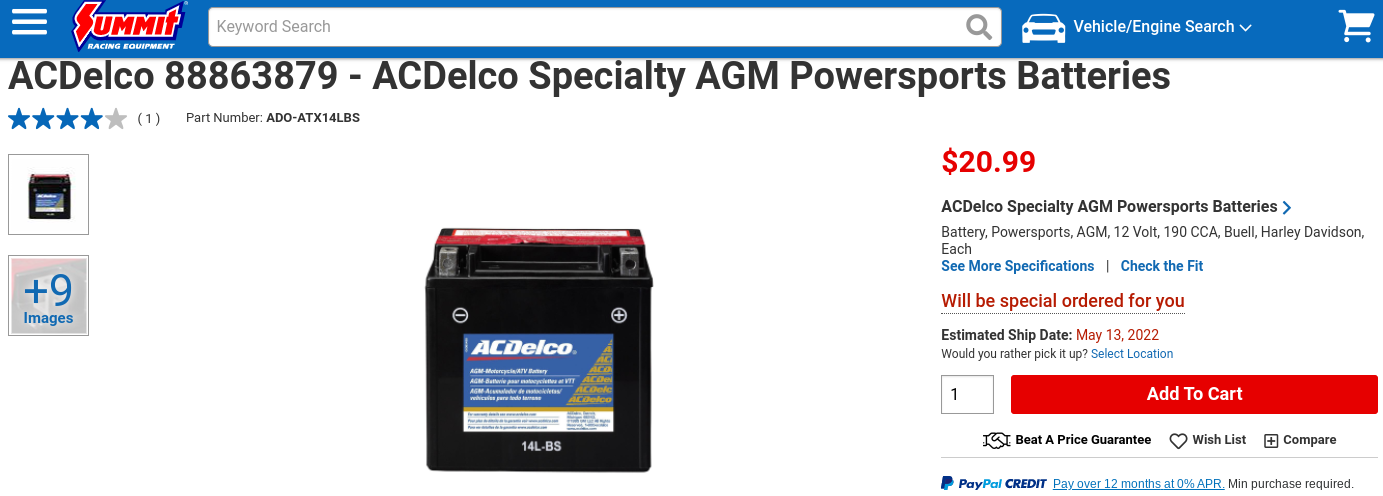

I do know that with my motorcycle, because I have a battery maintainer, the battery lasted about 15 years. An OEM battery, which came with a Battery Tender. I wasn't strict about it. If I didn't ride it for a few weeks, I would plug it in until the Battery Tender's green light indicated that the battery was full. Then the next time I was going out for a ride, I plug it in the night before, to make sure that I had a full battery in the morning. It's a Harley Davidson motorcycle. The OEM battery was probably AGM. Harley Davidson used to use Deltran Battery Tender.
The Harley Davidson battery replacement is a ACDelco AGM. It has a 12 month warranty. I've had it now for about 30 months. Harley Davidson now uses NOCO Genius chargers. I bought a NOCO Genius to maintain the new battery.
Why an ACDelco battery on a Harley Davidson? The price was right. If there was a $20 ACDelco battery for my truck, I would buy it too.

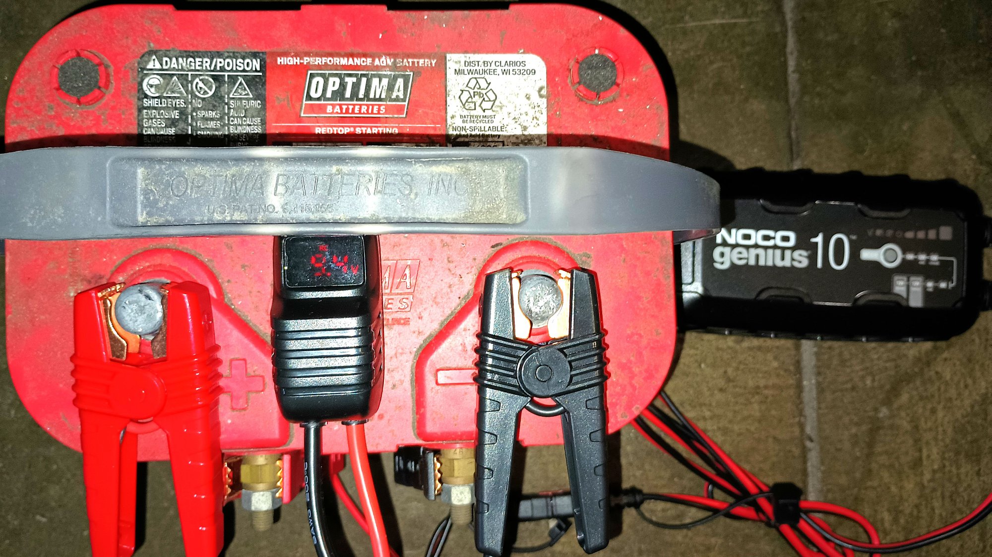

As the saga continues, I am using a Noco 10 amp charger on the 20 month old Optima Red Top battery. It looks like it's taking a charge. The real question is if it will hold the charge. A battery is useless if the voltage drops immediately after you turn the car off.
I'm going to give this one chance, and only one chance. I can't play with a dead battery forever. The charger has a "repair mode". We'll see what it does.
I wish I had more sophisticated equipment to load test it and test it for cranking amps. But I'm not spending more money to buy tools. Batteries die. Then we buy new batteries.
