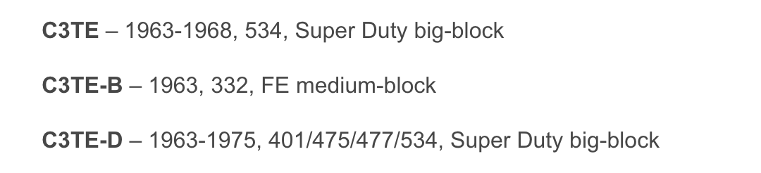

The intake manifold is embossed C3TE 9324 D

For '61 if it's a Ford Y, it would be a 292. But the engineering number on that manifold indicates a 1963 revision date, so something was changed--manifold or more--along the way.

Another suggested it was a Super Duty because of the intake manifold numbers...C3TE D but with an unknown C.I.
I would sure like a definitive ID. to get the correct sparkplugs..ect. because 292 and the super duties are different.
The Id numbers near the Starter are C1TE, which would be a 292 but the engine intake manifold is the C3TE D.
