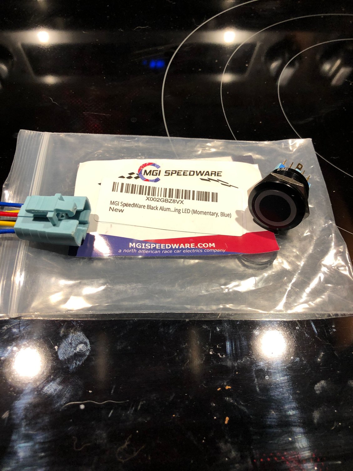

Momentary switch arrived about an hour ago. Just took a look at it.
The switch itself looks pretty good as does the plug. Based on Cody’s advice of 2amp being adequate I went with a 3amp 12vdc.
Amazon Amazon

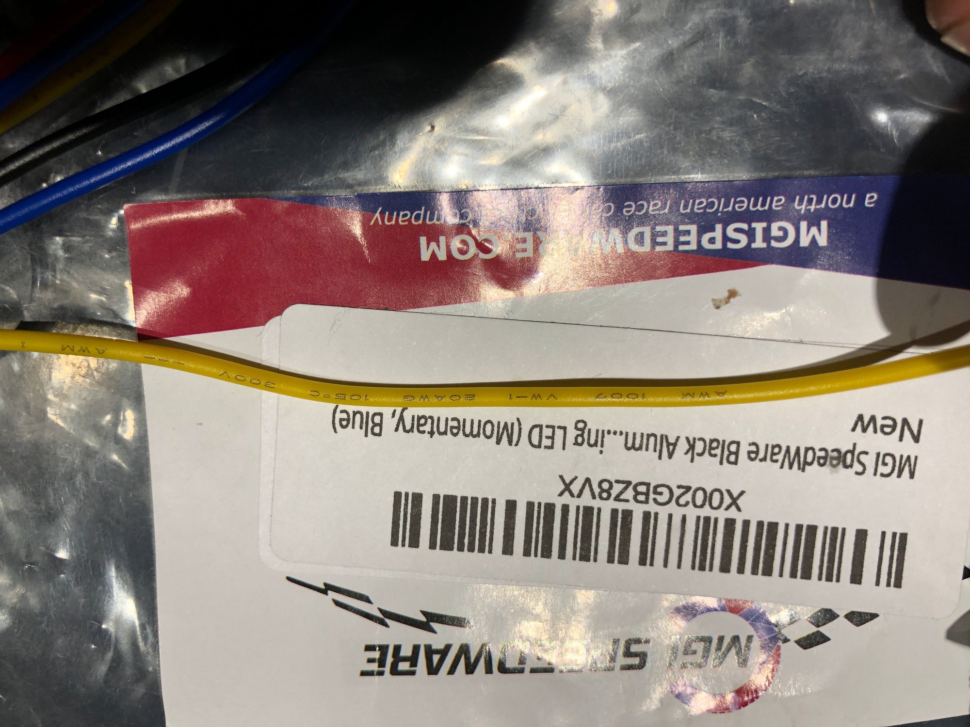

Not too impressed with the wire gauge though.
20 AWG. Going to check it out tomorrow and see if I can rewire the plug with 14.
I had contemplated going with a larger amp momentary which also would increase the size. A 10amp would be hard to hide.
