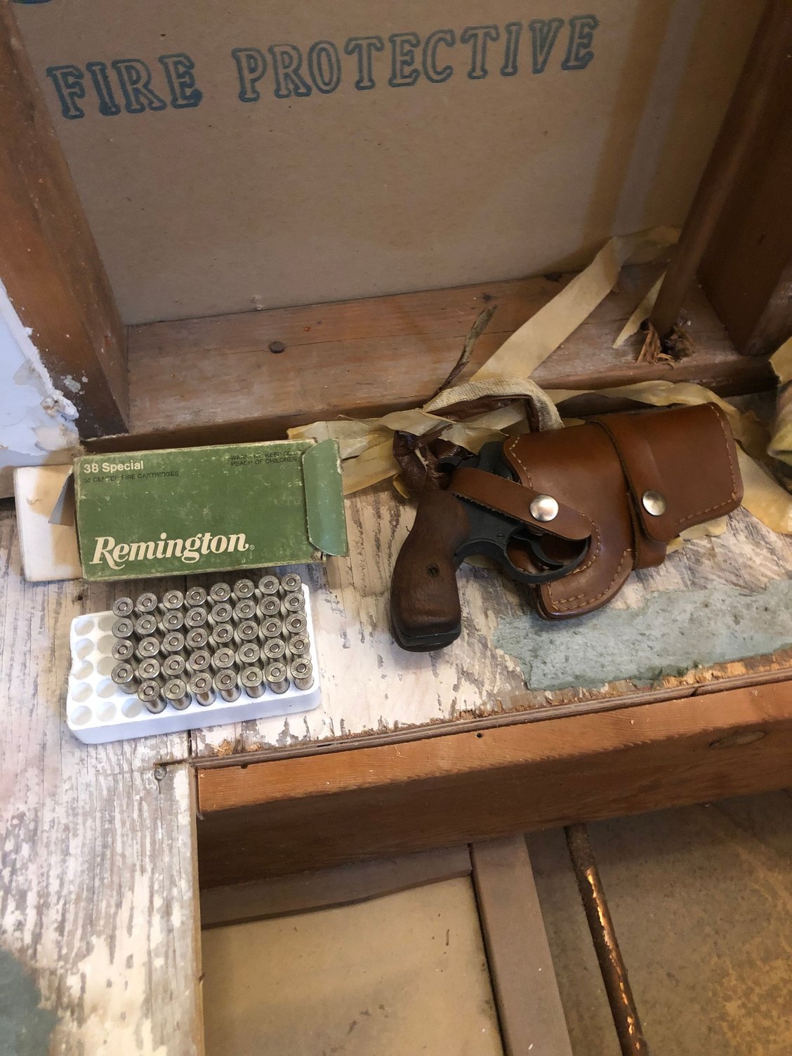

Couple years ago I was doing a Reno in my bathroom. Found this buried in the floor.

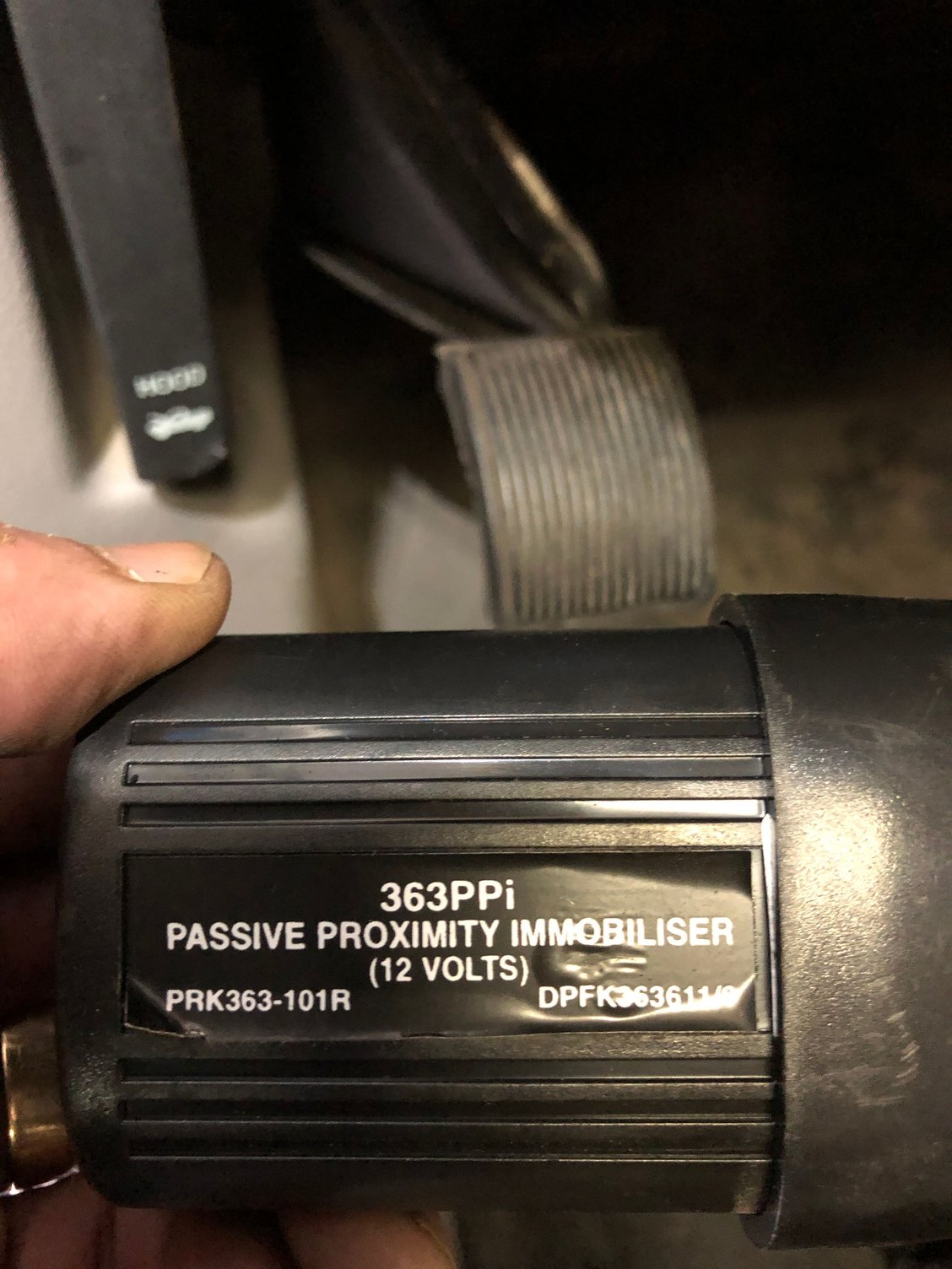

Last weekend had a no start issue. Found this to be the culprit.
First picture was it installed. Second is well… disconnected.
No start is fixed.

That would either be a very nice find, or a very scary find. Referring to the former of course, the latter is nothing but bad. Sweet old 38 special, but I'd be wandering why it was hiding in the floor.

@F350towing I remember when you posted about the first find contemporaneously.
The second find is a puzzle. How long had the truck with the "passive immobilizer" been in your possession, without you noticing an issue, prior to the recent no start occurrence?

I have owned the truck since 2004. Somewhere in 2005-2006 due to the prolific thefts of Superduty trucks our provincial insurance corporation sent out vouchers for a “free” immobilizer install.
I have searched for the receipt for the immobilizer install but to no avail. So I can’t confirm the exact timeline.
Never had a problem before until just last weekend when I went to move the truck out of my shop to give her a bath.
I get a discount on my comprehensive insurance (Fire / Theft) for the immobilizer being installed.
While cleaning up the spaghetti mess of wiring I noticed “Viola” the simple solution to create a no start that is easily reversible, hard to detect, and with a momentary switch basically foolproof. IE… I won’t forget to turn it off.
Just trying to decide on the right switch and placement before moving forward.

Tapping into an essential system (IDM, IPR, PCM, etc) is the only way to even have a chance at a kill switch or immobilizer. I would not recommend the CPP, just as I don't recommend the starter or fuel pump.
The starter relay is a hurdle when considering how to design a security feature, but it is easily overcome when a critical system of your choice is interrupted and the switch or restoration pricess of that system is hidden or tricky.
EDIT: Now that I think about it, the POS immobilizer that was just removed already tapped into the PCM circuitry somewhere based on the no WTS light in the other thread. It would be easy to put a switch or "key" of some sort in the circuit that was already interrupted by the insurance approved immobilizer.
