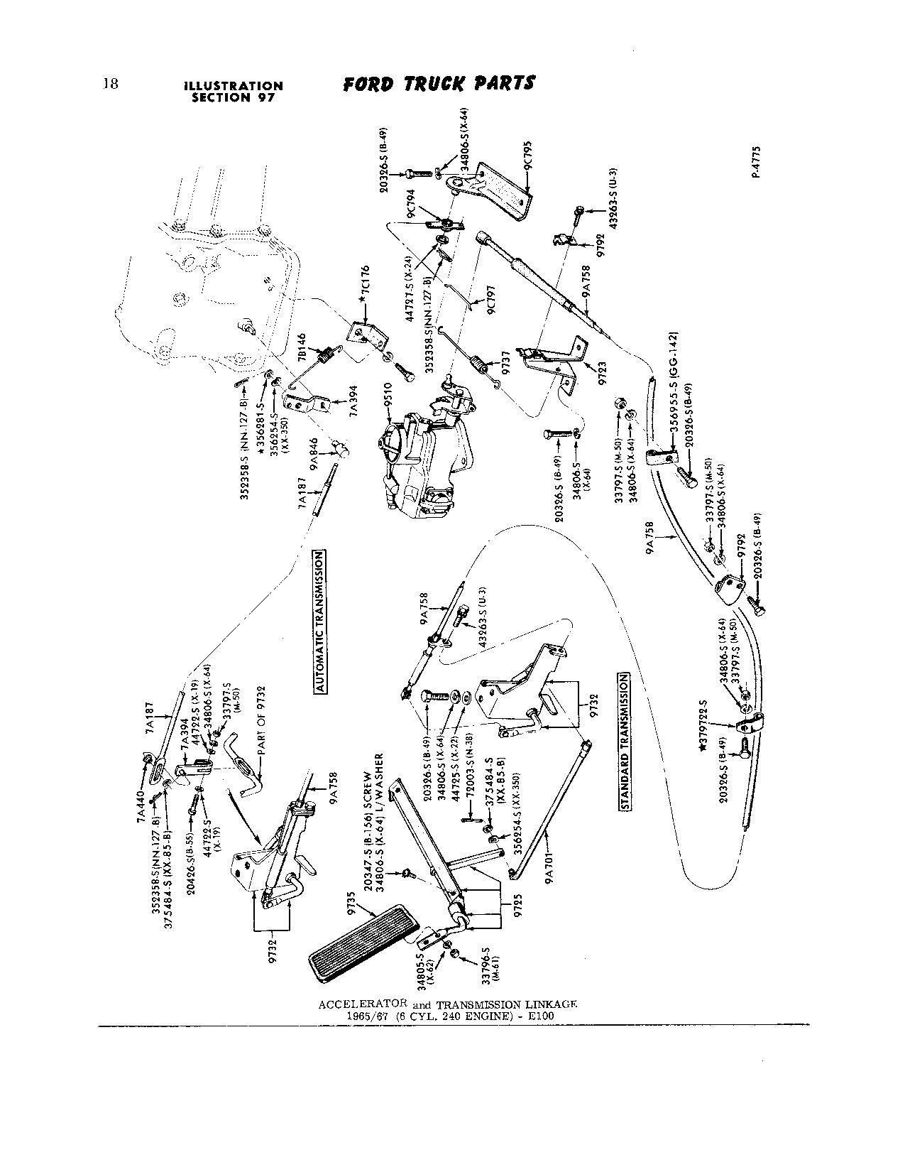

I am looking for a 1967 econoline accelerator linkage. part #9725

Good luck with that. What is wrong with the one you have, I have linkage issues on both my '65 Falcon and my '65 Econoline and will rebuild all the pieces myself. Unless you can find a source with a nice used one, you're probably out of luck. IF yours isn't missing it may be rebuildable.
The other alternative if you are not doing an accurate restoration is to go with a cable throttle assy. Lokar makes pretty much everything you need to assemble one from the pedal to the carb. They are a little pricey, but they are much better then original.

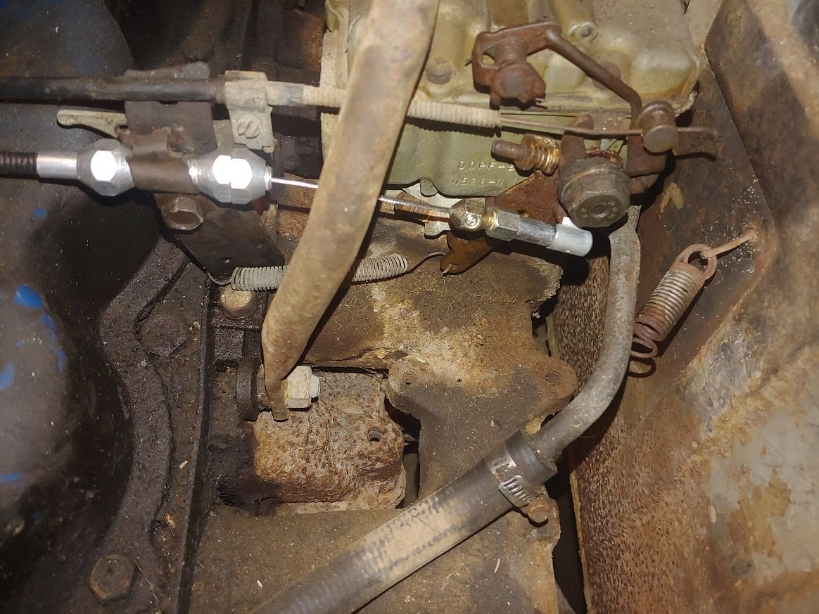

Haven't been on here in awhile but I just picked up a '67 Econoline van. The throttle linkage was pretty much non existent on mine. I had a Lokar linkage (Lokar S-1034) hanging up on a peg board. I just ordered the universal cable kit (Lokar TC-1000U60) from Speedway Motors and put the 2 pieces together. I over compensated for the amount I thought I'd need by getting the 60" length kit. The 48" kit should be long enough - I ended up with a ~42.25" length of cable and ~37.25" of the jacket when it was all said and done.
  • Loosen up the ball end linkage from the cable
  • disassemble the linkage
  • pull the cable by the red ball end out from the clevis side (you don't need the clevis yoke anymore)
  • re-insert the cable through the lower half of the ball end linkage
  • screw the other half of the linkage back on
  • route your cable
  • then just attach the other Lokar S-1034 linkage end to the opposite end
She works like a champ.

That was a very informative and detailed explanation on the Lokar conversion. Great pix as well. It is now on my To Do list.

Decided to pull the trigger on the Lokar conversion but when I went to order the 2 parts from Speedway shipping was $35...yikes! I checked Summit and they don't carry them so I checked JEGS and they have them both and the shipping was only $11. Thanks again for the great description and photos of how to do the conversion.
