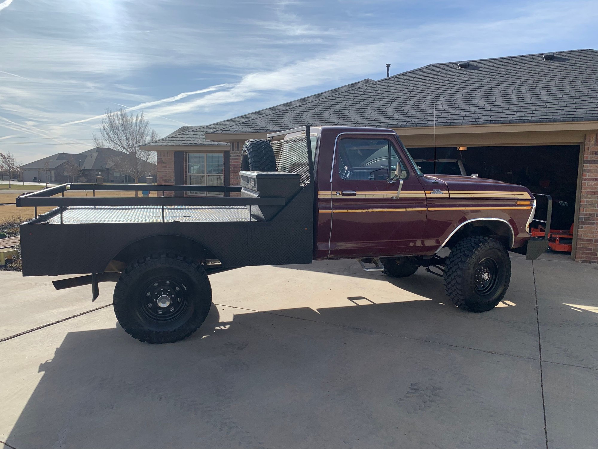

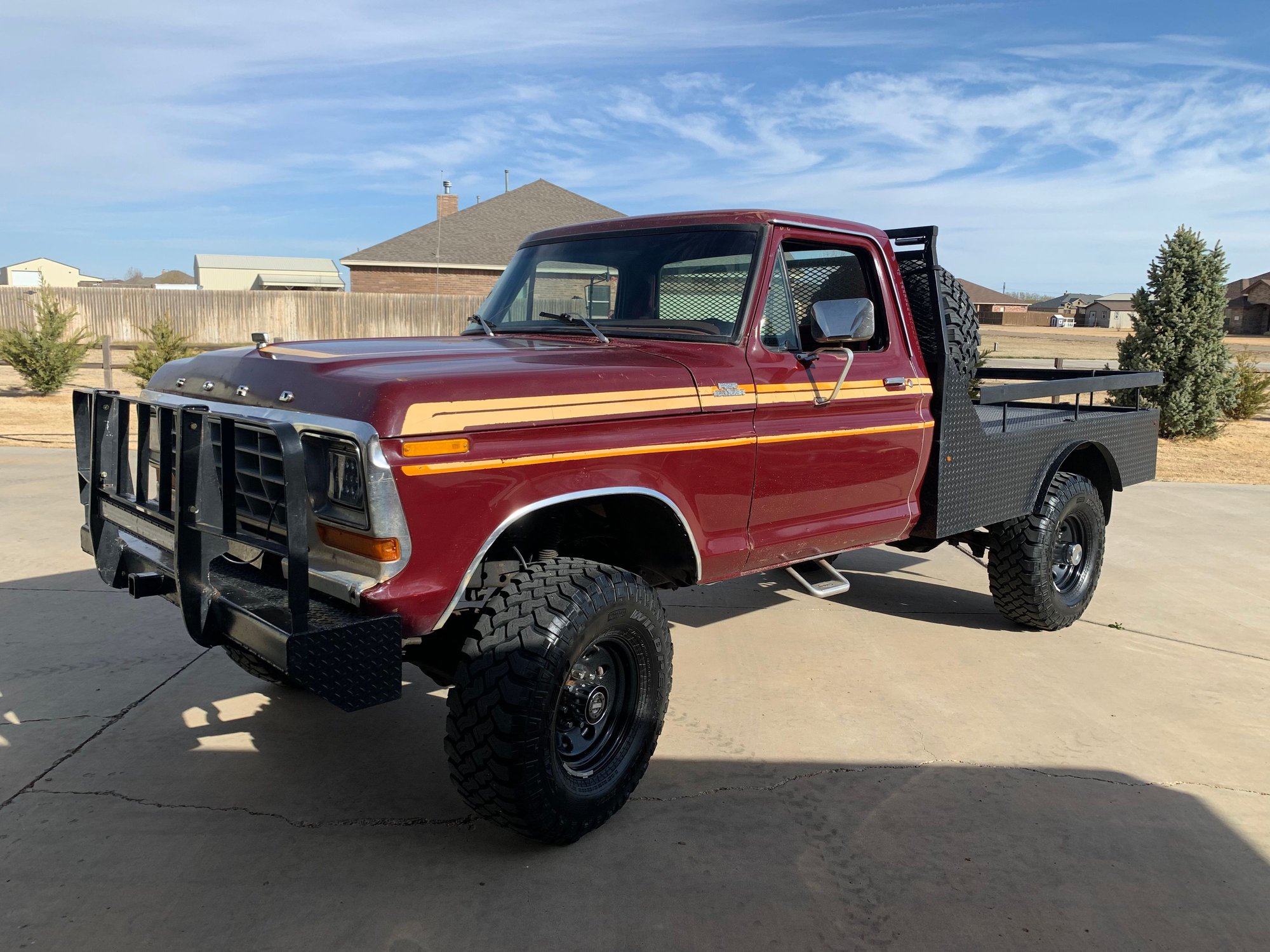

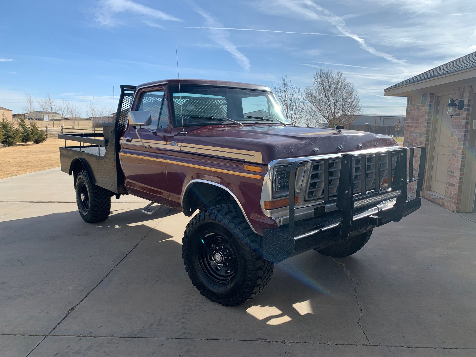

Just got done with a wash and wax to show off that 43 year old paint!

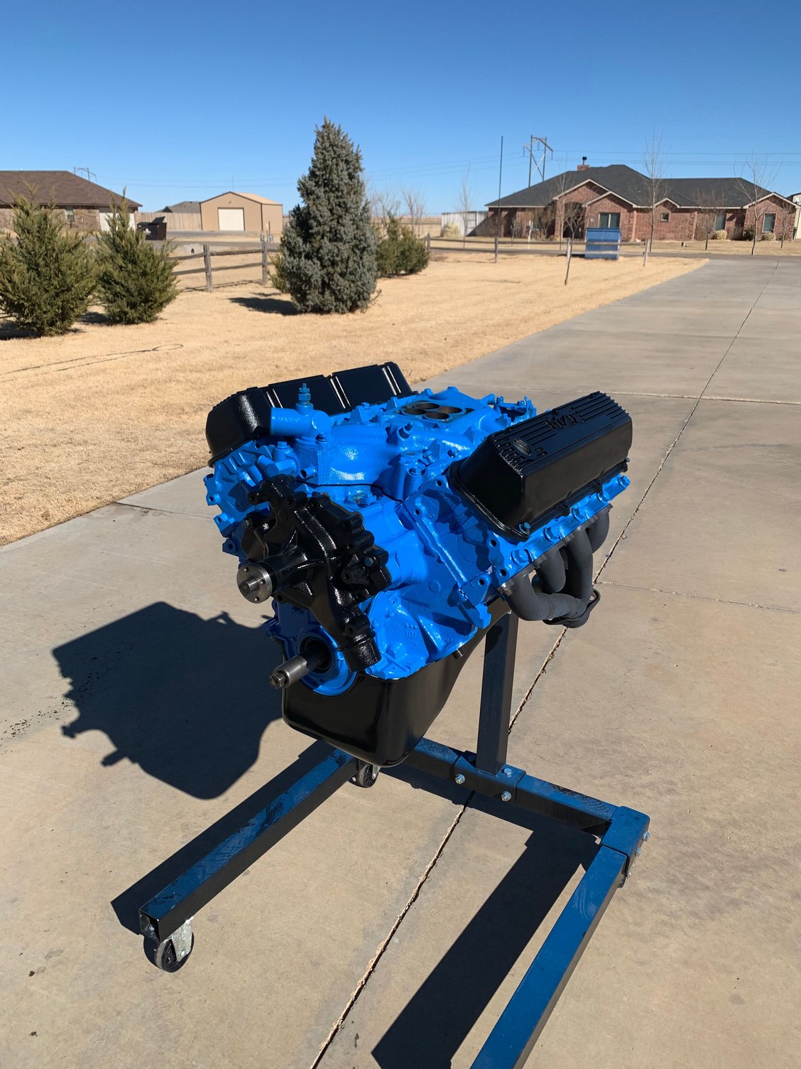

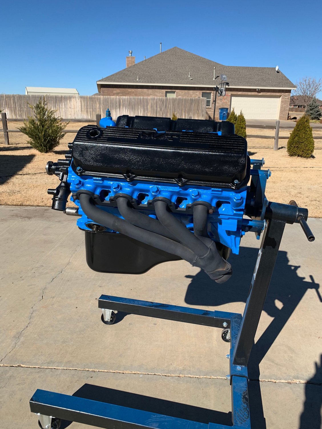

Probably more importantly my freshly rebuilt 460 is running awesome! It was my first ever engine rebuild so I’m pretty happy. As expected I had a few rookie mistakes but I’ve recovered from those and 1500 miles later I’m pretty stoked with the results. My rebuild included some very mild head clean up on the exhaust side, new mild cam, new timing set, new rod and main bearings, a ball hone job and new rings. All of this goes with the ZF5 I swapped in last year. So far 10-11 MPGs with conservative timing and AFRs using the Atomic TBI. Only 2000 RPMs cruising at 75 MPH with plenty of torque even at that low engine speed.

Thanks. I never went far just been busy I guess. I drove her right up to New Years which is when I pulled the 460 and spent about a month working on it and getting it reinstalled. I’m creeping up on 20k miles overall since I got the truck but only 1500 on the new motor. The old 460 was tired and had low compression due to leaky exhaust valves. Turned out cam bearings were trashed real bad too but I didn’t know until I tore it apart. Everything else was ok but can’t even imagine how many hours I spent cleaning everything that came out. Tons of carbon. Still has the stock rotating assembly. Also think I figured out the 460 came from an early 70s car based on the block casting and I think the rod bolts. Does have D3 heads but no provisions for emissions stuff so I think that indicates early 70s as well. Either way she had a lot of miles (wish I knew how many).
