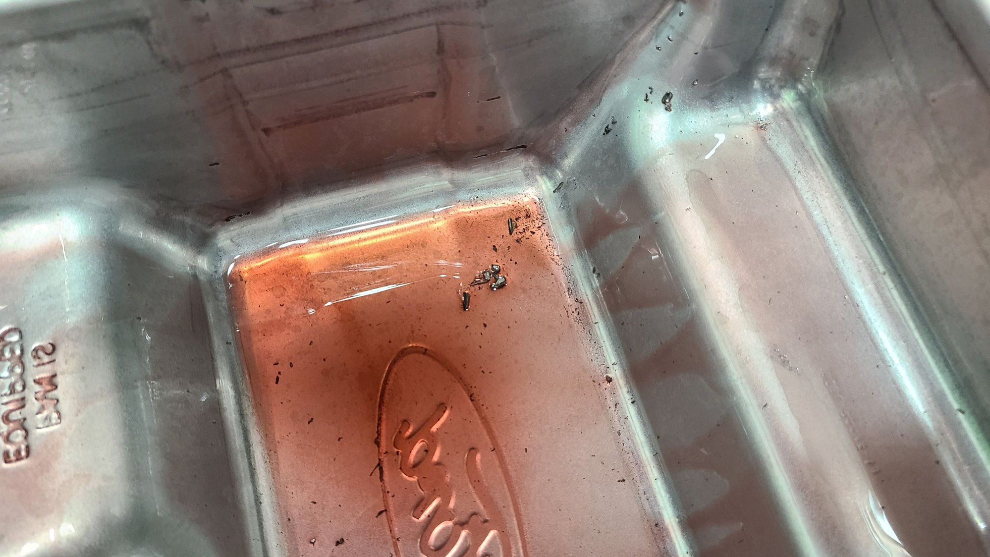

Originally Posted by Mark Kovalsky
P0752 indicates that SSA is stuck on. I suspect a bad solenoid is your problem.
Found these metal bits in the pan just now when putting in the new solenoid. Any ideas? About to clean it and reassemble then drive it. Fingers crossed

That looks like a whole lot of material to jam a solenoid.
What he said.

I didn't button it up because the 6.4 filter looked dark and I saw glitter in the filter (30k on filter). I planned on getting a new filter in the morning before filling it back up to be safe. But now I'm wondering if it's even worth dropping $70 on a filter at the dealer?
Fluid was changed religiously every 30k using SP. Never abused the truck, simply used it like a truck. Wonder if the snap ring recall applied to my early '06 build.
Anyone recommend a good stock replacement transmission online?

Thanks Mark. I decided this trans is finished. Those are some considerably solid chunks of metal in the pan, so something is starting to come apart/eat itself. Not going to waste $80 in SP fluid to try to button up the pan, even if it runs I suspect it will leave me stranded again soon enough. Was considering a Ford reman due to the 3yr warranty, but am reading and hearing of not so great experiences with it. Strongly considering a Warren stock+ and waiting a few weeks for it, priced the same as a Ford reman.
