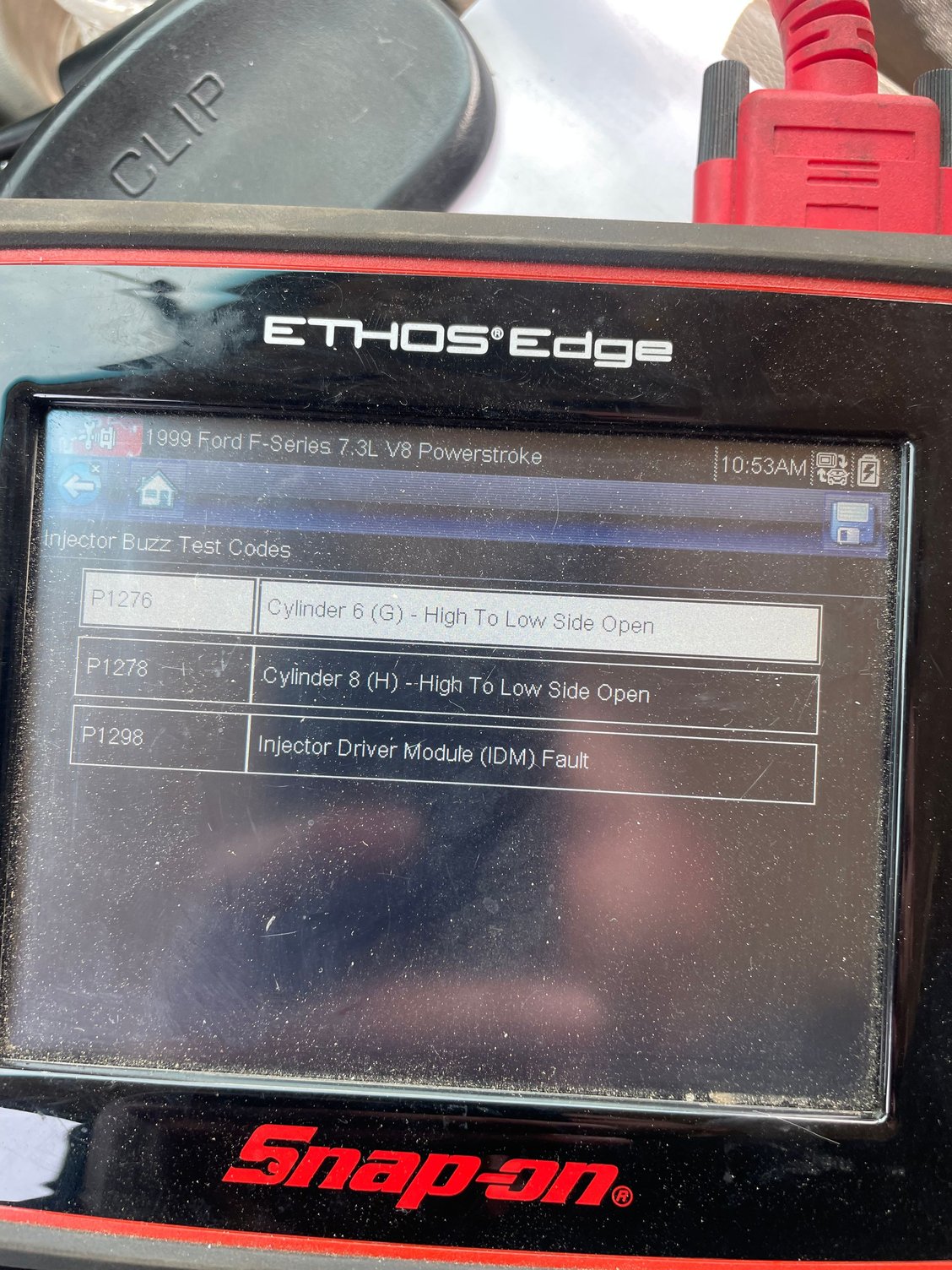

OK so I’m new to this I just got a 1999 F250
7.3 I keep getting codes for cylinder eight contribution blah blah blah the problem that I’m having is as soon as I get up to 30 miles an hour it cuts power starts running real rough and putting out white smoke that smells like fuel I replace the injector with another one from another truck before buying a new one and it’s doing the same thing

I replaced the IDM and cylinder six code went away but I’m stuck with number eight In the exhaust back pressure code is because it has the delete pedestal but from what I’ve heard it’s just a soft coat and won’t really bother me that much

Check the underside of the 42 pin connector at the driver's valve cover for any kind of damage. Might consider a fuel pressure test just to rule it out also. There is an easy method that uses the fuel bowl drain valve as a temporary test port. The instructions are in the tech section up in the stickys.

I may be wrong because I often am, but a #8 cct failure is run of the mill, a high low buzz fail isn't though. How does the buzz test sound? You get 1 pissed off hornets nest then 8 individual uniform crisp rattles? If not then I'd suspect wiring first. The doggy power and smoke sound like fuel pressure problem though.

You are not wrong sir, not this time anyway... Cylinder #3 will often show "off a bit" during a CCT as well.
Mezzmer3325, a buzz test is a good and easy way to check the function of the IDM, electrucal side of the injectors and associated wiring. Udsuth78 has a great description of what a buzz test (in FORScan it is KOEO Injector Electrical Self Test) should sound like.
