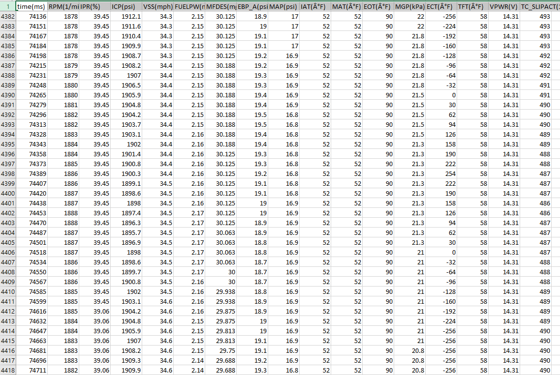

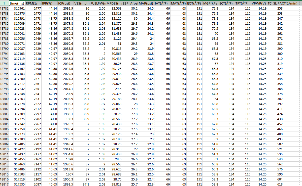

Problem – Driving on interstate – check engine light came on and engine lost power. Engine stalled exiting highway and would not restart. Towed it home.
I ran codes and found the IDM had codes as well as HPOP pressure. I replaced the IDM – still no start. Replaced the IPR (cheap aftermarket one) and truck started but ran very badly and still had IDM codes. Replaced both valve cover gaskets as one appeared to be coming apart. I also replaced #1 injector as it was not oiling and had no change to engine when unplugged while running.
Truck now runs very nice, but throws code P1211 after about 10 minutes of driving.
Please take a look at the attached datalog pictures from forscan and see if you see what is out of line. It kind of looks like the HPOP pressure is slightly low and that is what the code reads. How do I resolve this?

Agree with Sous, it looks like the IPR is misbehaving. From your reallog3 data, IPR is starting out high at 25% at idle on a cold engine, yet ICP is at a normal-for-cold-engine 626 psi.
Under moderate acceleration, MFDES is normal at 35%, yet the PCM is commanding the IPR to 45%, to get the normal 2281psi ICP for that fueling level.
You could try this same run with the ICP disconnected, and see how the PCM commands IPR%, just in case the ICP is off.
How does the fuel filter look? Is it black, pointing to possible o-ring leaks?
Fuel filter is brand new also. I put in the napa one where the filter and cap are one part.
tomorrow ill unpluk the ICP sensor and get a new log.
Also that last picture in my first post look at the ECT values. those are some pretty high sub zero temps. Is that right?

ECT will not read on an automatic truck, so you can ignore that PID. Also, recommend changing the units on MGP (boost) to PSI so they will show up correctly on the chart.
