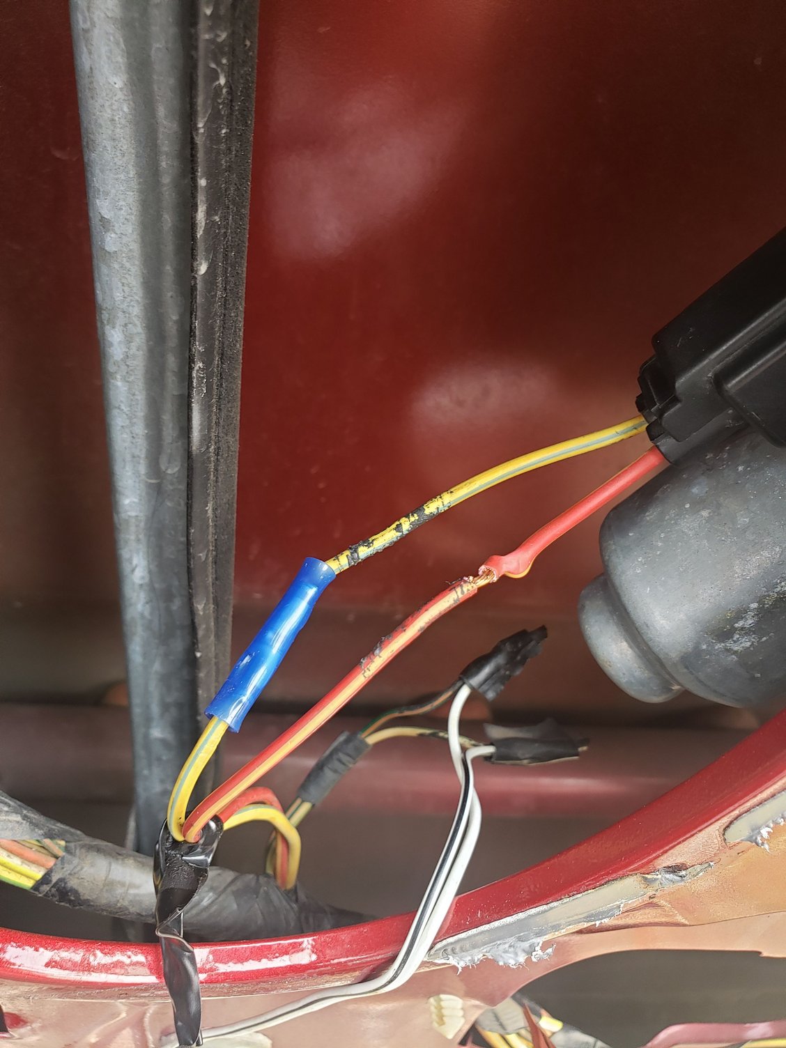

passenger front won go up or down from driver switch
will go down from passenger switch
Ran battery to motor goes up an down fine
replaced driver switch with new one no results changed.
test two wires going in to motor when switch at passenger door pressed down red/yellow goes hot yellow/gray goes ground and window goes down.
When press switch up both red and the yellow wire has a 12+. If I ground out the red/yellow wire an press switch up the window goes up.
Was thinking body contro module mite be acting up but after web searching looks like thats not involved in window circuit.
any help appreciated!
Red an yello wires mentioned above

Have you check your wire harness where it enters the door? Common problem on our rigs with their age, the wires fray from the movement of the door and short or even break causing “things” to stop working. Worth a look. Good luck.
