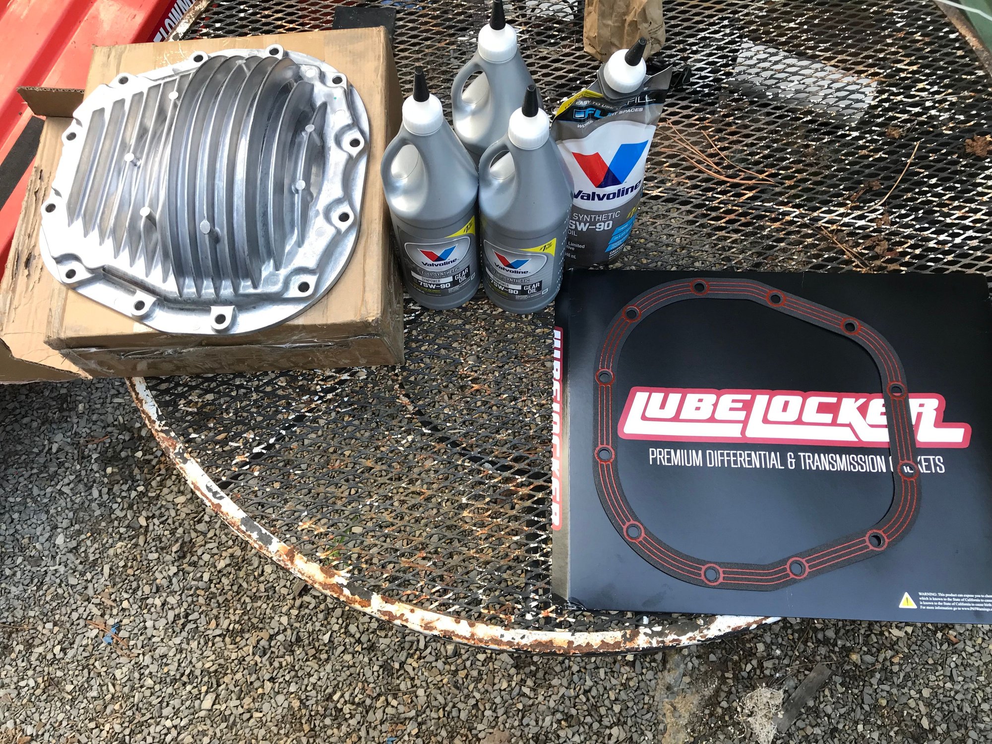

Originally Posted by DSLTRK60
Also, instead of pacing about and worrying if the oil is 1/32" below the fill plug, you'd far improve the life of the oil if you ditch the steel cover and install an aluminum with heat sink.
Lower oil operating temp means longer oil life and better lubrication properties
Done.
Did my change at 25k miles. Filled the diff until fluid ran out of the fill hole...just like I've done all my life, and like my dad did all his life (a lifelong auto and heavy equipment mechanic). Some of ya'll worry too much

Originally Posted by ATC Crazy
Done.
It's one of those things that can be easily overlooked or nags in the back of your head until you confirm it's right. The big problem is that by the time you realize there's a problem, there's a serious problem and the warranty may be done.
Done.
FInally secured the elusive OEM M300 cover. Waiting on the bolts then will ditch the steel cover.
Interesting note is that the gas trucks call for 80-90W and diesel is the 140 weight oil. Same axle.
