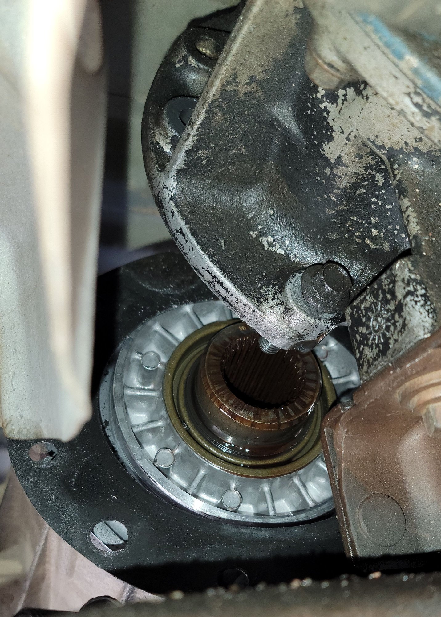

So here is what I found when I got under the truck.

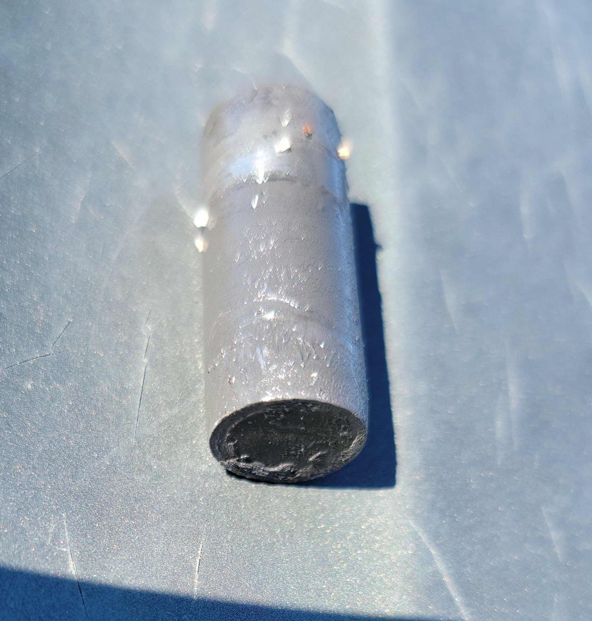

Found this in the driveway, but no clue if it came out of my rig.
I have five bolts left
I spent the afternoon mating the trans and transfer case back together. I don't move as quickly as I used to. Noticed some cracks on the rear of the front driveshaft ears, too. Then I carefully backed it up the driveway and into its spot. Didn't notice any odd noises in the couple hundred or so feet trip of twisty turns up and down hills, so that's good, I hope.

So the transfer case cracked?

that looks like an alignment pin that snapped out of there, definitely sounds like the transfer case might have an issue.
I was going to say torque converter until you posted that picture. Its almost like the gears or a drive shaft jammed somewhere and caused the case to rip or shear itself off when the energy had no-where to go.
I saw no signs of cracks. I will have a more thorough response to the next comment.

I agree that the object pictured appears to be one of the two alignment pins that reside between the bolts. Not enough info in the pics to see what might have happened to cause the case to separate from the transmission. Could be a faulty install...Never heard of one coming loose without serious trauma to it.

You say you have 5 bolts left, I'm guessing all the bolts worked their way loose and you are left with just 5? As in the previous shop didn't torque/tighten things?
