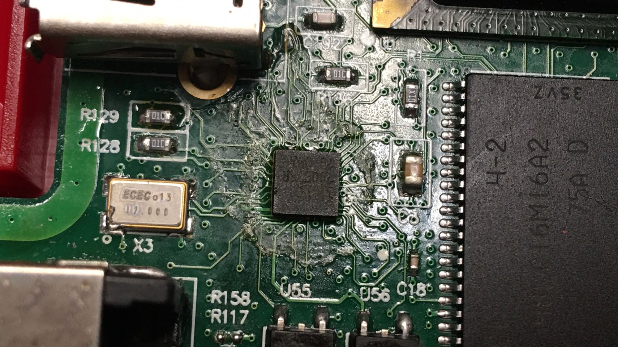

A few years ago my VCM clone stopped working, and I just pulled it open to find one chip nuked. Looking at the current clones on eBay, it looks like ther are current two board layouts, a singular board and this mutiple board, which doesn't have as many sellers. Other sellers note single chip/best, or whatever. I still have my orginal cables and software discs from the years it was working.
I know Sean is out of the game for a few years, but he had mentioned some are better that others. Sean, is that due to the board layouts/chip counts?
My gutted VCM2.
There is one vendor with a board layout like mine, but it's not coming in until May, and I've got a hurting LS.

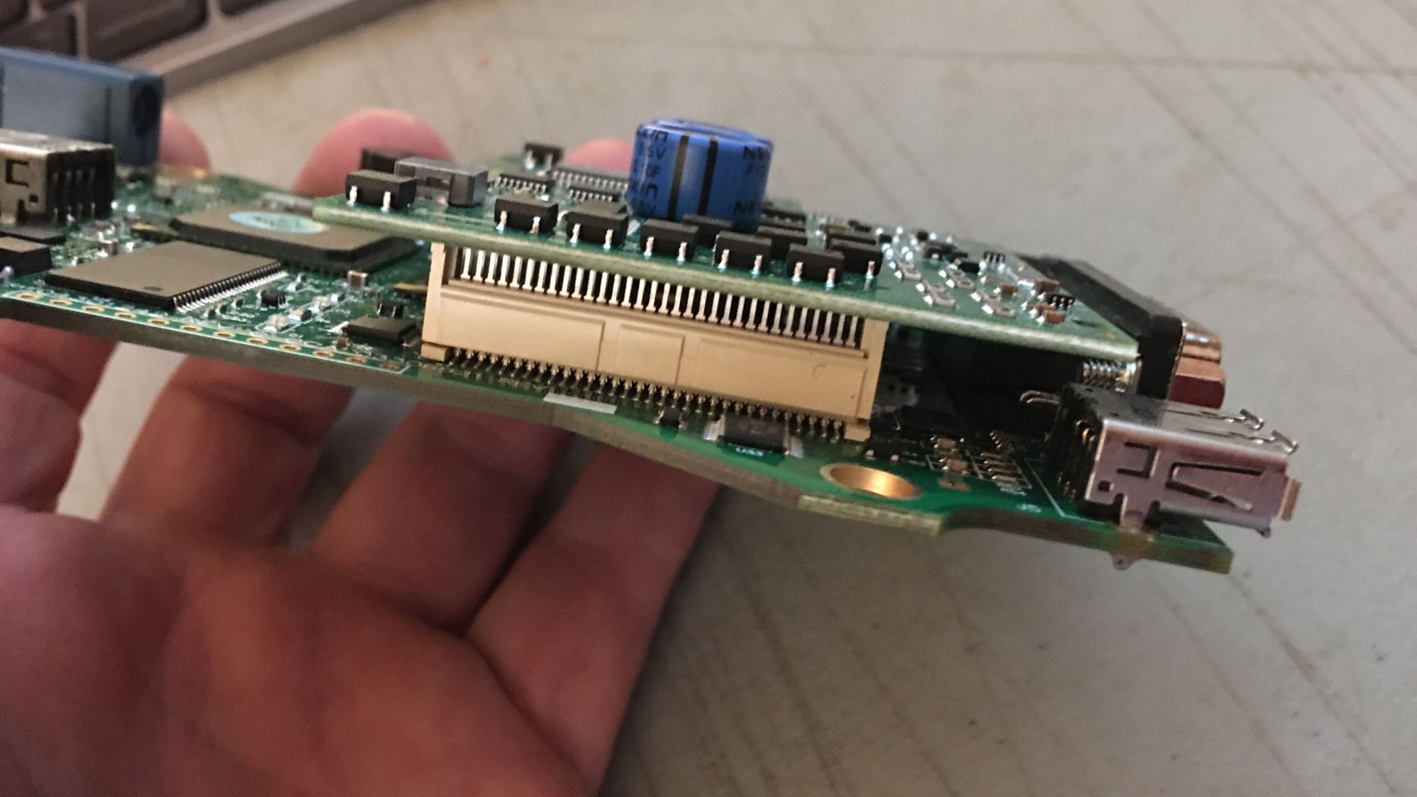

Jack if you look at several of the VCM2s from China you will see that the run the gambit when it comes to board quality and
chip population. Some only have the one board and wave soldering where the really good ones also have gold terminals and
multiple stack boards. Well two anyway. I once got one that the caps on it had started to leek. Needles to say it did not work
for squat. I have even gotten 2 from my supplier that sort of don't work in that they won't let you roll-back the firmware so you
can run V86.x I still have those two and am not sure if the new firmware can be reloaded or not. I would have to load v100
onto the laptop to even test them.

I did find one vendor with a board like mine, who knows if it is, or what is shipped will be. My gut was with the stacked boards, it had to be better. I'm almost considering getting a real Bosch unit for $700-800 to have a reliable VCM. So much time has gone since I last played with this.....
The nuked chip as noted above... just for reference.
