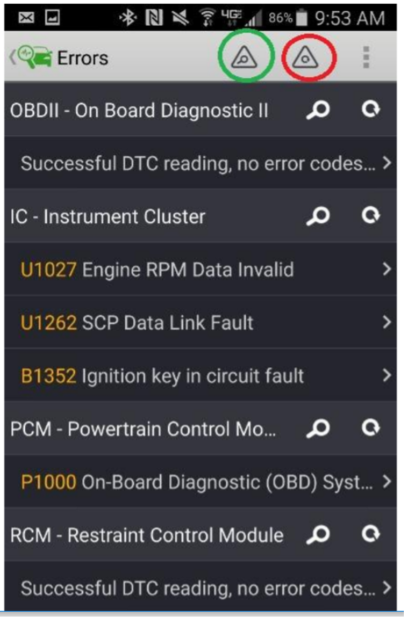

Thanks for the information. The FORScan will work though the OBD2 port?
It will. Here are screenshots from FORScan Lite, used on an android phone, as an example. You can see codes from each module, from PCM to GEM to ABS:
