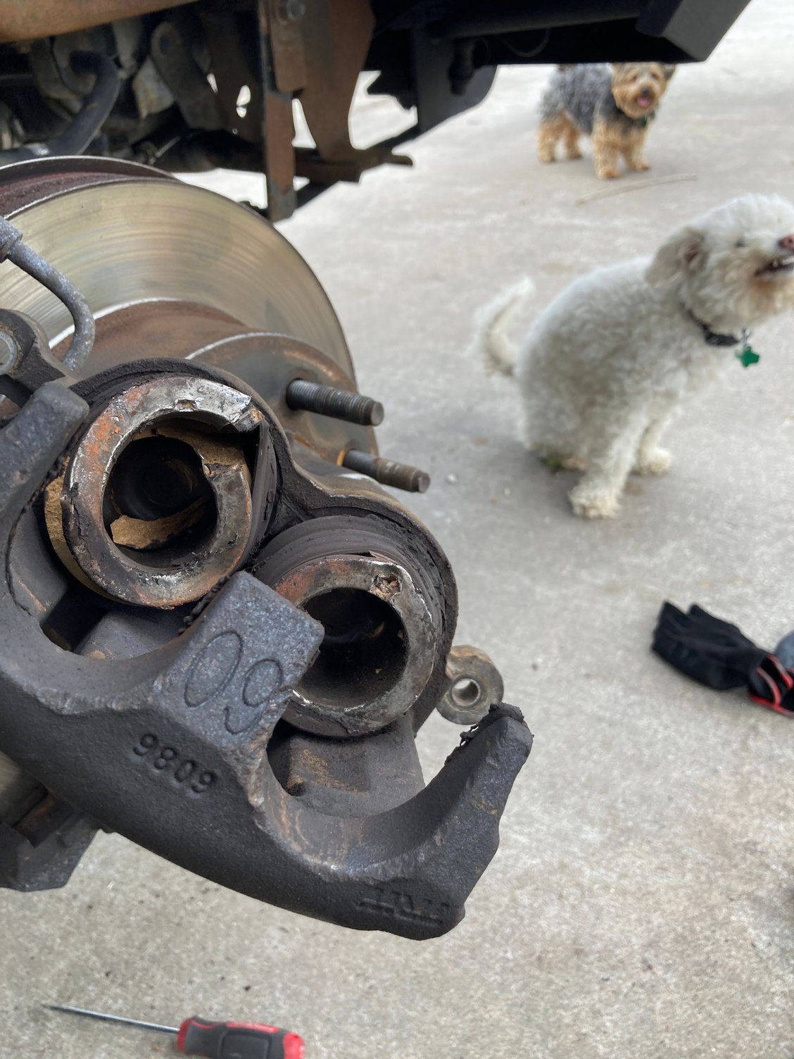

I don’t know if this was my problem, and I’m no actual mechanic but I’m sure this isn’t helping.
also anyone know the minimum rotor thickness off the top of their head.

Yeah, I can't get my dog to hold a wrench either. You'd think he could pump a jack handle anyway. Did they gnaw up your calipers like that. That'll cause a shudder.

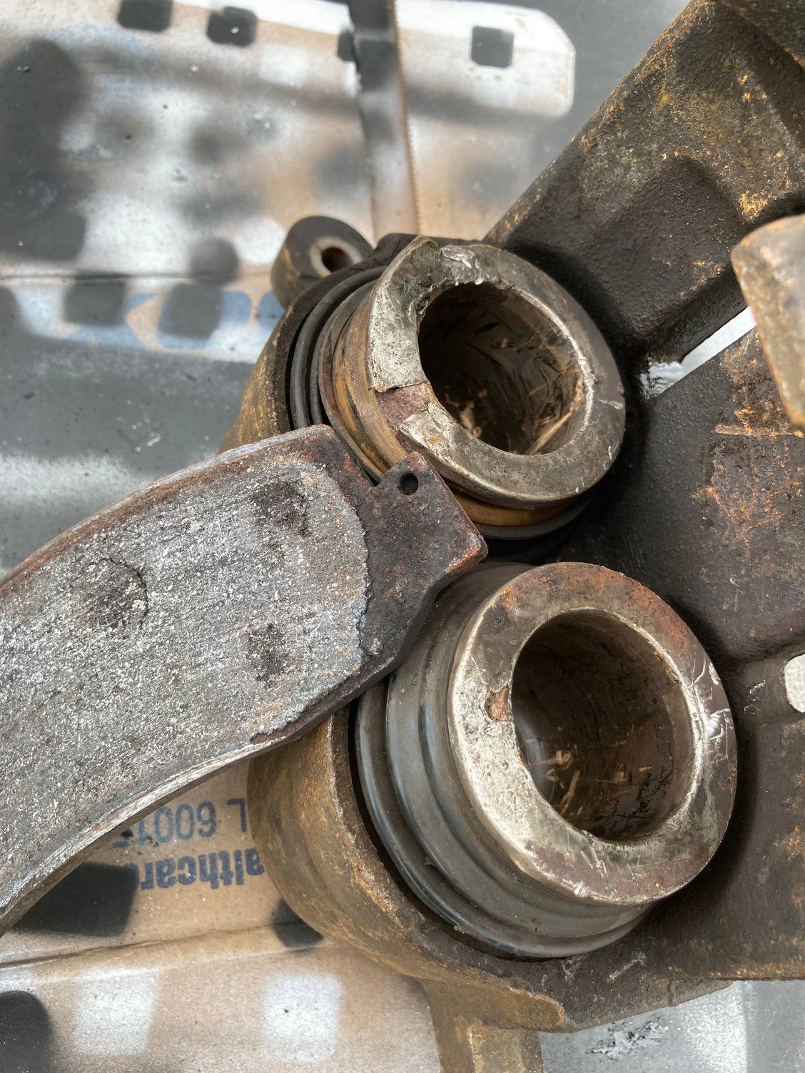

She’s not as bad as the one in the background, that one is an attention princess. Something happened during my trip up north because the brakes had plenty of meat when I left and it’s only been 6k miles.
This was the left side and that top piston took a screw clamp with a foot long handle using all my might to break loose accompanied with a very loud snap then started moving back in. I knew the caliper was done for before I got it off just wanted to see how bad it was seized. The bottom slide pin never came out either, it started bending from the hammer blows and never moved so had to replace the whole bracket.
it very well may have been my problem. Symptoms seem to line up. It mostly happened when the truck was hot which for me eas a lot of stop and go traffic - engine temp wasn’t a factor it was the stop and go with the brakes. I noticed it most when leaving a stop and getting up to speed - brakes were just used and pads weren’t disengaging. The shudder was certainly felt through the steering wheel - well calipers/brakes are connected to the steering. I took an hour long drive yesterday and no issues, lots of errands today with stop/go and no issues so far.

Yep, looks like the pistons froze. TooManyTools is the brake expert here. I'm not sure what makes them lock up like that.
The tear on the piston at the top is caused from forcing the brake pads out before pressing the pistons back far enough to clear the studs on the back of the pads. The first time I changed my pads I was unaware of the studs on the back of the pad and did the same thing. If the brakes were just put back together with the torn piston face that could be a problem.
Absolutely what happened with that tear, I usually wiggle a screw driver in there to push the pistons in just enough to clear the nubs then use a piston tool when they're off the truck. But when the little screwdriver didn't move the piston, then the big screwdriver didn't move the piston, and then the 2ft pry bar didn't move the piston I knew it was F'd and just wanted it off. For the other side with the dogs in the photo that was the second one and I wasn't even playing I knew I was replacing the caliper and went full send.
I’m at a total loss of where to even start with this intermittent issue. The truck will seemingly run fine, then I’ll get a shudder around 30-40mph with the steering wheel shake, and it gets worse the faster I go, but surface streets only let me get up to 50-55, so I don’t know if it’ll work itself out. The truck also then falls on its face, and giving it throttle will run the boost up but not get me anywhere. Yesterday when it happened, I noticed the trans temp climbed up to 185, but I can’t recall if it happened the other times.
That is a classic case of brake caliper hangup, the pads in constant contact with the rotor(s). It will shutter with steering shake as the rotor heats up, any variation in the thickness of the two rubbing discs, or if the rotors developed hard spots from prior dragging issues. The thick areas expand more to develop friction variation as the rotor rotates. The faster you go, the more heat, expansion, and pulsations. If the hard areas are pronounced, it can be more of a friction variation going over the hard regions as they develop a polished appearance and lower friction.
I usually can push in the pistons easily with a screwdriver, but I prefer to use a c-clamp to clear the steelback nibs. Once the caliper rotates off, I will use a special tool for pushing the pistons back in.
Do you have images of all four pads? Looking from the top can tell if it’s pistons or pins, but pins usually are an outer pads wear problem. Brake hoses can do this too, but it usually only one axle side. Both sides will be calipers, pins, or the master cylinder leaks in the back, and rust builds up between the M/C piston and pushrod. Pads hanging up in the brackets can also cause wear issues, but not the pulsation and dragging brake that would cause it to feel underpowered and transmission temps higher.
Above all others, I prefer the OE Ford rotors, even over the lower-priced “Motorcraft” rotors.
I doubt there are any engine issues.
I don’t think I threw the pads away yet, I’ll post a picture in the morning. The driver side had a seized upper piston and lower slide pin and had to replace the bracket. Once it finally came off and i saw all that I didn’t even try to be nice with the passenger side, biggest pry bar came out and ripped that piston off. Slide pins were ok on the passenger side bottom one was getting corrosion. Everything was replaced.
when you say Ford OE I’m assuming like the ones that came from the factory and lasted over 200k miles of my abuse. How do I order those, get them from the dealer and as long as they don’t come in a red motocraft box I’m good?
