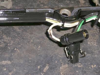

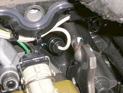

Here are what the factory clips (in lieu of quarters) l
What I found on my engine, straight from the factory was the glow plug lead on three push rods had been rubbing on the pushrod, grounding out and burning up one of the pins in the VC plug. Requiring replacement of both VC gasket assemblies and under cover wiring harnesses. In addition, I had to replace the conductor inside the wiring harness plug that attached to the outside of the valve cover gasket wiring connector. All on an engine that had less than 60K on it.

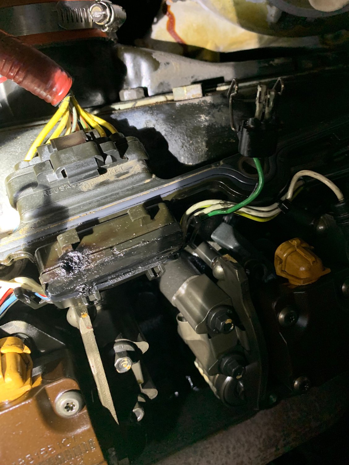

Still waiting on parts that should arrive tomorrow. I did dig into the engine today inside the hangar as it is out of the elements and has an outlet 10 feet in front of the truck so the block heater keeps everything warm..
The under cover harness had a crack on the clip that broke when I touched it and while disconnecting the injectors two of the harness plugs came apart in my fingers so I am hoping that was the issue.

As promised now that I have good internet...
The clips holding the harness to the gasket were all brittle and no longer doing their job. The clip holding the harness to the main connection was brittle and cracked. When touched it broke off in my hand. As you can see the harness had a few issues. Injector 2 and 4 clips were brittle and broke upon removal and there were rub areas on the injector wires which likely lead to the hole in the connection at the harness.
All injectors checked good prior to closing up the engine however out of 8 glow plugs only #2 is not playing. I could not get a Motorcraft glow plug so it is on the next time it is open list. The gasket is a Motorcraft and the harness is from Navistar, Clay had everything I needed. I also have a new set of CAC boots but only did the hot pipe so far. Those RiffRaff boots are nice. Re-torqued everything under the cover to Ford specs while there, the rockers were all good with the injectors close but loose.
All injectors buzzed good with a good contribution check both cold and warmed up after a 20 run.
Engine is happy so is the owner.
For anyone looking at doing this job it is easy just take your time. I did lots of cleaning and even re wrapped the hot pipe and probably only took about 5 hours.
