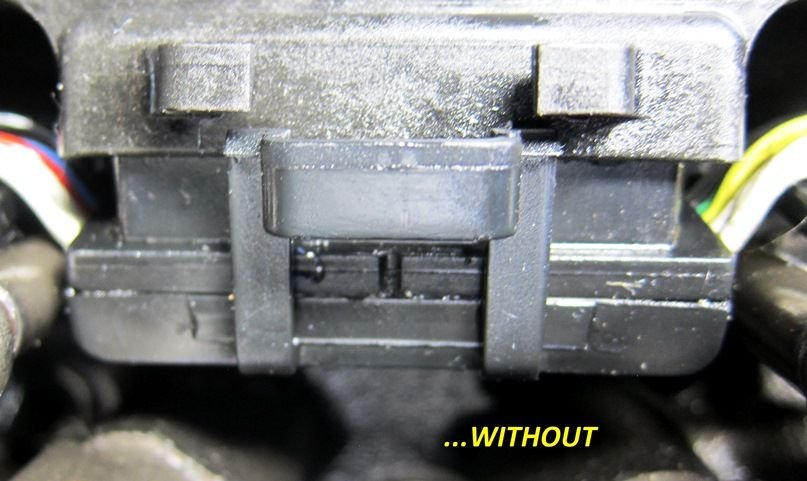

My 7.3L made it to 20 years of operation without ever having a valve cover pulled. All original glow plugs, injectors, UCVH, and no quarters.
When finally digging under them about a year ago or so, I thought for a minute about the original valve cover gaskets... if they should be changed or not. I ultimately decided to not fix what wasn't broken, and just address the well known fault that brought me under the valve covers in the first place... the harness connector had wiggled out a little bit. So I put the OEM designed shims ( 2C3Z-14A163-AB ) in place, popped in some new Motorcraft (from Ford) glow plugs, and kept the old original production valve cover gaskets right where they were.
The quality of readily available replacement parts has declined to such a degree that "old" often seems more trustworthy than new.
Here are what the factory clips (in lieu of quarters) look like:
Some 1998-2003 Econoline, Super Duty, F650/7550 & Excursion With 7.3l (engine Ser #0661894) May Run Rough Or Miss During Hard Acceleration Due To A Poor Connection At The Junction Of The Injector/glow Plug Harness & The Valve Cover Gasket. If Any Cylinder Is Identified By A Cylinder Contribution Test Or Is Suspected Due To Injector Performance Analyzer, Remove Valve Cover Gasket & Inspect The Connection Between The Uvc Harness & The Valve Cover Gasket. The Locking Device For The Uvc May Become Relaxed & Allow The Connection To Fail. A Retainer 2C3Z-14A163-AB Is Available To Install In The Locking Mechanism, Securing The Connection. If The Connection Is Not Secure, Install The Clip & Re-evaluate The Engine's Performance.

If you decide to use the OEM clips instead of the quarters, install the clips on the bench OFF the truck.
When I replaced my aging UVCH's, gaskets and glow plugs in 2018 with Alliant and Motorcraft parts, I neglected to install the clips off the truck.
After the second time the first clip flew across the head and landed on the towel covering the injectors and oil passages, I said screw it. I didn't want third time to be the charm with Mr. Murphy looking over my shoulder.
Quarters installed easily and securely. I chalked the $15 cost of the clips up to "lesson learned" and sent the clips to SJBJ so he could take a swing.
Choose your poison... Just be confident in your decision and revisit if things don't work out.

That's exactly why the shims come three in a package... even though only two are needed.
While I was able to install mine in the truck without issue, and still have the third shim remaining in the bag, I still remember that there were definitely some Ford technician complaints back when these shims were first released.
