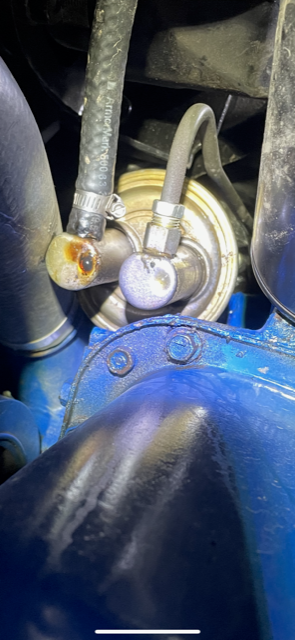

So after getting under it today installing a new steering stabilizer, I started the engine and was laying under it looking around and noticed some liquid dripping from a particular spot. I reached down to smell it and it was gas. Pardon my ignorance, but I haven't worked on many engines and not sure what the part is, but here it where it was coming from:
In this top pic it was coming out of the upper ring of that right side cylinder.

that is your mechanical fuel pump. it works via an eccentric on the front of the camshaft pressing down on the fuel pump lever.

That's your fuel pump. Maybe try moving the clamp up the hose closer to the pump. If it is indeed bad, just a heads up I just replaced mine in my 460 and I couldn't find a replacement one that fit right. Where the filter attached to it (mine was permanently attached) it kept hitting the oil pan on the block. I wound up ordering a Holley filterless one and had to put an inline filter in the hose from the tank to the pump.

I will try that later today. When I was under it yesterday, I didn't see any fuel coming from the hose itself, it almost looks like it was running down the side of the pump inside from the top, or a crack in the metal somewhere. This had a 429 swap in it and I've been trying to find some all morning. Is there anyway to tell the difference between a 429 CJ and SCJ without ripping it apart?
