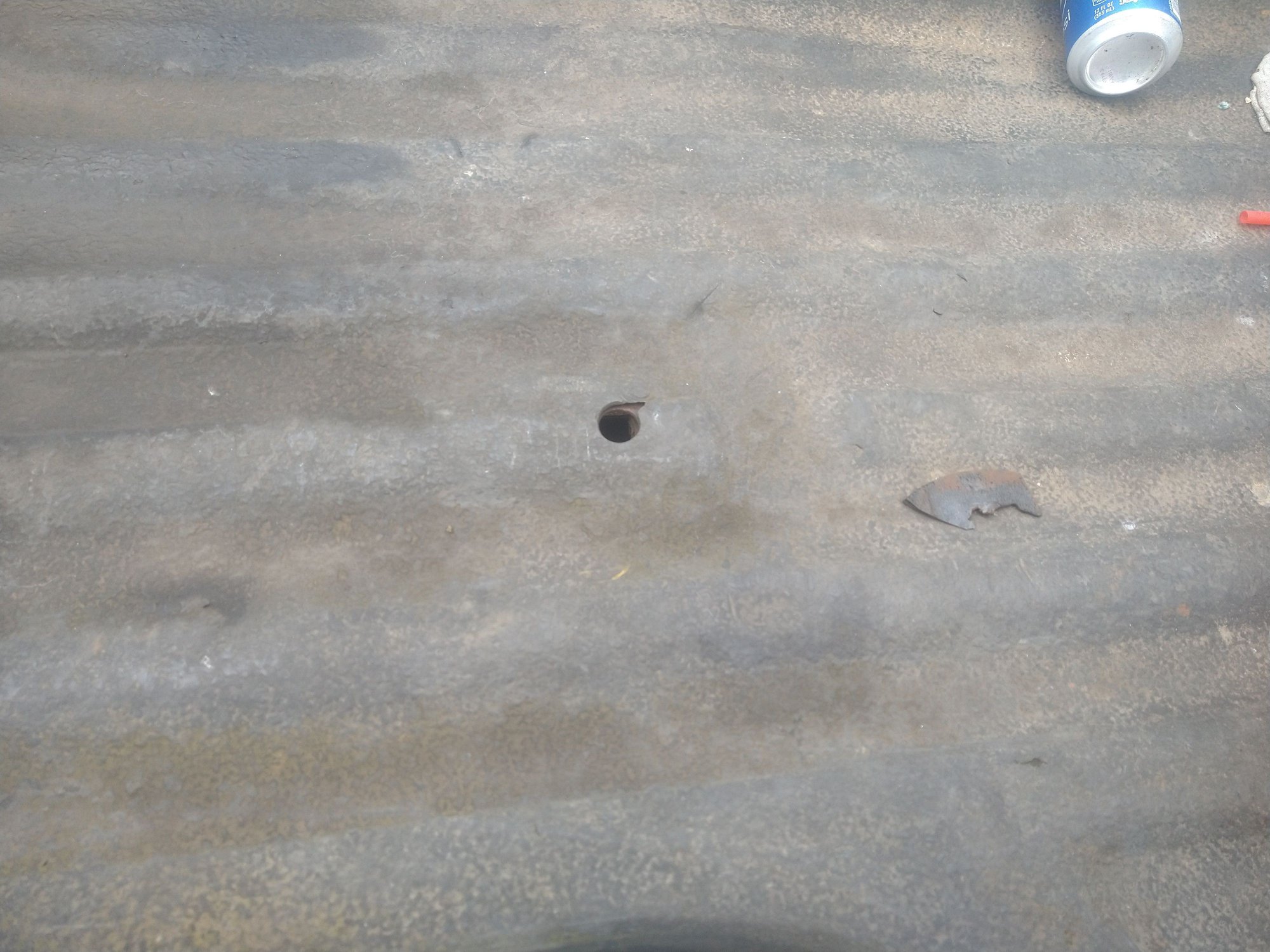

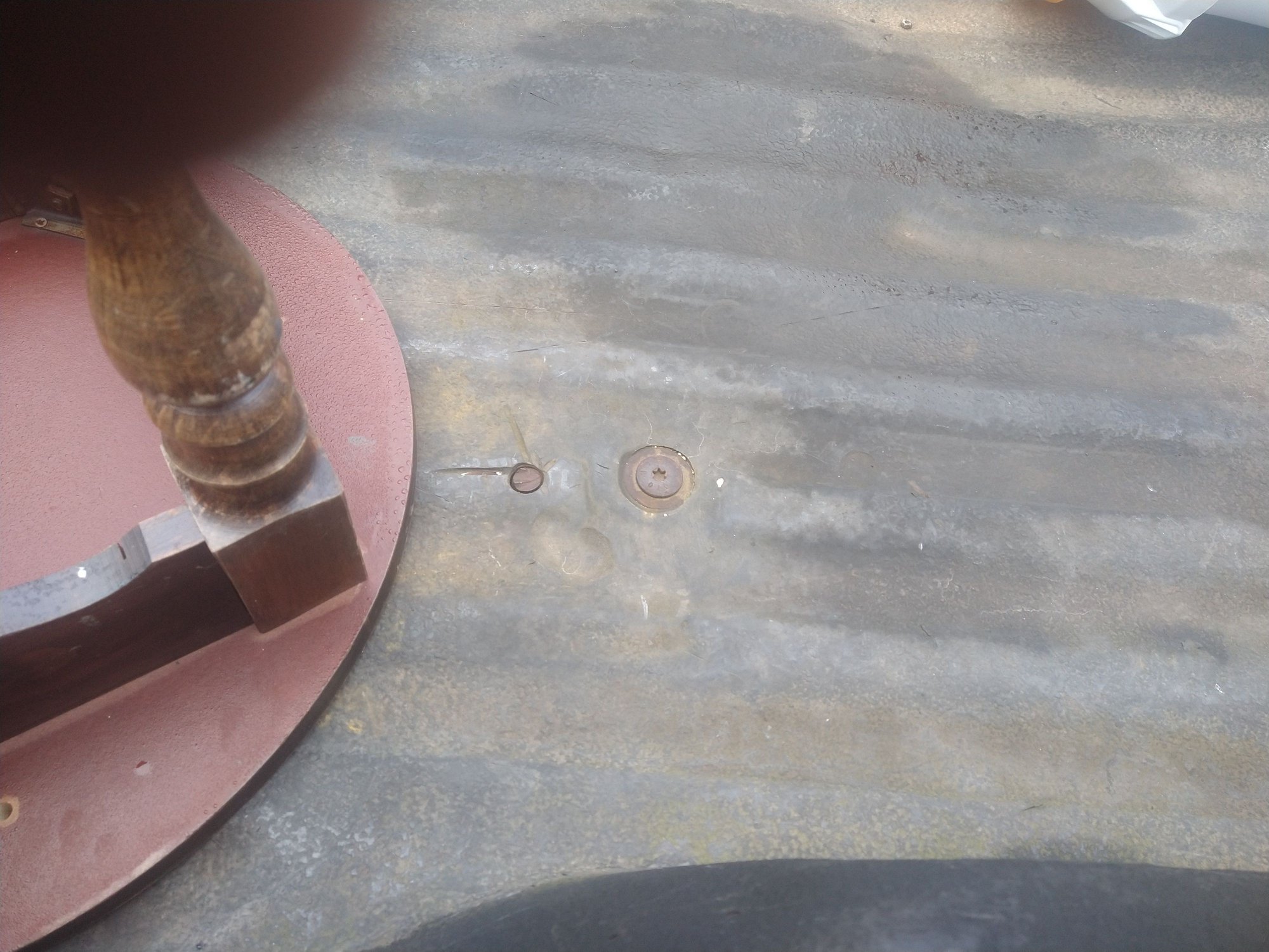

Here's a couple pictures of what my truck has on it right now.

Looks like there was at one point either an aftermarket gooseneck hitch or 5th wheel rails in there with those brackets on the side of the frame. But with the rails gone you're probably starting from scratch if you really need a 5th wheel. A gooseneck ball is less hassle and you can usually adapt a 5th wheel trailer to a gooseneck ball with parts from e-trailer or a local dealership that sells trailers.

I believe the rails are still there. They are just an aftermarket under bed design. Also, I did not know that you could adapt a fifth wheel trailer to fit on a gooseneck. If I had known that I would never have even brought this up. I would much rather have a gooseneck that I can flip upside down into the bed like the one that FTN posted earlier. That looks like a nice gooseneck. I sure would rather do that. Really I don't want to have a big fifth wheel in the bed if I don't need it. As you said, goosenecks are so much easier. I we'll look into adapting a trailer to A gooseneck. Thanks for the input!
Edit, my truck does not have rails on it. The brackets after a 90° turn only go about 2 inches in from the frame until they stop which is where the mounting holes are. Also, is this the kind of thing you were talking about? https://www.etrailer.com/Gooseneck-and-Fifth-Wheel-Adapters/Andersen/AM3100.html

Those look to be the under body tabs off your frame rail mounts. The Rails are universal as far as the spacing for the hitches to mount up. What I'm not sure about is their mounting holes for in the bed. Not sure if those are different. I can measure the hole spacing on my rail mounts for you to compare. If you are lucky, all you would need is new rails that would mount into existing setup. If not, it isn't hard to install a whole new rail mount setup if that is the route you choose.
