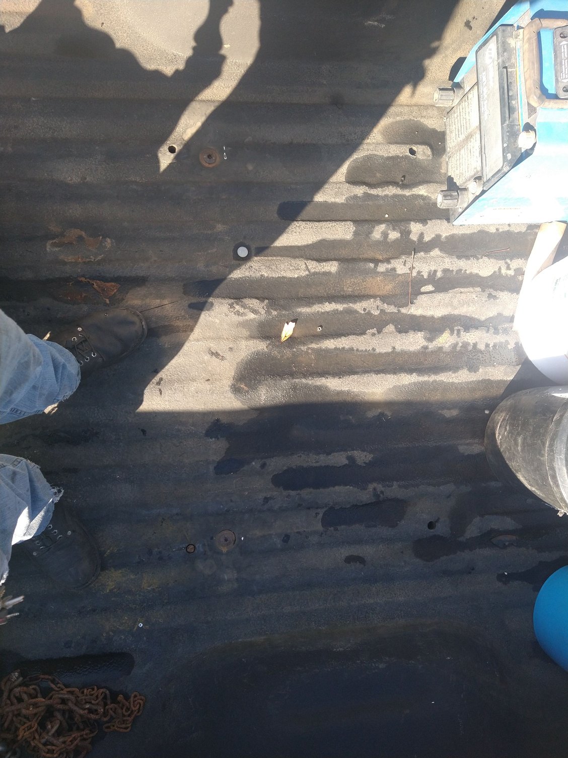

take a better picture of the TOP of the bed to show what the orientation of the holes looks like. If there were 5th wheel rails installed before then there will be 4 holes....one at each corner making a box shape in the bed. (A mounting point at each end of both rails.)
If in fact it was, that was kind of stupid to take the rails out and leave the frame brackets. Usually that all comes together in a kit. But you might be able to buy the rails separately and the hardware kits can be found on ebay or Amazon.

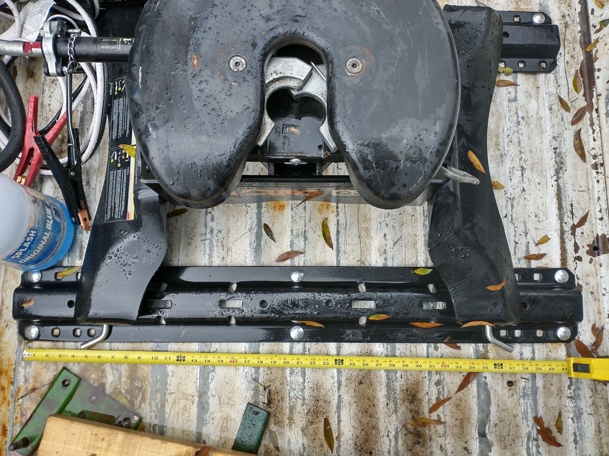

Originally Posted by Hyakkimaru
35 inches apart from side to side in 22 inches front to back.
That's what I figured about the rails having to sit around the same area.
My Curt rails are 40.5" across. That's measuring the bolt holes. There is a mount hole that can be used that gives the spacing of 22" right on the money. I am on the other side of the bed rail making slightly longer but would still bolt in giving the correct distance. Measuring the available unused holes across the hitch It can be bolted in at 37". If you have elongated holes in the top of the frame mount it might fit.

A couple pictures.

A couple pictures.
Based on the pictures that your rails have, it looks to me like you would need eight bolts instead of four correct? Two on each end of the rail? I only have four holes in my bed. Do you reckon it was for a gooseneck plate?

Here are some pictures of the bed from the tailgate.
Only 4 bolts for the one pictured. The other bolts just go through the bed and tighten onto sheet metal. More for looks.

Looks like the hole near the tape measure had the bolt break off so that might be a fun one to get out, but yeah all you’d really need is a pair of rails and a hardware kit to be back in business. If there was a trailer shop nearby I’d be very tempted just to let them fix me up. If the guy who owns the trailer has a 5th wheel hitch he can let you use that would be ideal but they’re not hard to find used for a good price on Craigslist.
