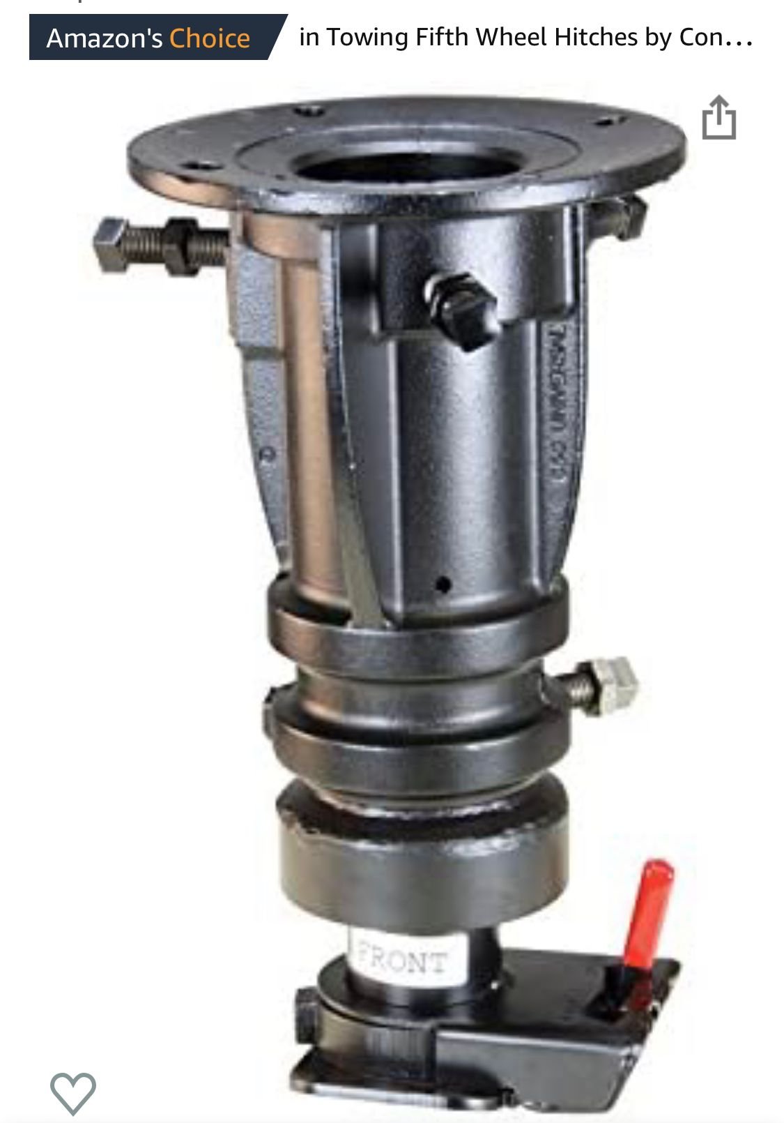

Edit: I think I figured this out after using Brokestroke’s link. He shows an adapter designed to go onto the fifth wheel trailer itself (I assume in place of the other hitch style) and hook to the ball like a normal gooseneck. I can see how this could cause incorrect stresses. I’m glad it worked well for Brokestroke though.

Get a 5'er hitch and one of these. Both share the same rails
Amazon Amazon
