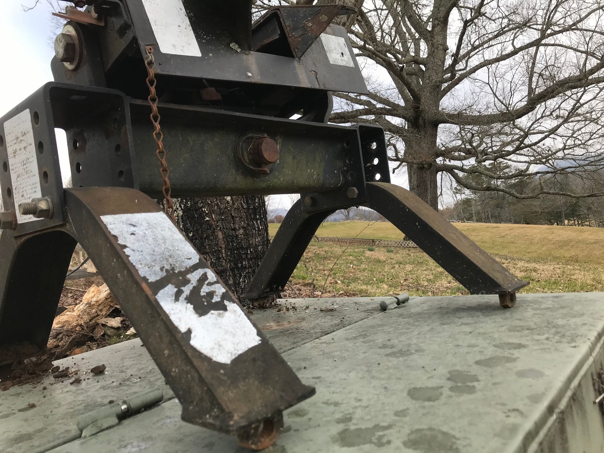

This is a ‘conventional’ universal 5th wheel hitch with rails. Mine is on a flatbed, so frame attachments are a little different. Don’t mind that missing fastener, I haven’t towed a 5ver for a few years....
The one I posted a pic of earlier would have brackets that use existing holes in your frame and you’d drill holes through bed similar to what you have now.
Older 5th wheels (1990’s and older) typically do not have as much height from the ground to the part of trailer that goes over the bed of the truck. Newer trucks tend to have higher (from the ground) bedsides.
You want the floor of the trailer to sit ‘level’ while towing to evenly distribute the weight over the axles. Your ‘lifted’ truck may make the front of the trailer sit higher. This causes the trailer to pull uncomfortably and be less stable. It can also cause clearance issues where the bedsides can come in contact with the trailer when going over uneven terrain - damaging truck and trailer. People often give the camper a ‘lift kit’ by flipping the axles under the leaf springs to address this problem. I had to do this to my last 5ver. This pic is from ‘before’ axle flip.

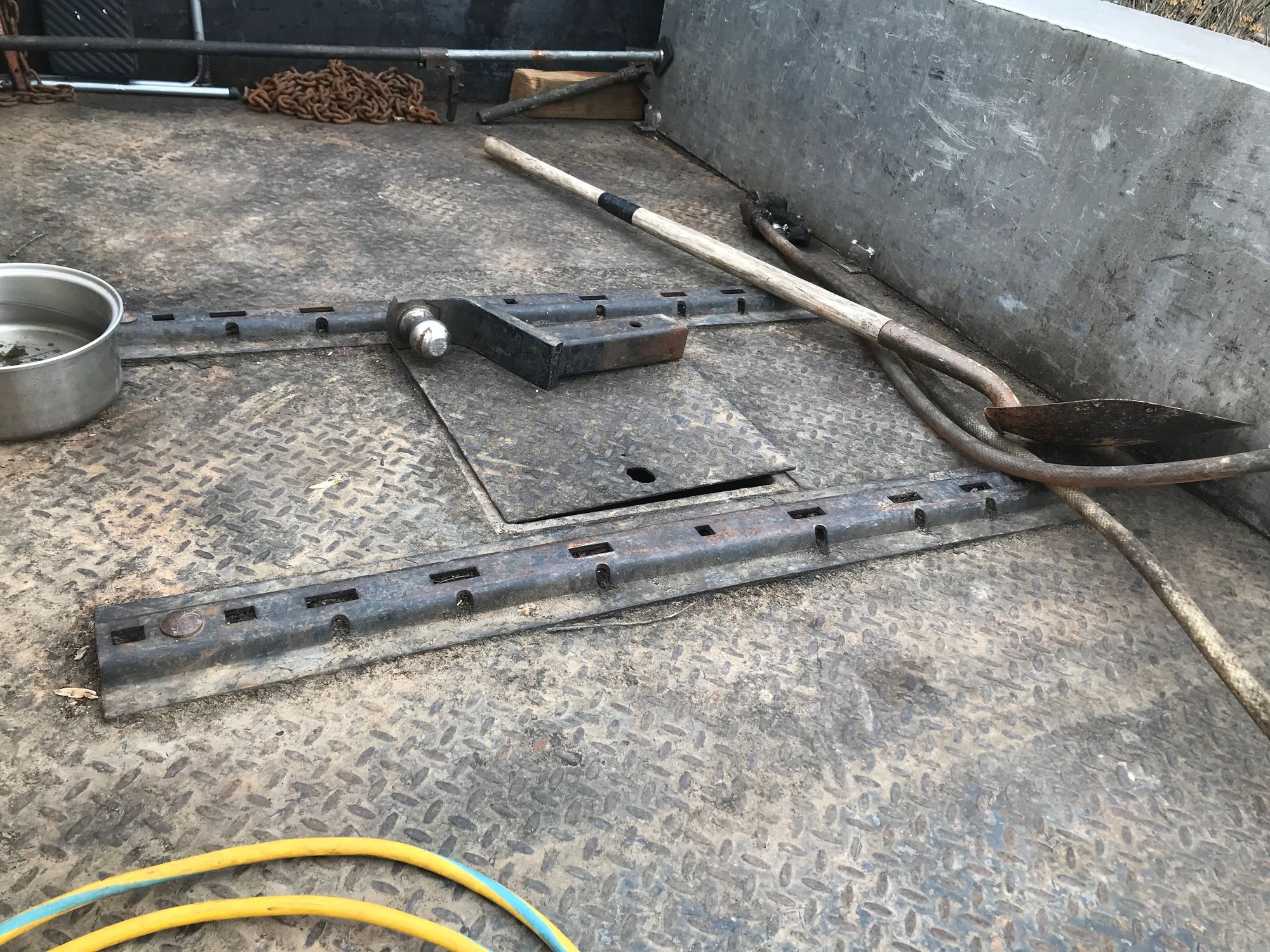

You can certainly do it yourself but you'll need some hardware still. If you have a local Fastenal store they'd probably have what you need. They are usually 1/2 inch grade 8 carriage bolts that ship with the rail kits. Zinc washed would be nice but not required and you'll have to figure out the length on them. I'd use a flat washer, split ring washer and nylock nut if they have them. Use a good torque wrench because they have to be torqued properly...not too loose or too tight. Important because these are basically the 4 bolts holding the trailer to the truck.
Here's a hardware kit you can buy as a package...maybe you need those half moon spacers too. Read the directions especially the torque specs.
