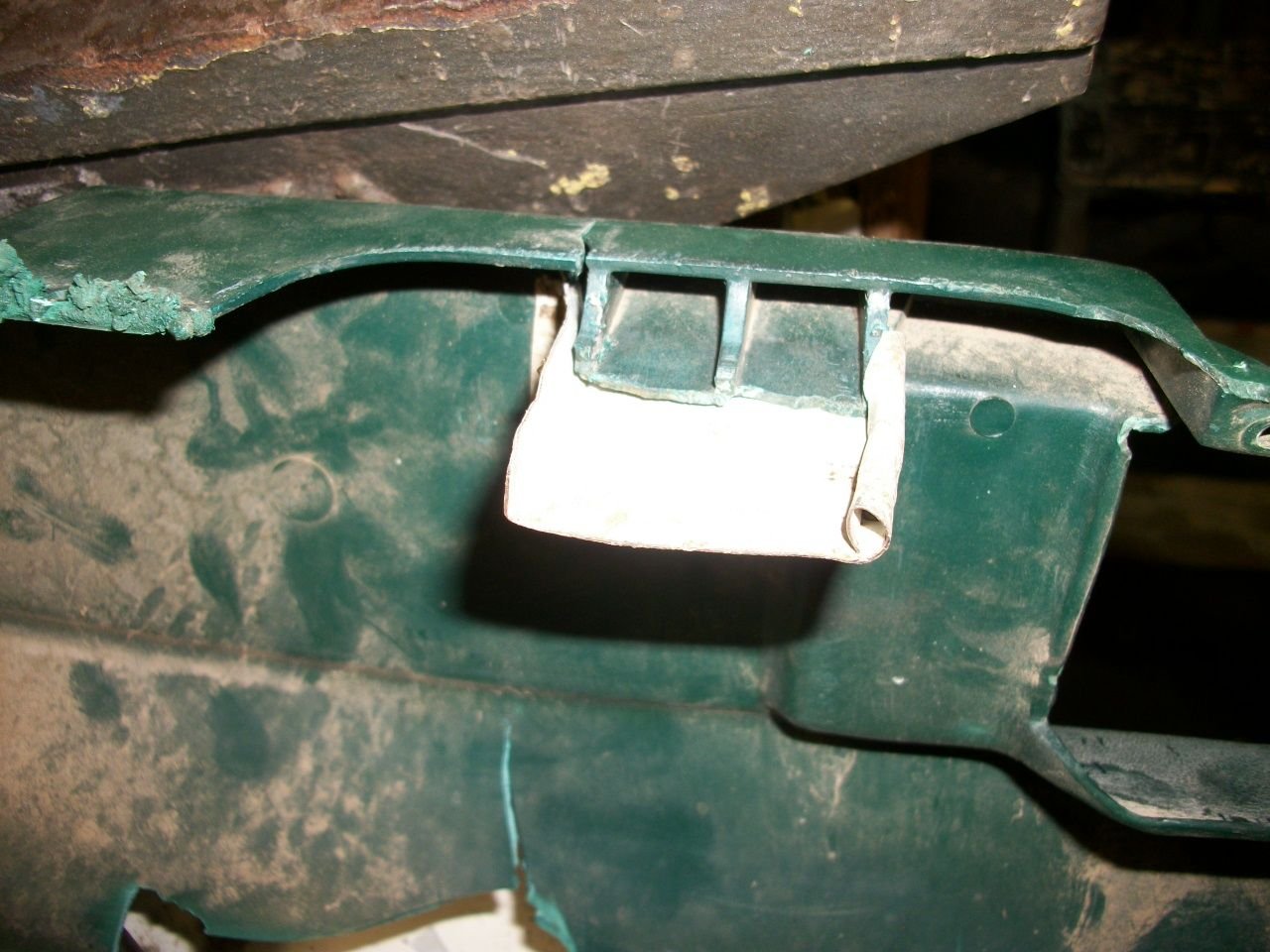

You can use the OEM metal clip or the plastic push pins on any 73-79 door panel. You can source repop metal clips from most vendors. Once the door panel is off, remember to lube your window track and regulator. And you can Dremel notch (2 places) behind and no worries they will be covered by the arm rest. The 2 notches let the door panel fit tighter to the door. The door handle L bracket 2 bolt heads stick out and against the door panel that is the reason to notch. Also JB weld or 2 part epoxy reinforce the areas the pin slip into.
I have saved some mangled door panels over the years.
The notches and a metal over lay to help the broken tab that fits under the finger cup.
Loose finger cup screws an result in this, also using the door panel finger cup as a climbing point.
Metal over lay reinforcement.
I made another one that even wraps around the L/H edge. JB weld them to the door panel.
