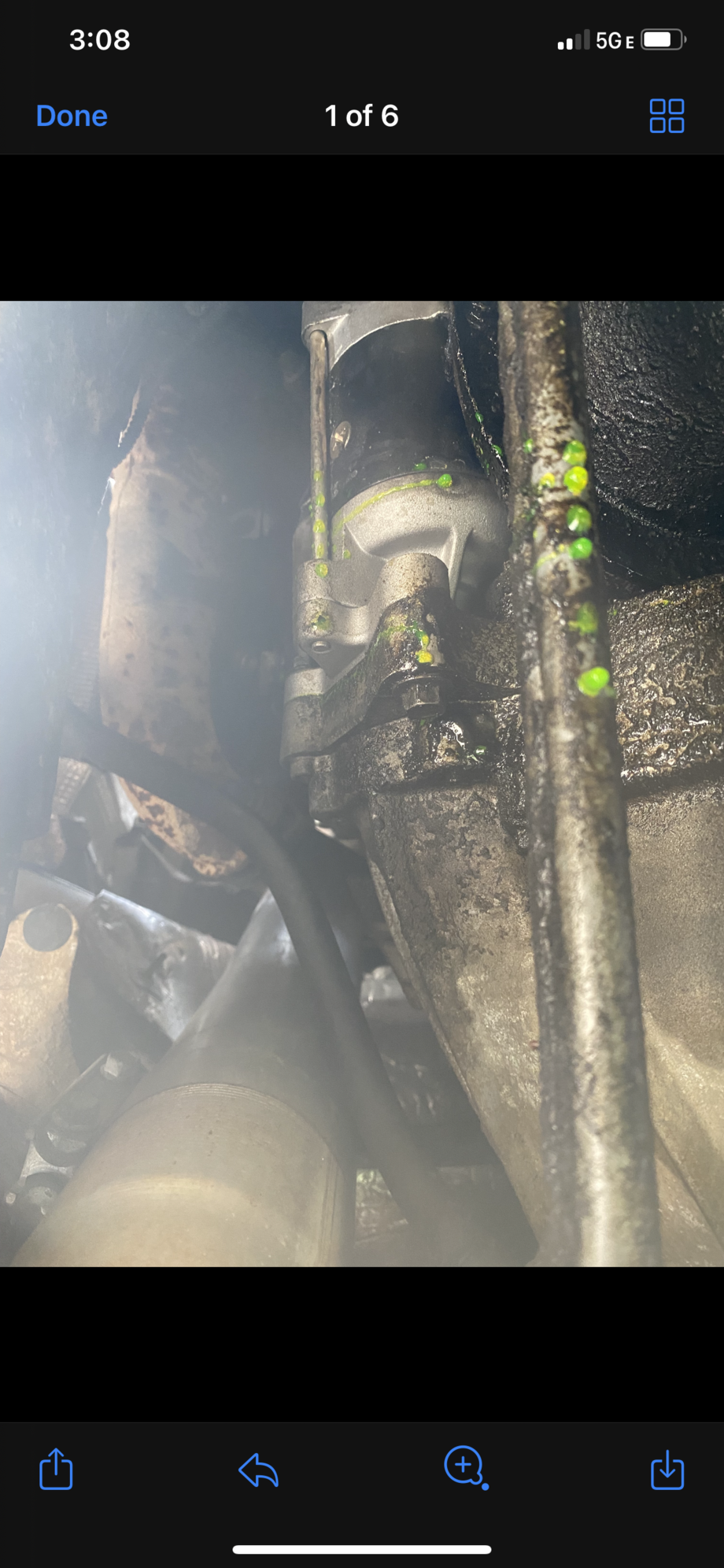

My dad just sent me this picture. Used dye to help
Old Feb 8, 2022 | 02:52 PM
MisterCMK's Avatar
MisterCMK
Joined: Mar 2003
Posts: 24,724
Likes: 74
From: Blue Hill Township
Look in the valley. Gravity is bringing your coolant down.
