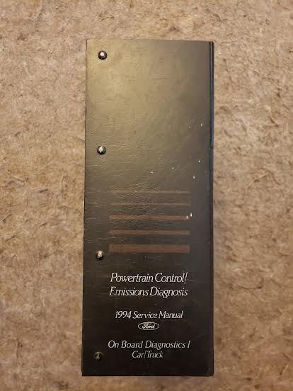

Does anyone know where I can find a wiring diagram of the PCM plug for my bronco?
Old Feb 17, 2022 | 04:25 PM
manicmechanic007's Avatar
manicmechanic007
Joined: Jul 2020
Posts: 10,582
Likes: 2,678
From: Near Salt Lake City
All Data at the library for free
or A PCED book you might find like this
