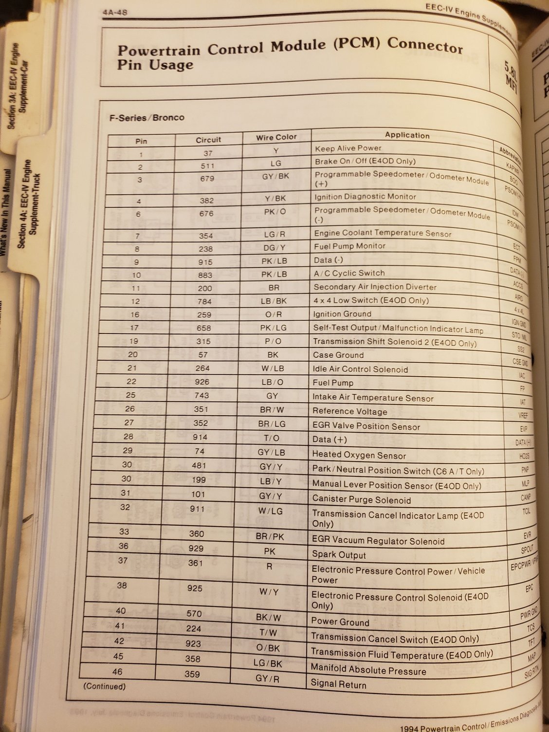

This is what will be on AllData the Ford pages out of the PCED

Thank you for the photos of the service manual.
I've been considering Conanski's comment about getting a 5.8 vs another 5.0, and I think it makes good sense. Does anyone know what type of compatibility problems I'd run into in terms of being able to use my original transmission (5sp manual that was recently rebuilt), exhaust manifolds and Y pipe, EFI system (assuming I don't harvest the EFI from a donor vehicle), PCM and wiring, etc?

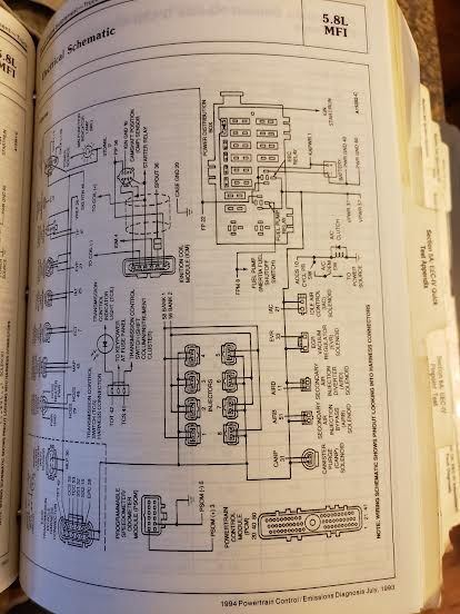

That 94 book is similar if not the same as your 1990
Want me to post some of the 5.0 pages?

Yes thank you, I'd love to see the 5.0 pages, including the map that diagrams which pin is #1, which pin is #2, etc.
