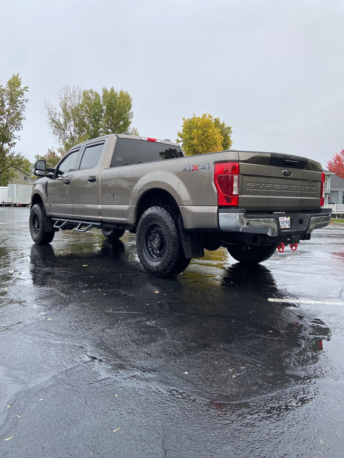

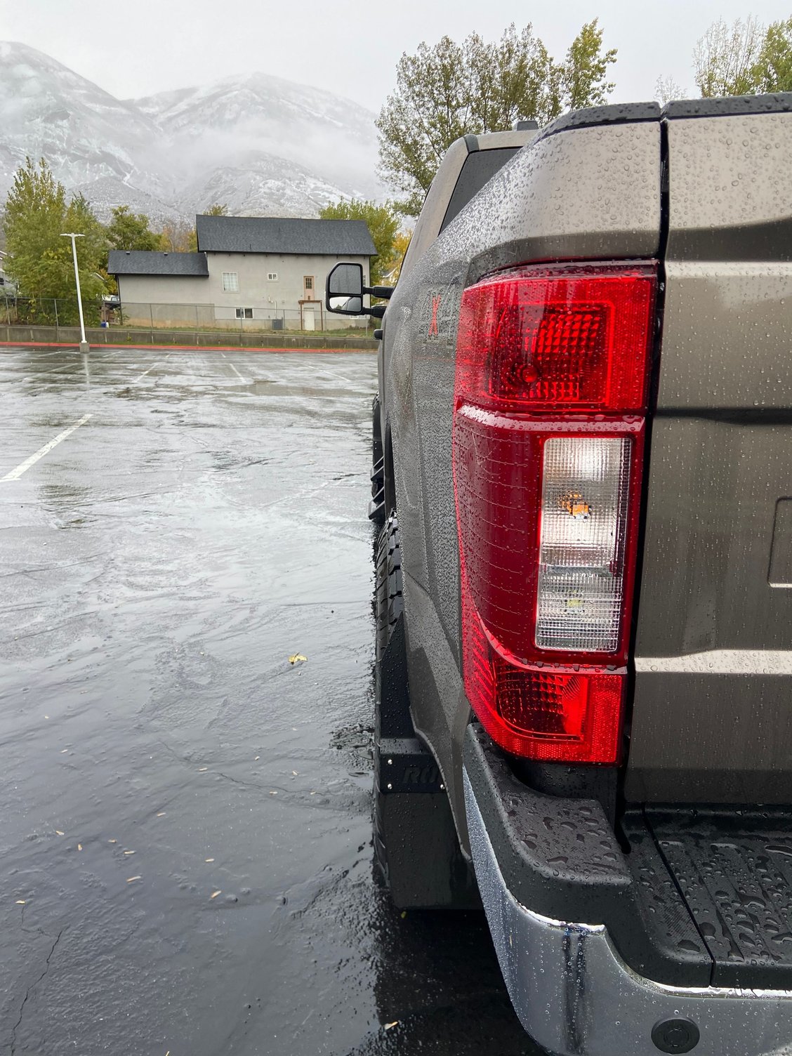

My wheels are 18x9 +12 offset and they stick out about 1/2-3/4”. 37x12.50 tires. They stick out just enough to make my truck extra dirty when it’s wet out. If I did it again, ide look for a +20 offset.
