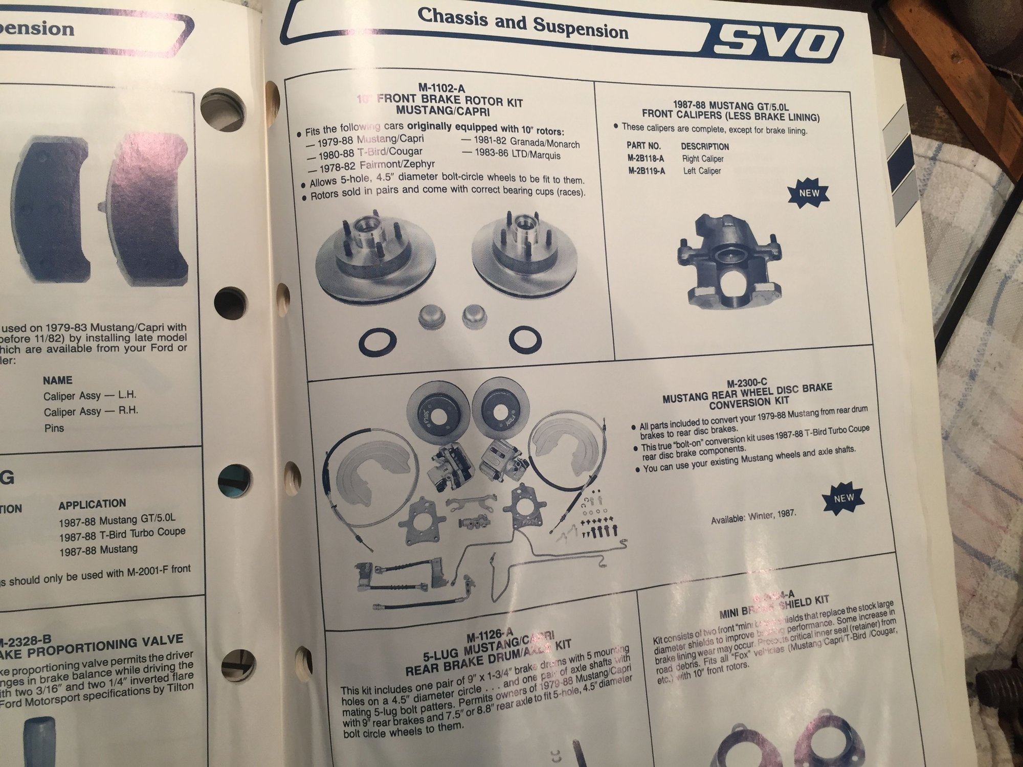

. I have a kit from the late '80s out of a Ford Motorsport catalog that used calipers from an '86 SVO Mustang that uses the same F150 parking brake cables and proportioning valve. It came with rotors, like Mike mentioned, from a late '70s Lincoln that were machined to fit the truck lugs. I would suggest searching the Mustang forums for something similar. I also had an '88 Thunderbird Turbo Coupe with this setup. You still may have to machine lug stud holes in a rotor with the smaller diameter pattern.
This is not the one I used but is pretty close.
