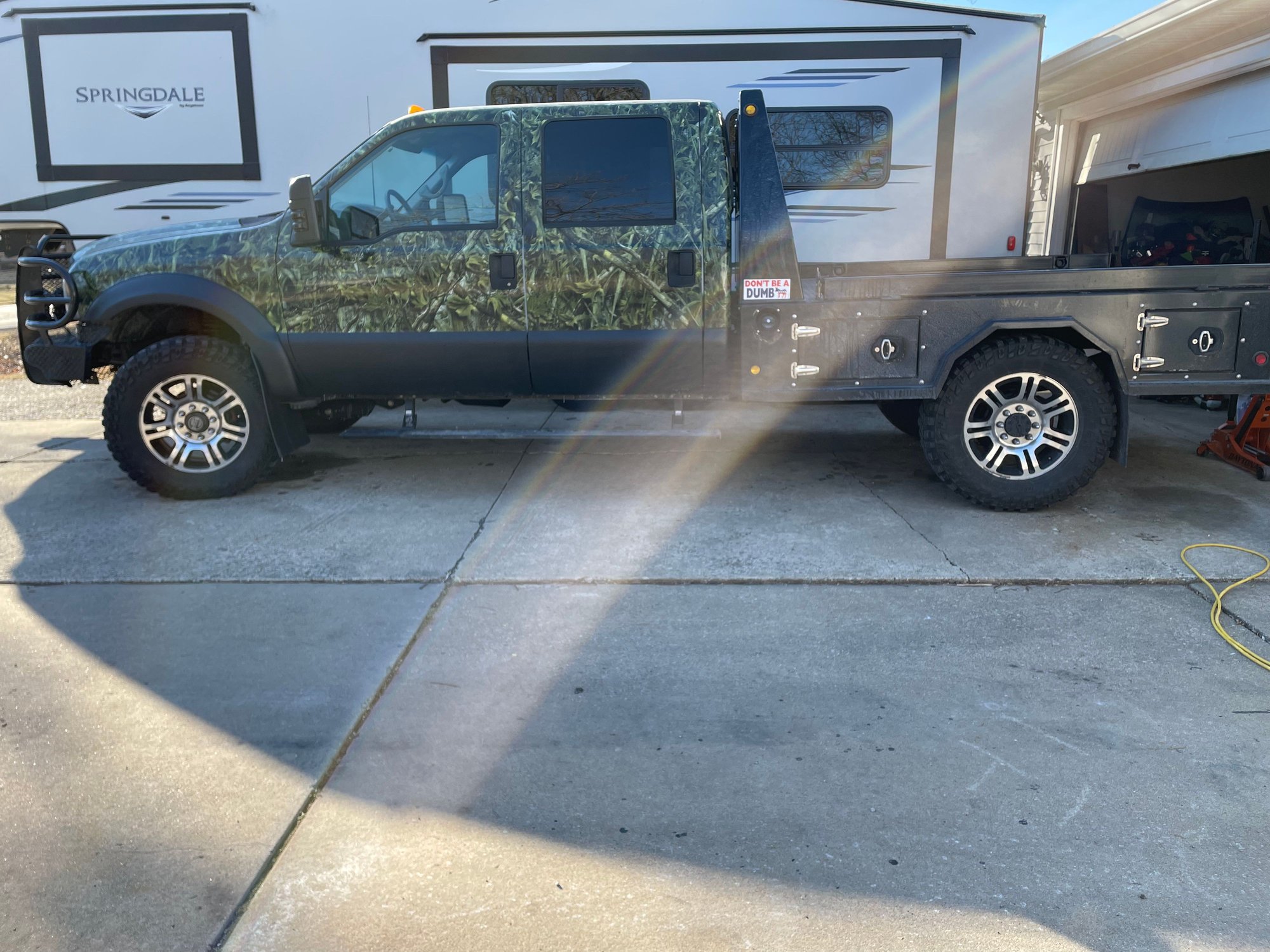

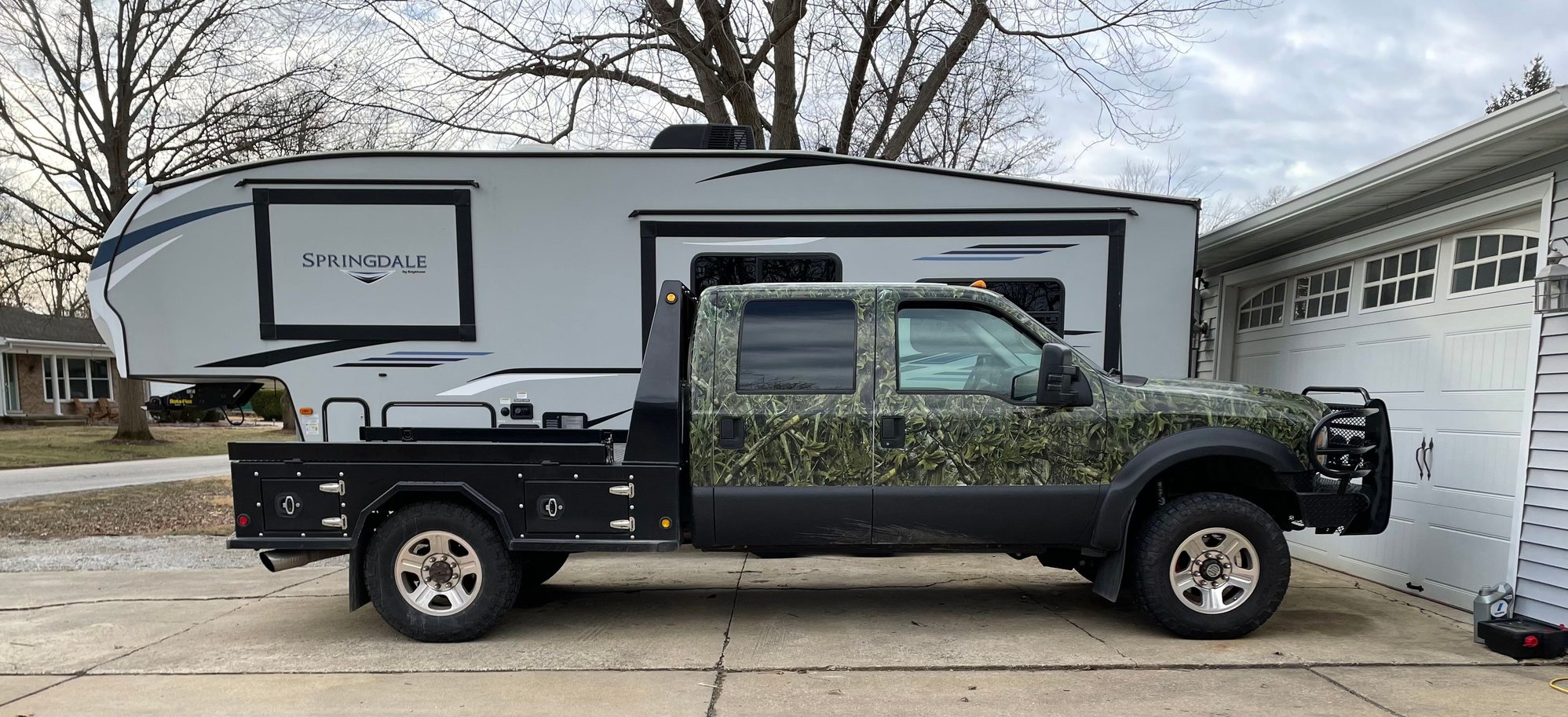

Got new pics with my bigger tires, first pic is with 1” more rear lift, second is just sitting as is. Supposed to talk with Jeff at deaver tomorrow to see what he can do.

Yeah those Coopers look kinda crowded under there. I know I don't have a pic since the shackle flip so I'll try to remember to snap 1 tomorrow.

Other than to the rear the space for the back tire has a fair amount of space, all it would take to move the room is to cut off a mount for the close mud flaps. The 37s look good but I’m torn between them and a set of true 35” tires when I’m due for new tires. Even my 34s look crowded when hooked to my 5th wheel, but nothing a set of air bags wouldn’t stop which will be added when I change the springs anyways. I tried getting pirate to take a look and give his input but no dice yet.

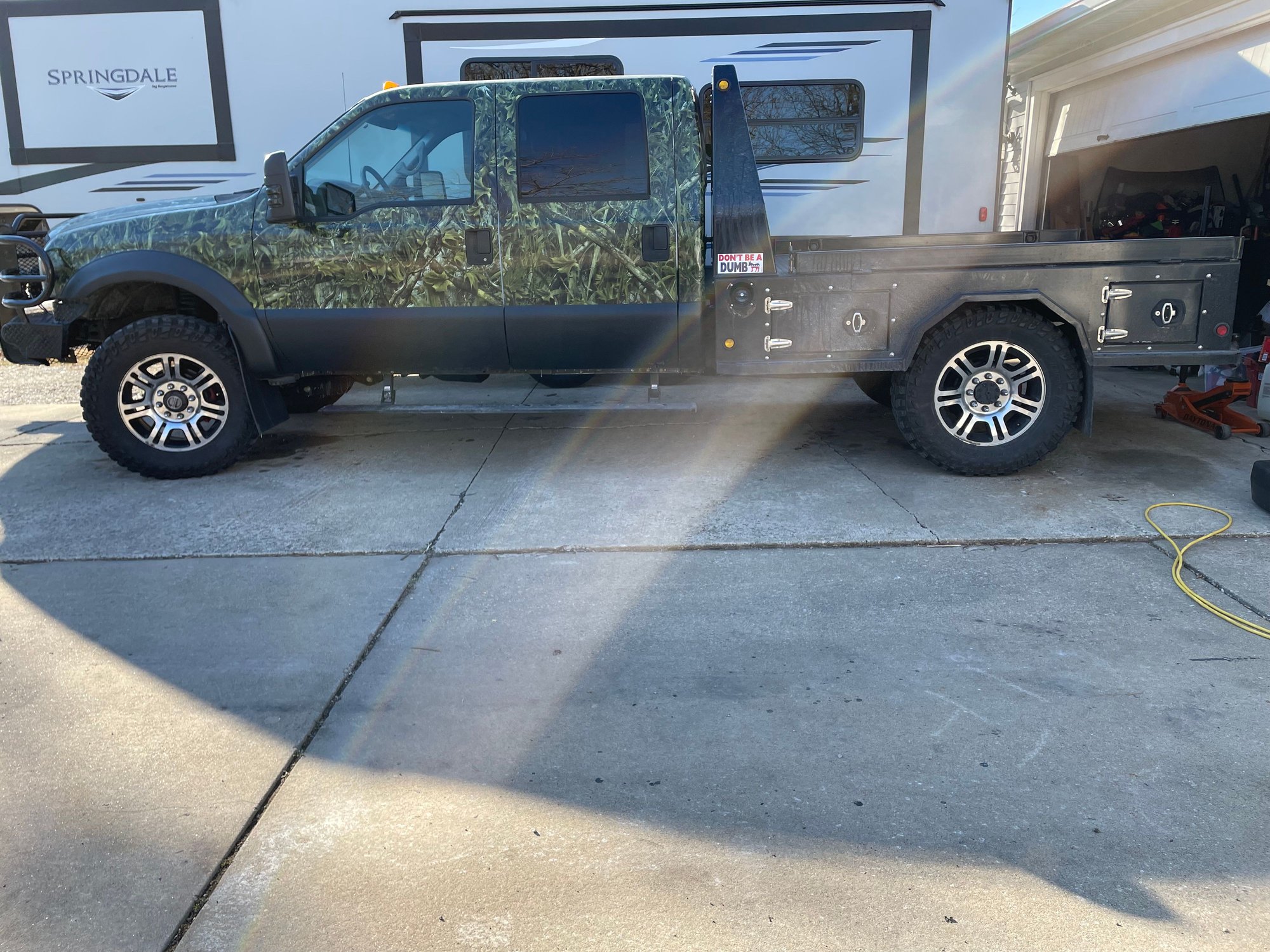

Didn't remember until after dark but I get those pics for ya. Here she sits on level ground w/ 235/85r16, leveling springs up front, 4” lift springs no blocks w/ shackle flip rear. Her average day running around wt is right at 10k.

Cool, thank ya. Did it sit pretty much the same before the shackle work? Mines sitting about 9k, the bed is empty most of my driving. I’m definitely looking forward to some softer riding springs after today. I purposely chose to drive down one road faster than normal and it was miserable, another one on the way to a friends house was terrible even at 20mph. Illinois roads are terrible.

No it had a noticeable rake to the rear. I gained around 2.5-3” flipping the shackles. The math works out to about 1/2. So if you change the shackle 4” you'll see 2” of lift.
