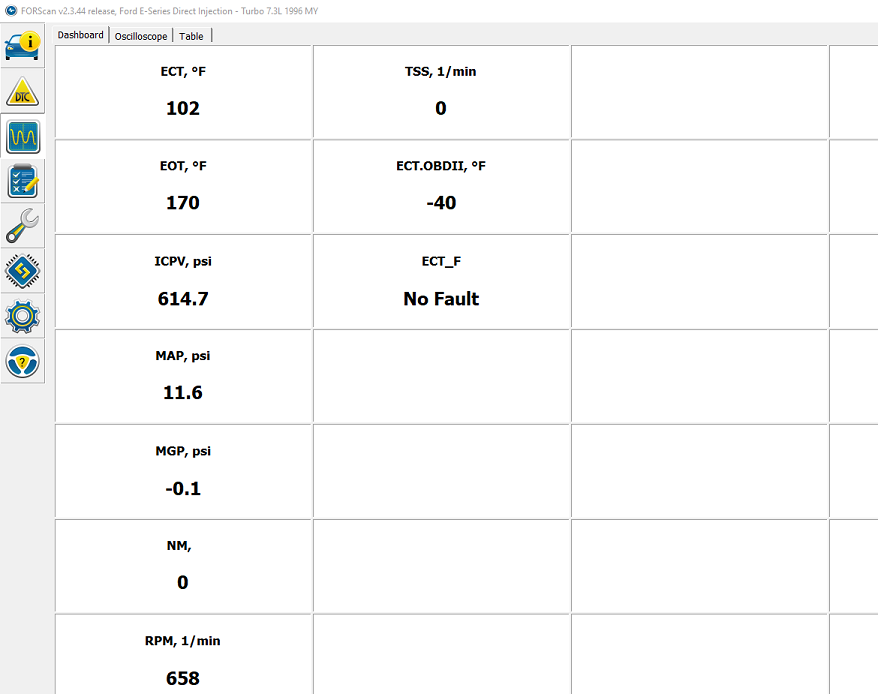

I'm wondering if the numbers I'm seeing FORScan report are considered "healthy" for a completely bone stock cooling system.
This was after driving for about 40 minutes, mostly cruising around 60MPH with a couple short WOT runs from 40-70MPH. Ambient temp was around 30F outside.
After getting home, truck was idling and I took this screenshot showing an ECT of 102F and an EOT of 170F.
That delta of almost 70F seems like a lot, I'd think the coolant should be helping lower the engine temps a bit more, but maybe there's a bottom threshold where the EOT just can't get much lower?

The oil coolers on these are not as efficient as one would hope. I would see 210 -220 easily in summer eot.

There is no coolant temp sensor on our OBS trucks, so that PID is a fictitious reading.

Interesting, I wonder what sensor/input they are looking at for ECT then? Maybe FORScan is estimating based on several data points?

Its looking at engine oil temp.

EOT is already up on the FORScan dashboard at 170F, so the ECT seems to be something else. Plus I doubt the oil temp is only 102 after 40 min of driving?
