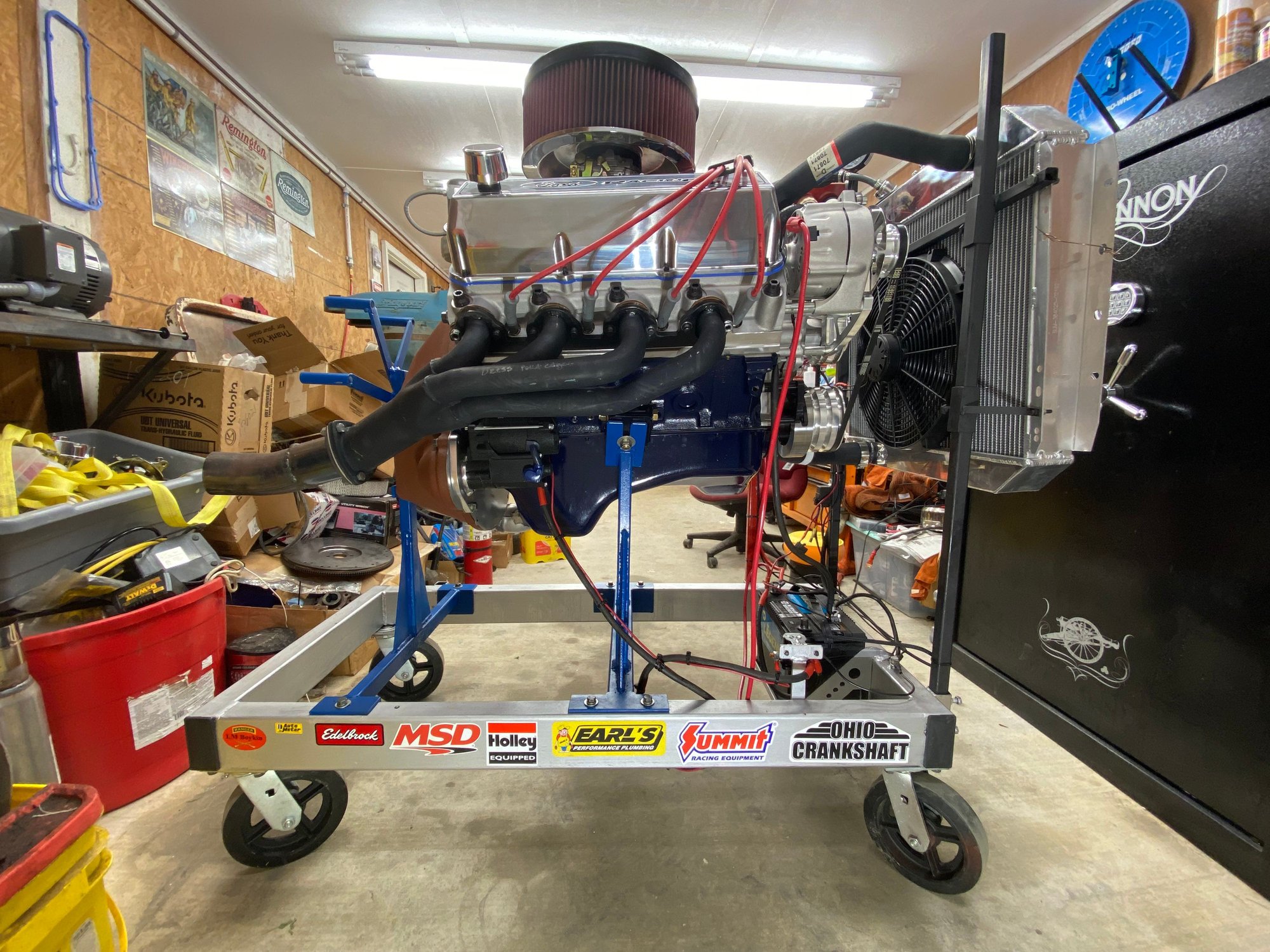

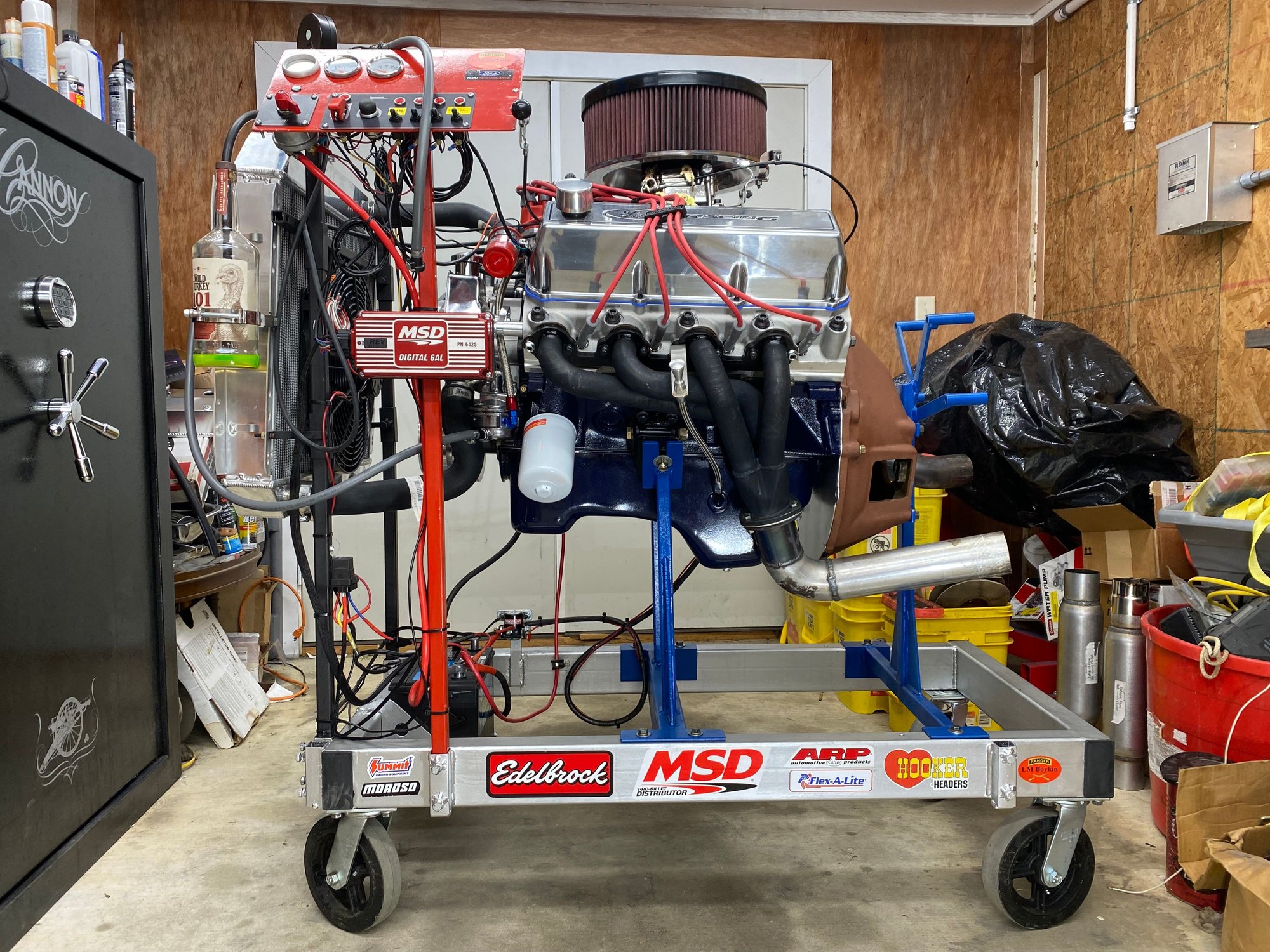

These are L&L 79750HP. Engine is going in my '79 F150 4wd, with T18. You'll have to have custom exhaust. I've never built an exhaust system, but I'm confident I can do it, and do it well. I cut and welded pre-bends that are on the header flanges. Easy enough.

@ranger140892 First off, thats an absolutely beautiful build! But L&L is what I've seen most people saying for these trucks so that might be the way I'm going. On a side note, is that the original oil pan or replaced? I cannot find a rear sump pan to fit this engine with the 4x4. If its "aftermarket", would you mind sparing the company? thanks!

Sweiss, thank you for that. I enjoyed building it, and enjoy running it on that stand. It's gonna be a sad day when I hide it under the hood of the truck.
The oil pan is new, but a Ford part. It's what all the smart guys recommended to me for Dent 4wd, and for Fox body swap. But now that you say that, I don't personally know that it'll fit since the engine is still on the test stand.
https://www.summitracing.com/parts/f...a460/make/ford
I do know that you'll need to enlarge the four corner pan bolt holes in the pan and the gasket. It was a simple task. Use a Step Bit. Late model engine blocks must have all same size pan bolts, where older blocks have two sizes. The oil pan came with one piece gasket, oil pump pickup w/ main cap bolt, and dipstick and tube. Everything but the fasteners. I did not use the dipstick and tube because of header interference. I went with a Lokar flexible setup. I made a stainless bracket to attach the dipstick tube to a header bolt. The gasket is high quality steel core with compression stops. Since all the good one piece gaskets now have compression stops, I wanted oil pan support rails like what you see on later 5.0 / 302 oil pans. I couldn't find any, so I made a set. They work very well. No oil pan seeping.

Sweiss, a couple of little side notes on those headers. They're high quality. I did clean up the mating surfaces on the flanges a bit, but that was probably not needed and maybe even a mistake. I used dead soft aluminum header gaskets, which I love. No leaks!
And we all know that long tube headers tend to make more torque in the lower RPM ranges, which is where I drive. My engine is a 502", and will probably twist a driveshaft right off idle, but I'm not opposed to swapping in long tube headers once the engine is installed, and I can estimate clearance.
