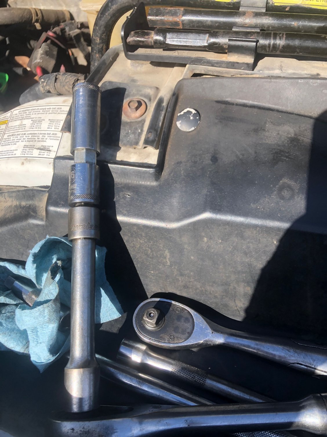

I had 3/8’s male pipe plugs and this set up worked like a charm! Picked up what was basically a long nut meant for all-thread, and put the back end of a 3/8’s socket on the plug and it came right out. 4 dollars at Lowes for a 2 pack versus a 50 dollar pipe plug socket kit. Could have been happier.

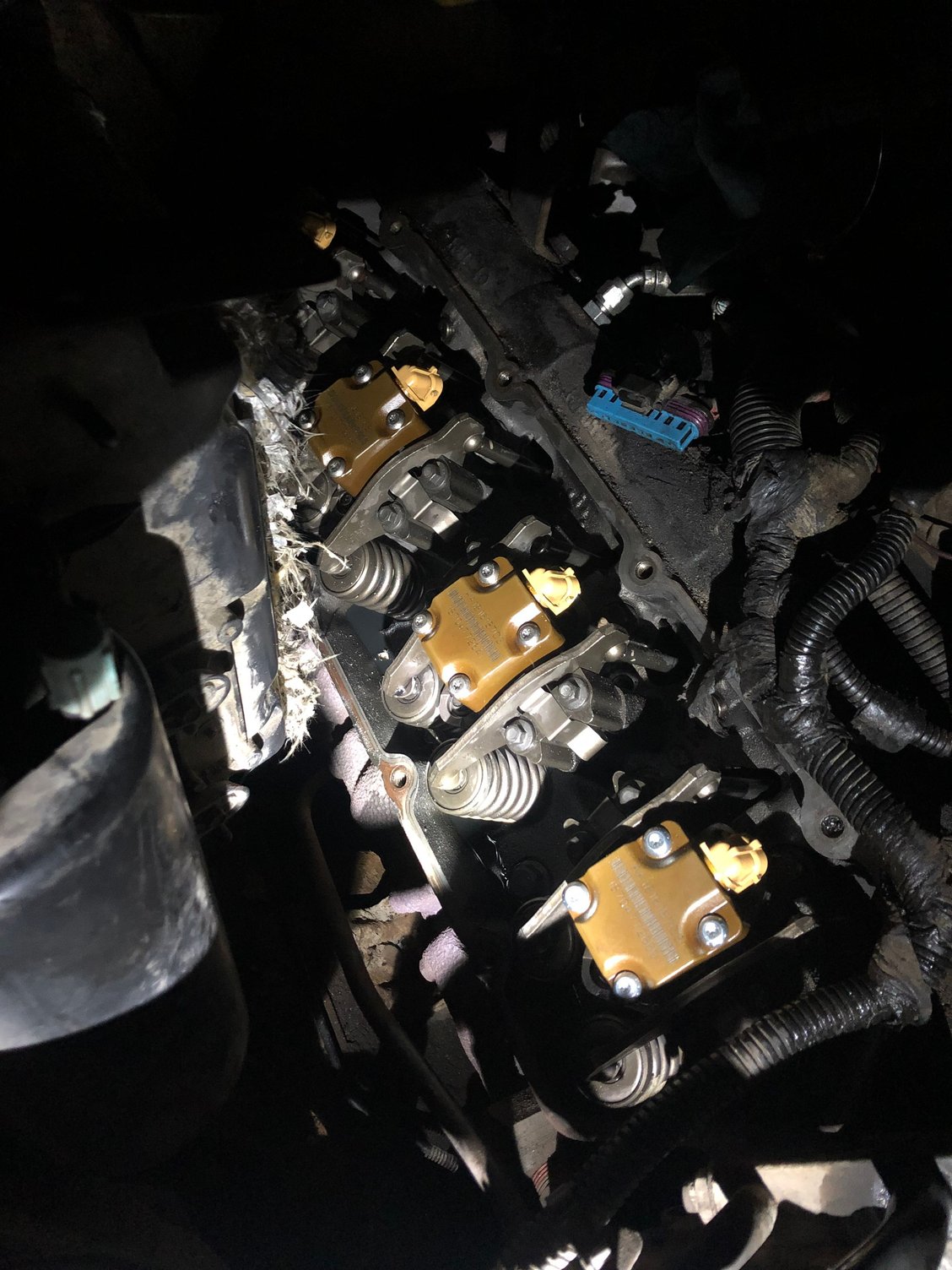

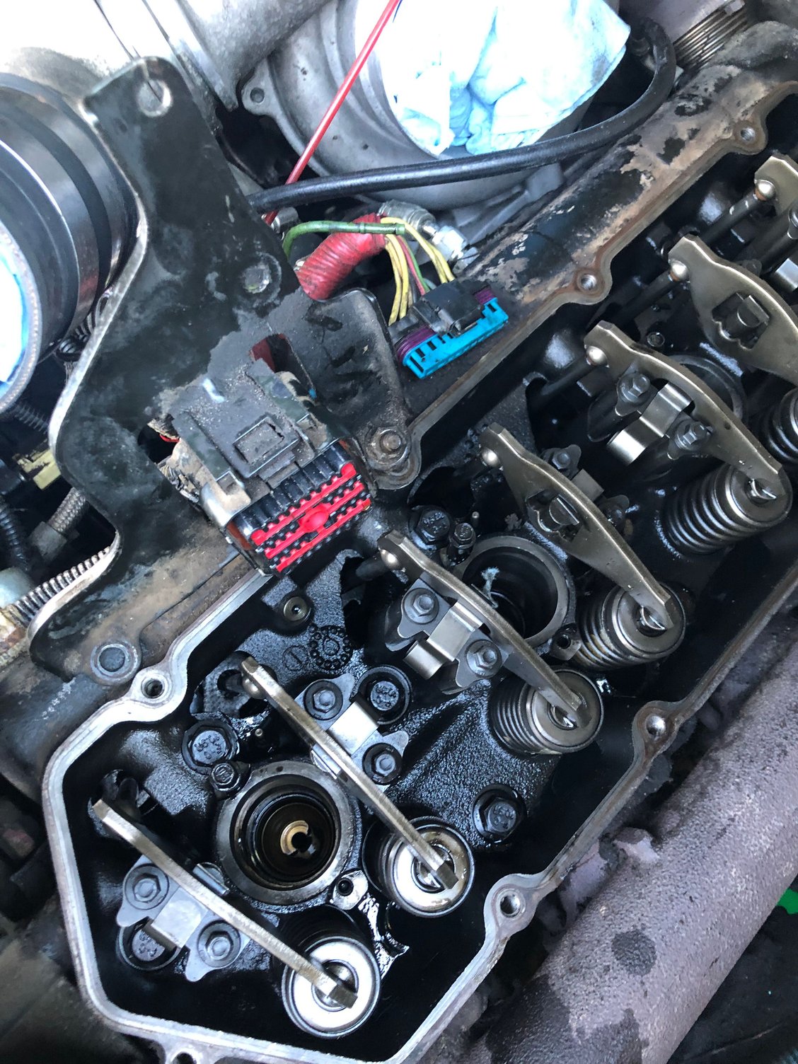

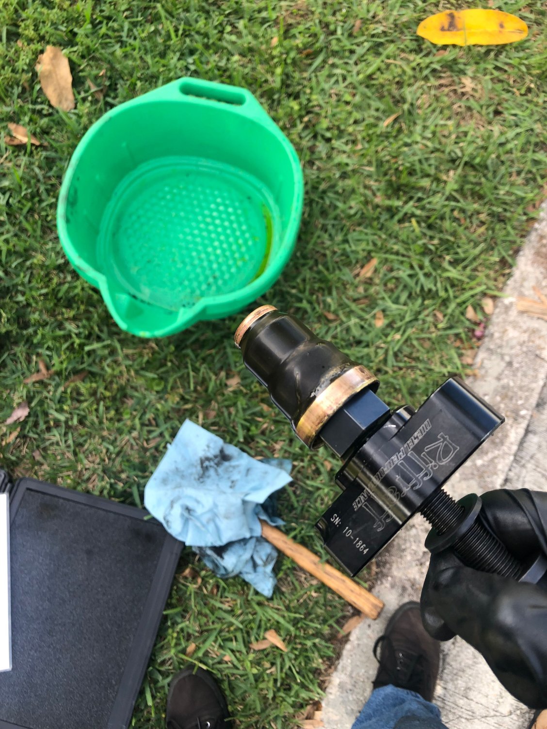

All the cups are removed and currently have half of my bores are cleaned. I was super impressed with RiffRaff’s tool. This made it the easiest part of the entire project so far. I used the penny trick to keep out the shavings.
Planning on cleaning the rest of the bores after work today and then using loctite SF 7649 to clean the new SS cups and inside of the bores. I know it’s not required now but I already have it, and I don’t think the extra precaution will hurt. Thanks Everyone!
This tool made the removal process very simple
Bores right before I pulled the sleeves

Agreed. Just did injector cups in October and the RiffRaff tool is where it’s at! Nice work. Did you find any cracked cups?

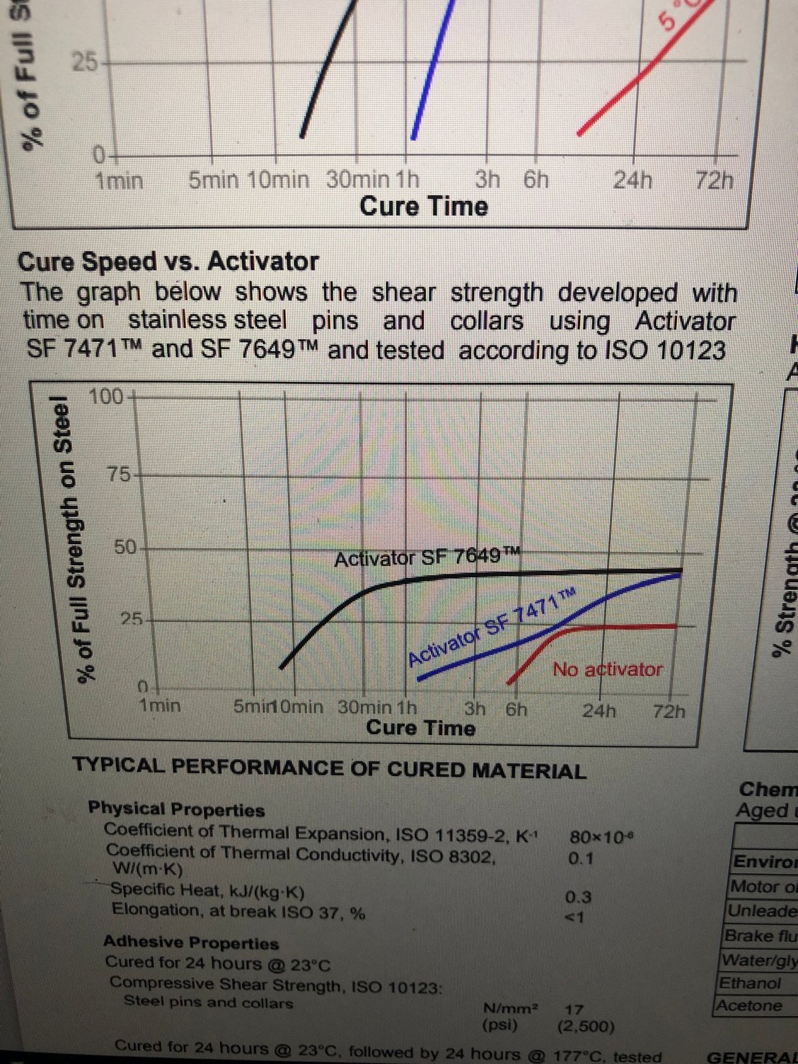

For anyone that decides to use Loctite 7649 as a cleaner for prep, it will accelerate the curing of the 620 retaining compound. According to the graph on the technical data sheet for 620, it will begin to cure around 8 minutes versus around 5 hours without.
That is a really good idea. When I read it, I thought "why didn't I do that or think of that" for when I removed the coolant plugs.
Thanks for adding the picture too.
