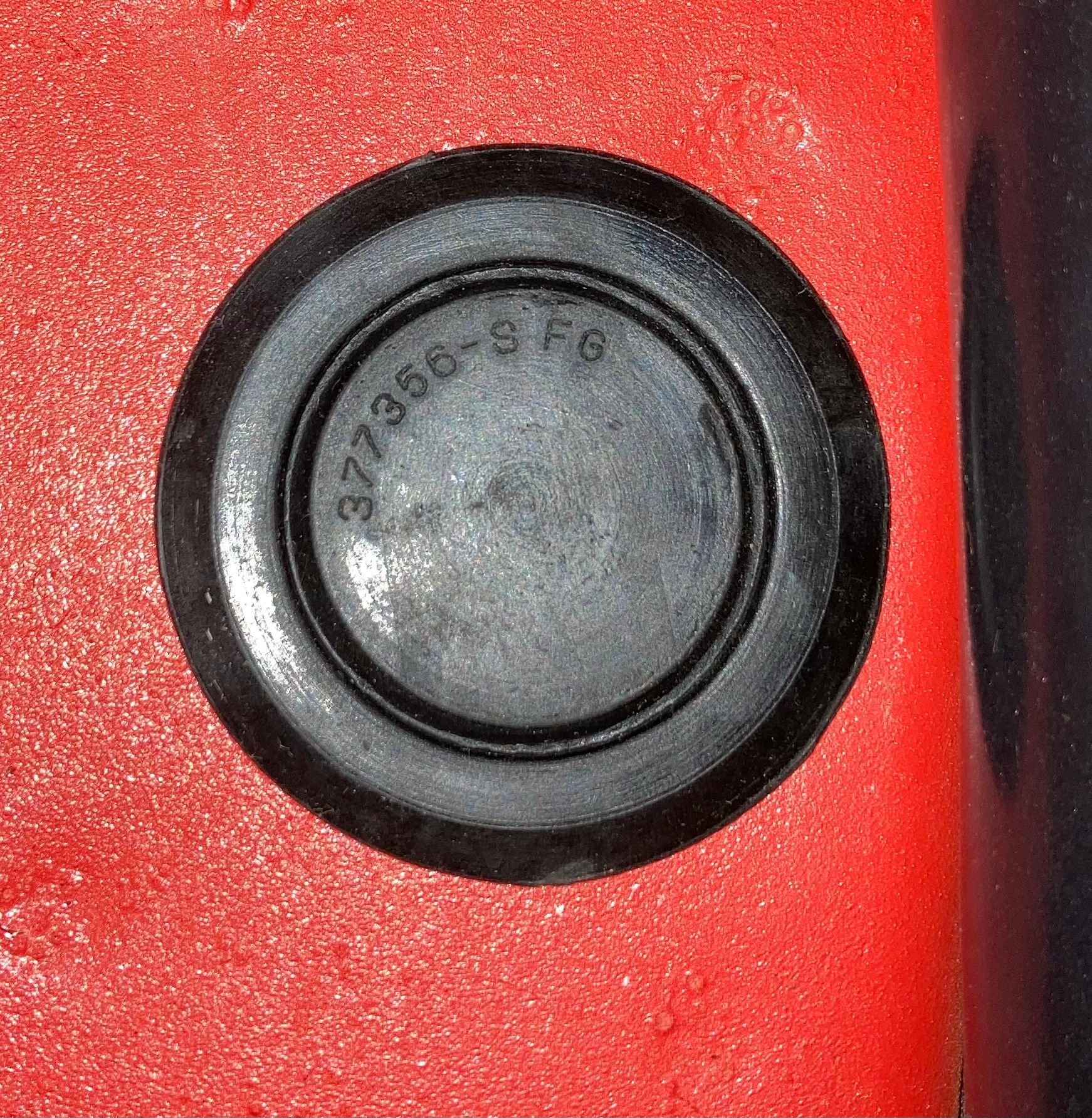

I spent a fair amount of time looking for these and it was only when I quit looking that I found them… Information worthy of sharing.

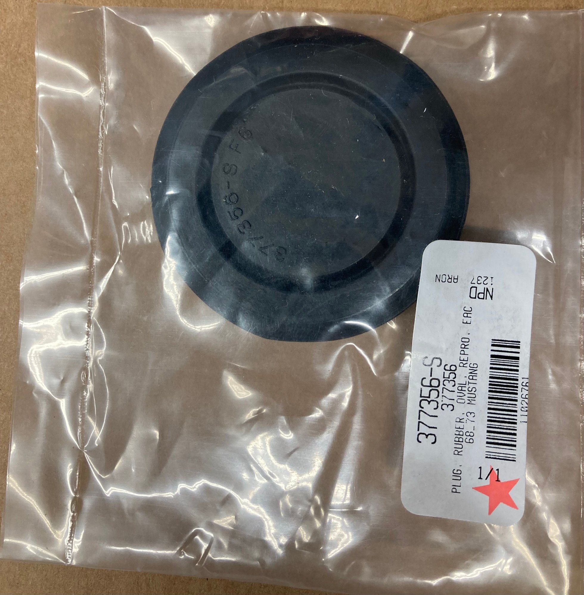

73-79 cab mount hole plugs. 1-3/4” diameter.
part number: 377356-S
made by Dennis Carpenter. Not listed under trucks. It’s in the mustang catalog.
when I searched the part number, the only place I was familiar with that sold them is NPD; again under mustang catalog.
they fit perfectly. There are a few similarly sized holes behind the dash. I hope this helps someone.

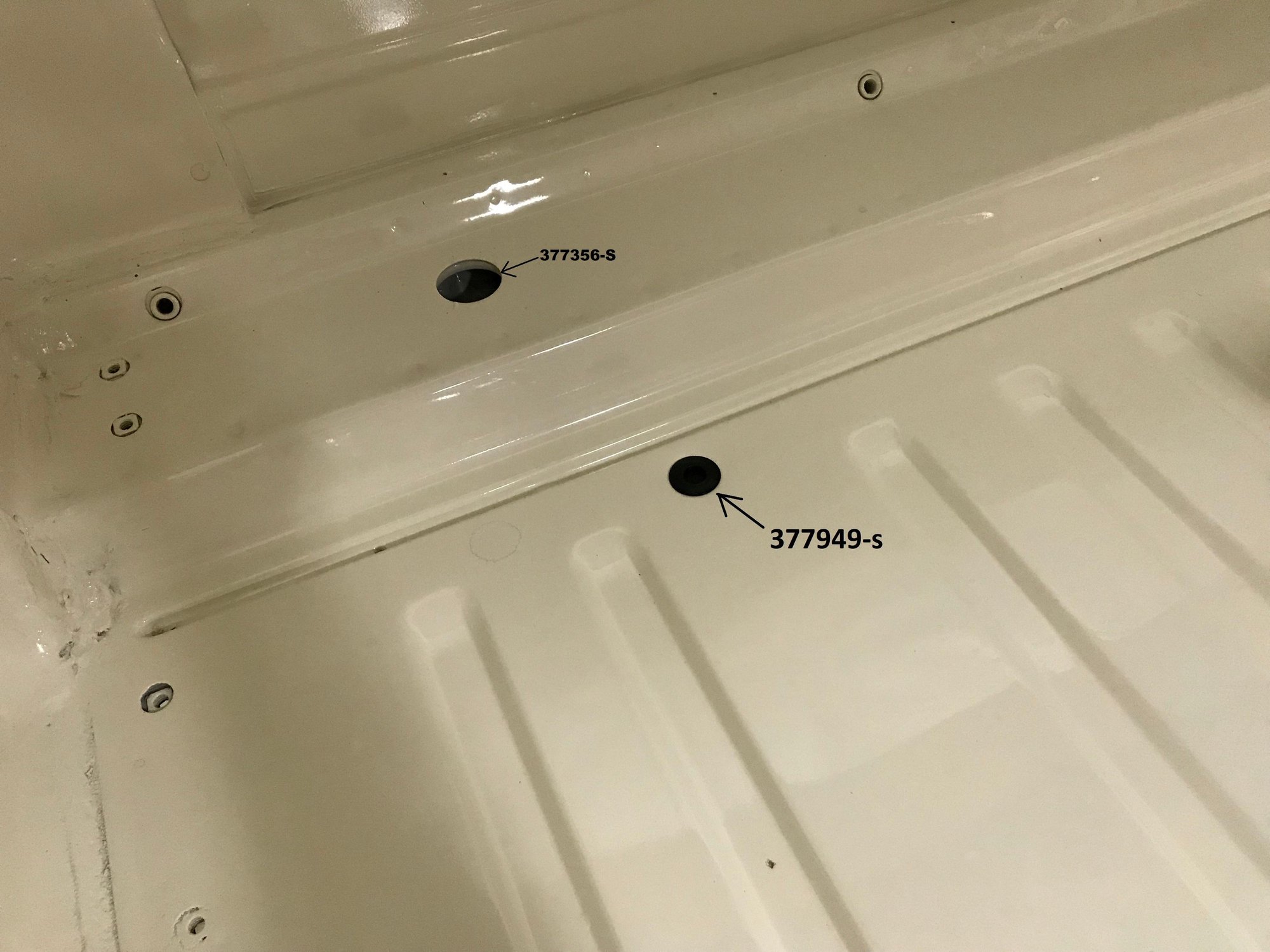

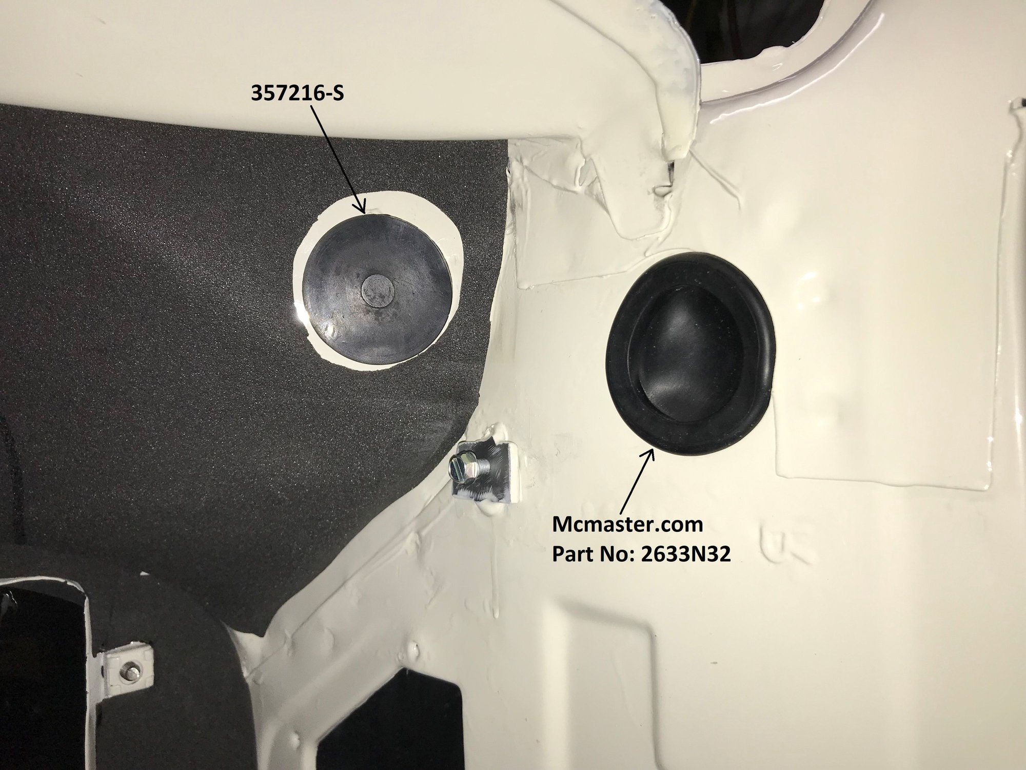

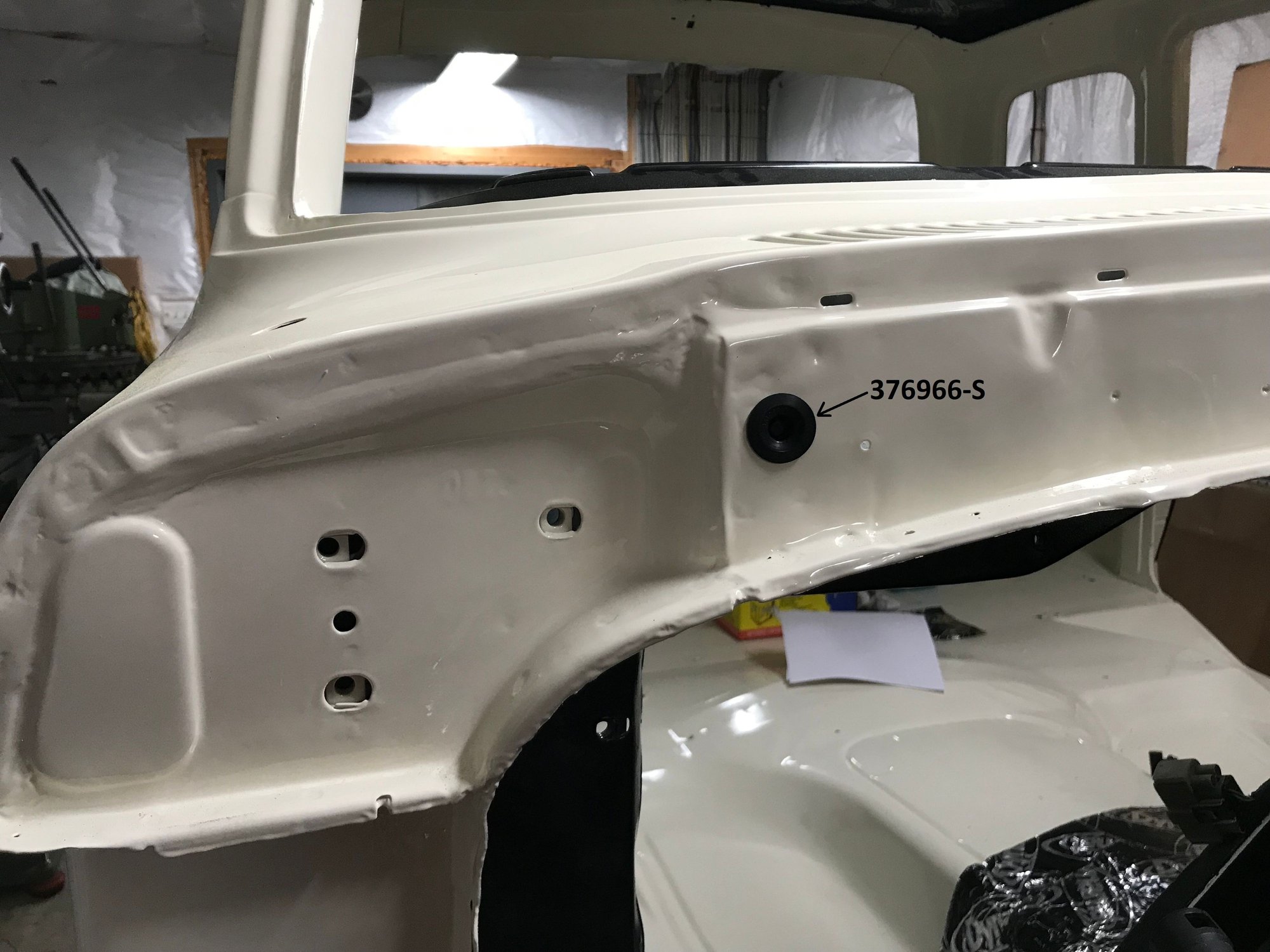

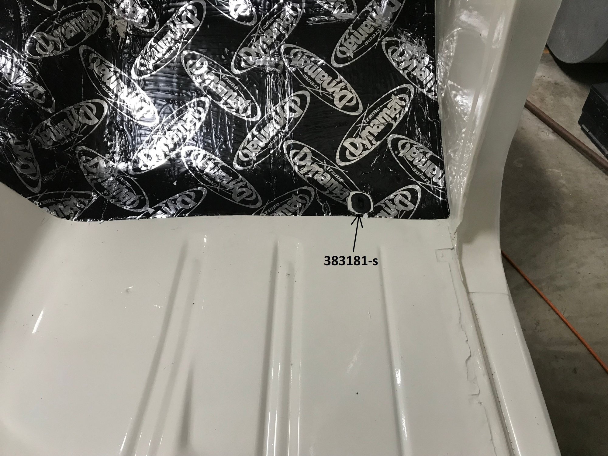

This is helpful. I just added that part number to my list (added to a picture where it's not shown). There should be (maybe there is) a thread that covers all the body plugs for our trucks. I bought a universal kit a while back when I started putting my supercab back together and I found maybe two out of the thirty plugs in the kit were useful. It took a while of measuring holes and researching the sizes of these plugs to find the part numbers that work best. It would be great to have a list of all the part numbers and their location since all can be bought individually. Here's what I've come up with so far.

Yeah I was thinking a list or catalog of Ford plugs by hole size would be useful so at least someone could measure and determine what they needed. Knowing a newer application is also helpful so you can snag some while at the junkyard.
