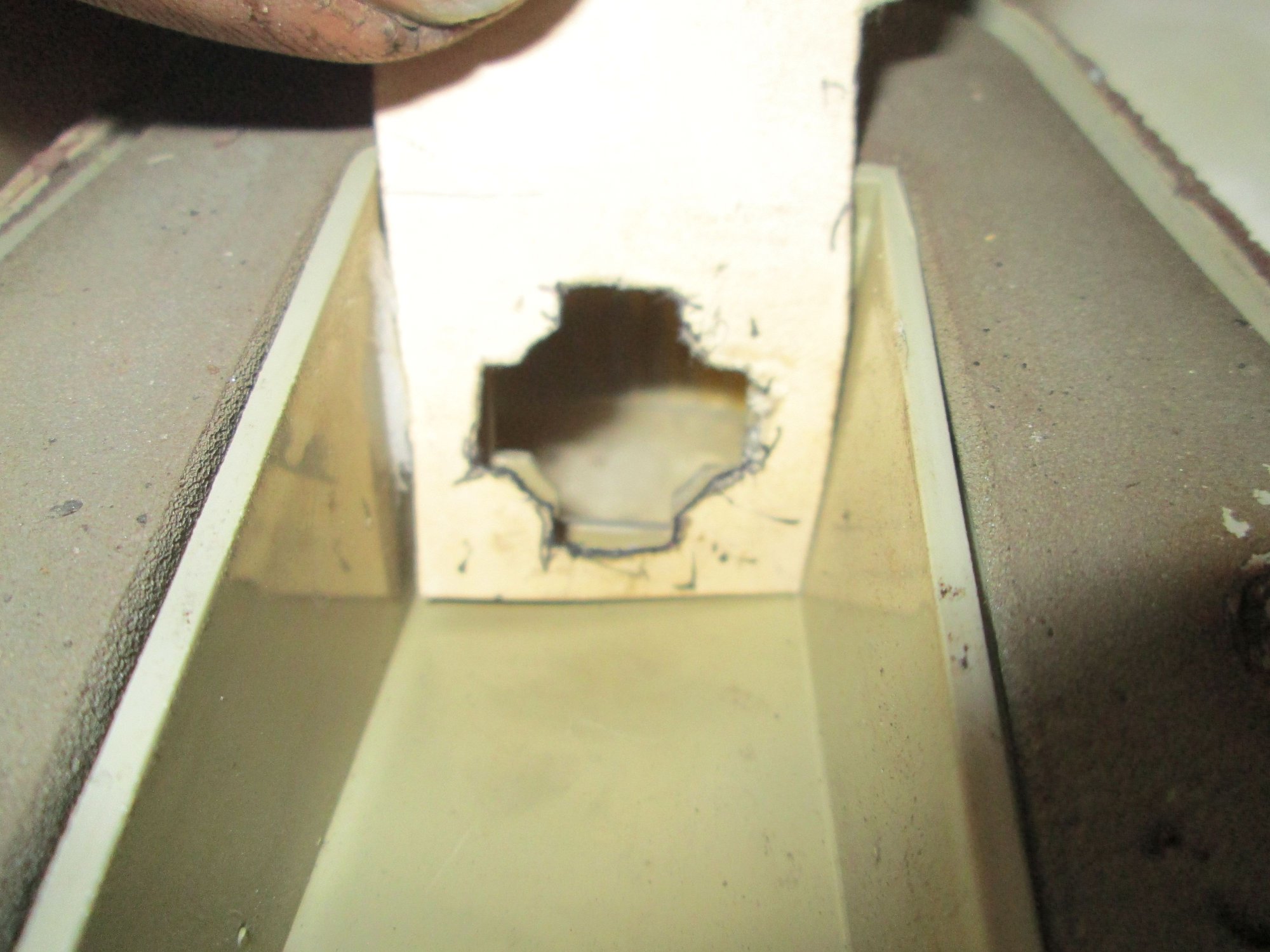

I had to fine tune the openings as the new lights are different.....
Above......New lights on left...factory on right. Note the difference in size/shape of the light guzintas.
Above.....Make a template from the factory light opening.
Above......Template of factory cab light holder-onner
Above....Trace factory cab light template onto the aftermarket opening. I used a small file to fine tune the opening....little at a time, trial and file.

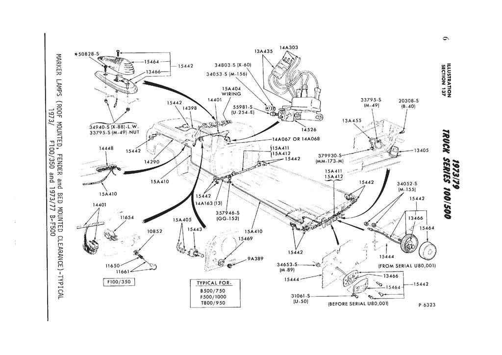

Anyone know how many cab lights they put on from the factory? I cant remember if my truck had 5 or 7??
Old Jan 9, 2022 | 09:03 AM
mikeo0o0o0's Avatar
mikeo0o0o0
Joined: Apr 2009
Posts: 14,333
Likes: 247
From: Stanley, VA
The parts catalog shows five.
Old Jan 9, 2022 | 09:30 AM
77&79F250's Avatar
77&79F250
Moderator & parts slinger
Posts: 50,286
Likes: 5,826
5 is the correct answer.
