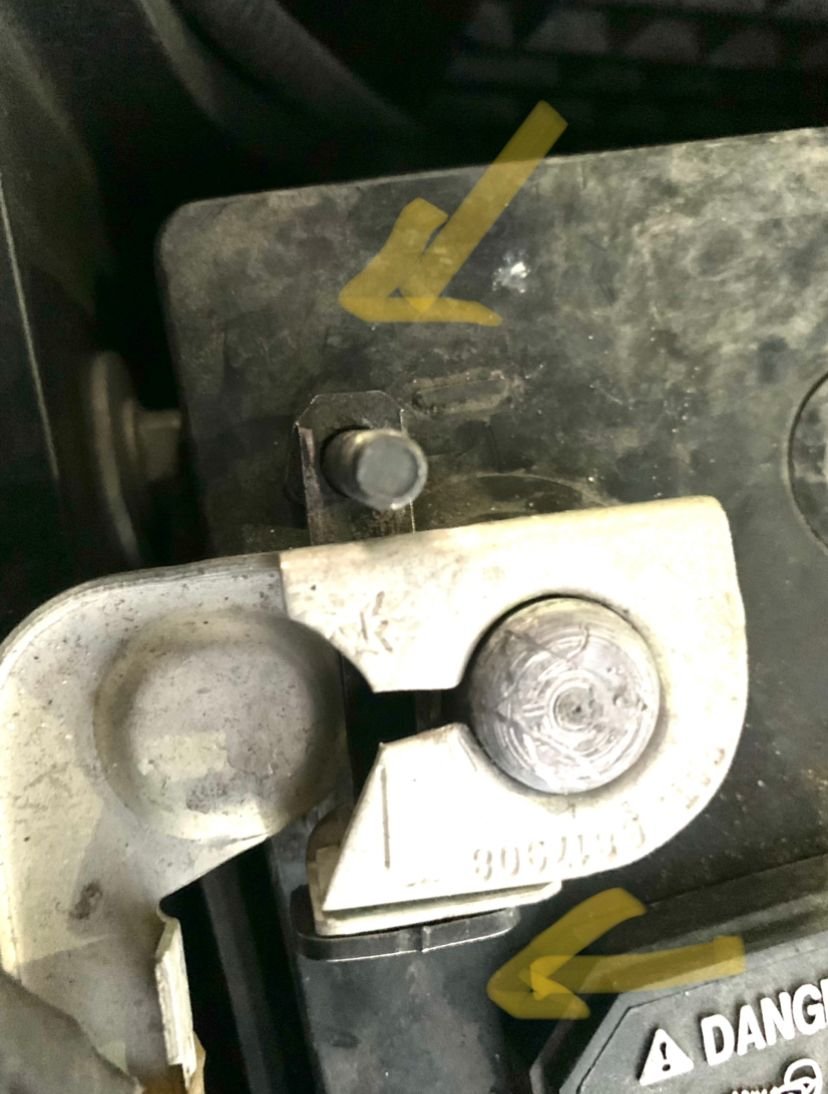

This is going to seem like a super basic question - but how the heck do I disconnect the batteries? Its like they have a lock on them or something. Loosen off the screws and they wont budge at all. There is a black bar that looks like it is locking the cables in place. Man I feel like an idiot
What in the h*ll am I missing here?
NEVERMIND - took about 15 mins of prying with a screwdriver and hammer to get it to pop.

Just lift it off, probably a little stuck on the post.

gently tap the bar that had the nut on it. to make sure its loose then open up the jaw a bit and boom she will come off
