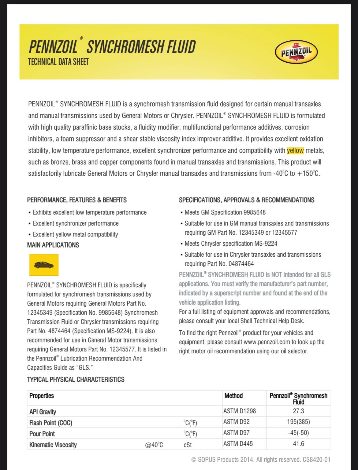

WARNING:
All modern gear oil available today in local retail outlets is GL-5 grade. GL-5 grade gear oil contains sulphur compounds that attack brass and bronze.

Pennzoil synchromesh. My 83 Jeep T5 and current Np435 highboy love it. Smooth.
It is available off the shelf and yellow metal safe.
One more vote for this! Made my old T19 shift super easy at low temperatures (below freezing), my current ZF5 loves it too.

Follow that link to see several other readily available sources for the (hopefully) correct lubricant, and some important details about GL-4 versus GL-5 oil for an older design manual transmission. There's lots of misinformation out there, so be careful about what you read. Basically, don't use GL-5 in place of GL-4 because it can cause accelerated wear of the brass synchro rings. GL-5 doesn't exactly attack brass. The link above explains what actually happens. However, the Pennzoil Synchromesh Fluid mentioned earlier says it's compatible with yellow metals, so in theory it should be okay. Myself? I'm not sure I'd want to risk it, especially when the stuff originally specified can be easily found if you know where to look.
