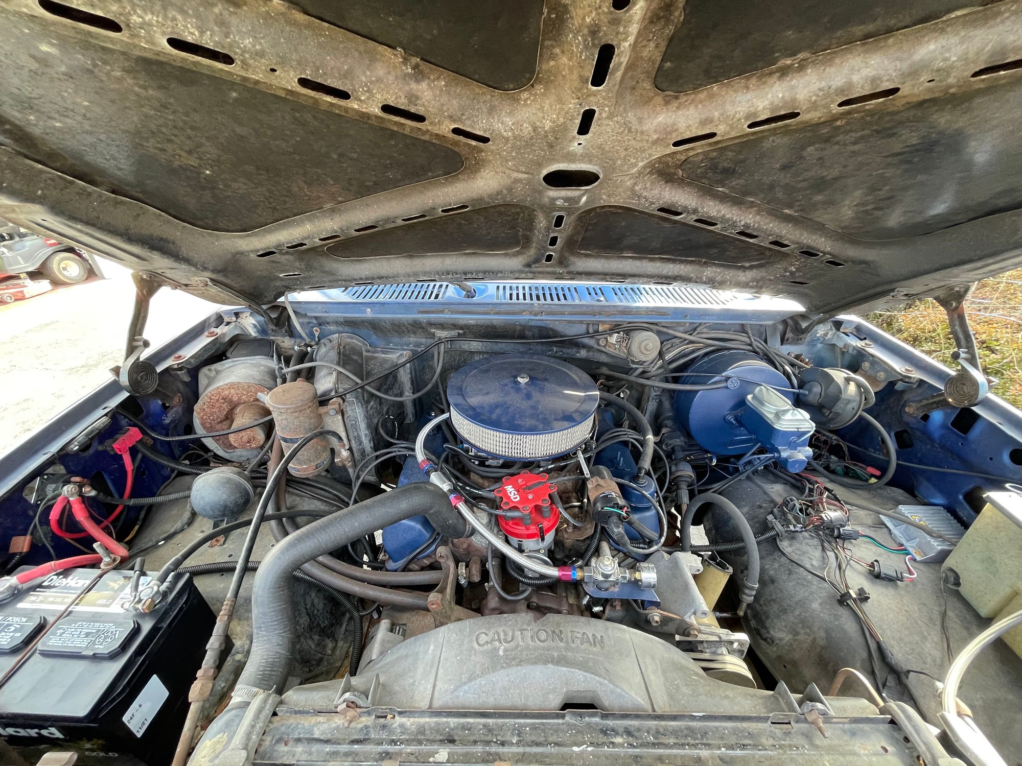

Just noticed another possible clue in this picture, that might help explain the random nature of the problem. You're running an open air filter, with no heat stove to help prevent ice accumulation in the carb throat. 30-50F is prime weather for icing. The last time the engine behaved, was the weather outside that temperature range?

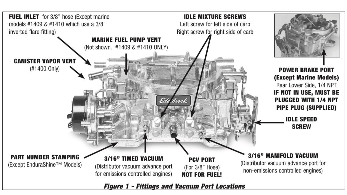

Above is a diagram of the carb. Note the timed vacuum port and the manifold vacuum port.

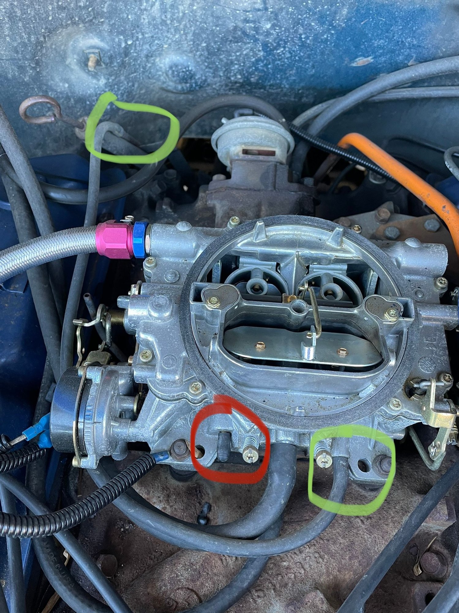

Above is 2 pictures showing the timed vacuum port plugged (RED) and the manifold vacuum hose (YELLOW) running to a metal port in the back passenger side of the engine near firewall down to the transmission.

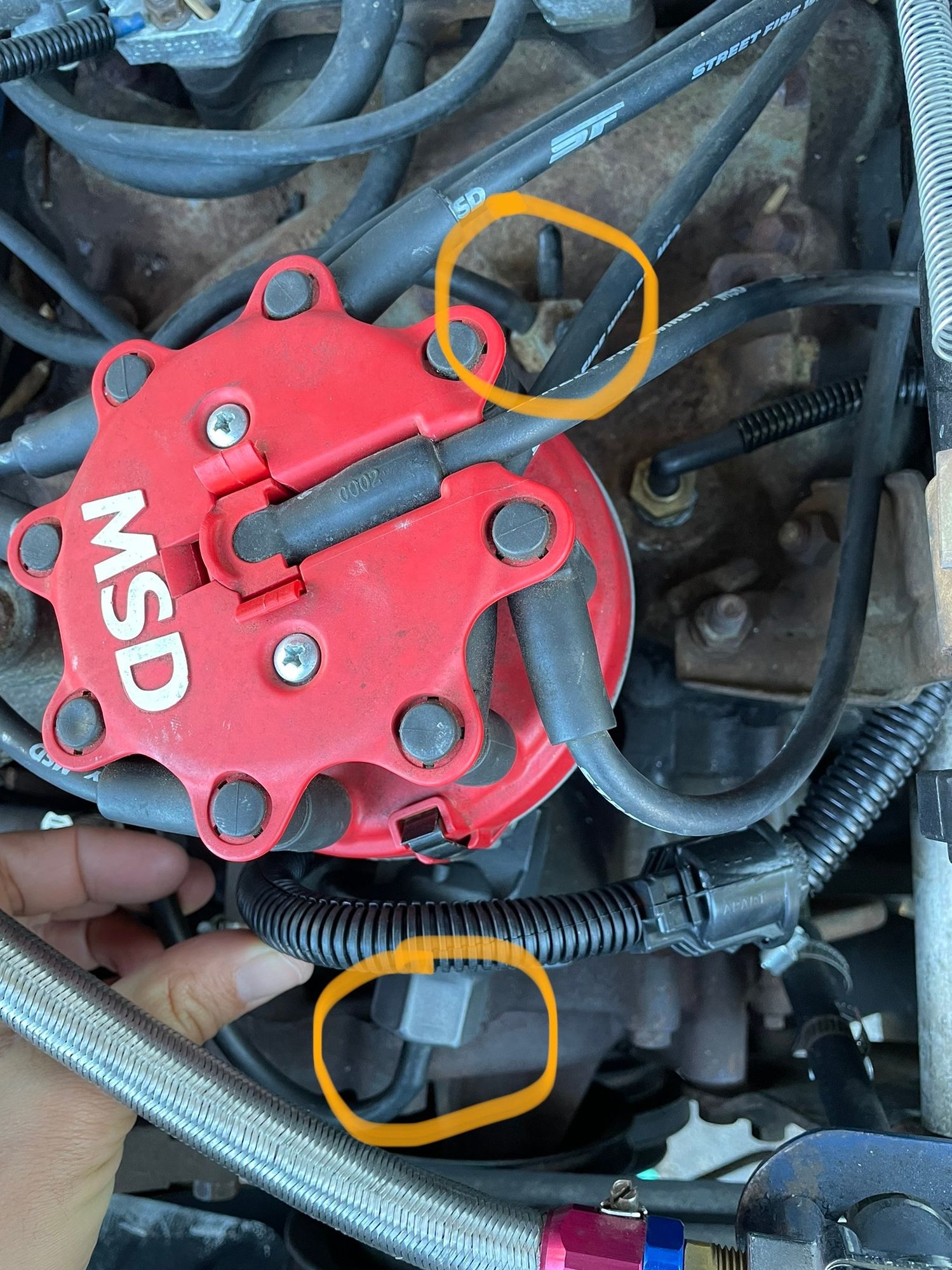

Next, above you will see the vacuum port on the distributor runs to a port on the intake manifold (ORANGE).

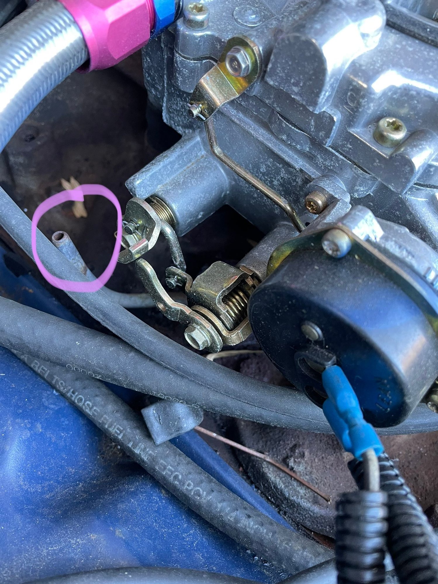

Lastly, you see an unplugged metal port (PINK) that goes into the intake manifold on the passenger side. Just under the electric choke of the carb. I can’t believe I’ve never noticed this before!!
Now I’m not very knowledgeable with this stuff but this doesn’t seem right at all. The only thing that does seem right is that PVC port which does go to the PVC valve on passenger side valve cover. I think I’ve got some mixed and matched vacuum hoses! Thoughts?!!
