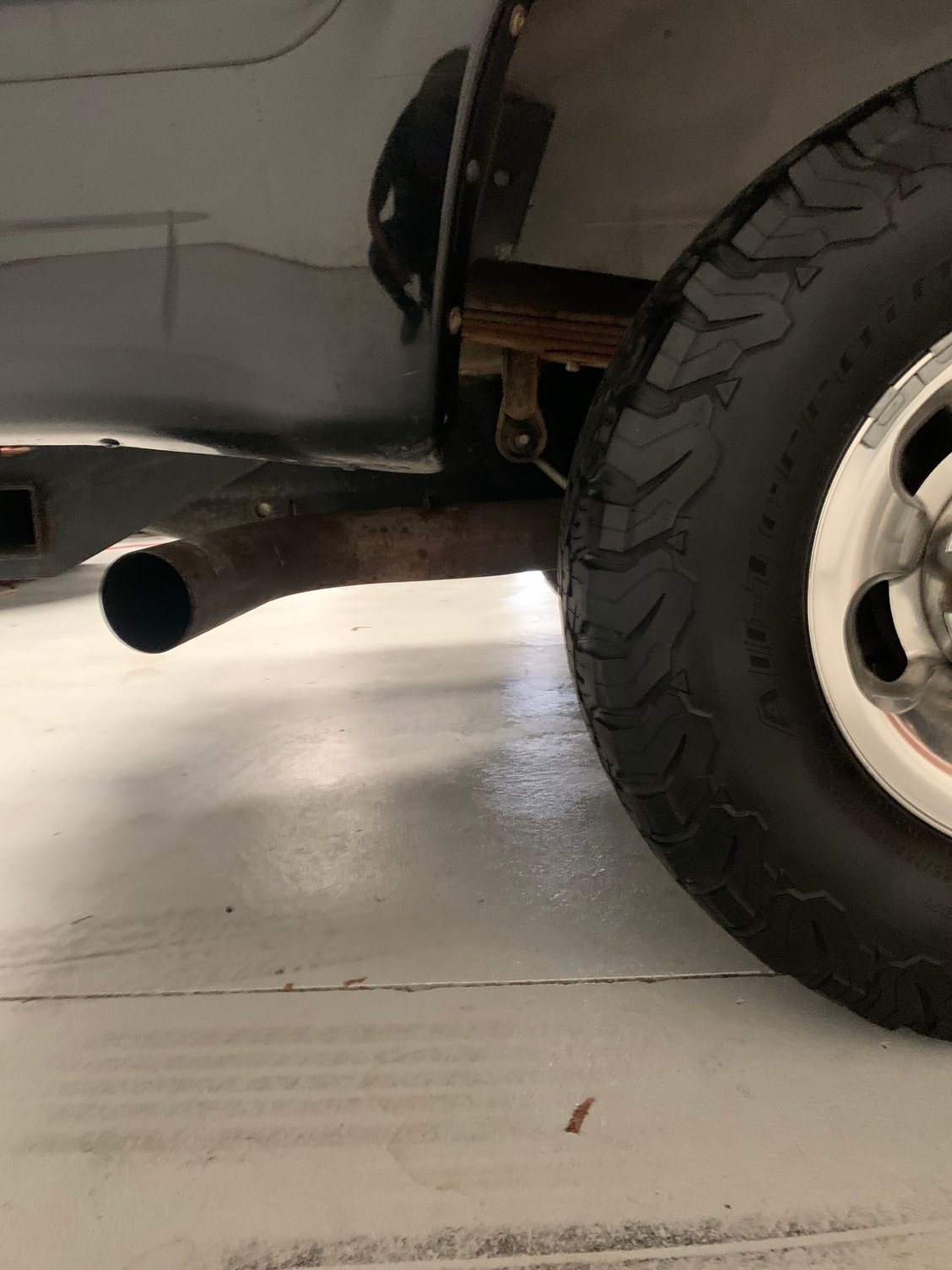

I scheduled a private inspection (which dealer agreed to) and he sent me these photos. It’s a 2005, 6.0, with 160k miles.
Is the rust concerning? The dealer wants me to deposit “hold money” for inspection which I’m fine with if rust isn’t an issue. Thank you for y’all help!

from what i can see in the pics at least, it looks like surface rust which isnt a big deal, but i am not a rust expert, im sure someone else who is will chime in, where is the truck, and where has it been? Is it from a salt state?

Have the dealer send pictures of the common rust areas. Rockers, inner rockers, second row lower C pillar (dogleg area), top of wheel well arches, inside lower rear quarters, all 4 door bottoms and inside front fender lower corners by the front doors. It’s a Limited, so that plastic cladding can hide a fair amount of rust from the casual observer, you need to search around under and behind the plastics to look for rust.
Are you well versed in the 6.0 PSD and it’s known issues and proper care and feeding?
The rear diff cover has a pretty good amount of moisture on it, could be a rust pin hole or maybe even brake fluid, with the frame surface rust shown the brake lines could be suspect.

The rust shown in the pictures is not concerning.
When evaluating an excursion look for rust on the rocker panels.
Also look for rust behind the rear wheel wells on the floor.
(Pull up the rear carpet to look)
Rocker panel rust is very concerning.
